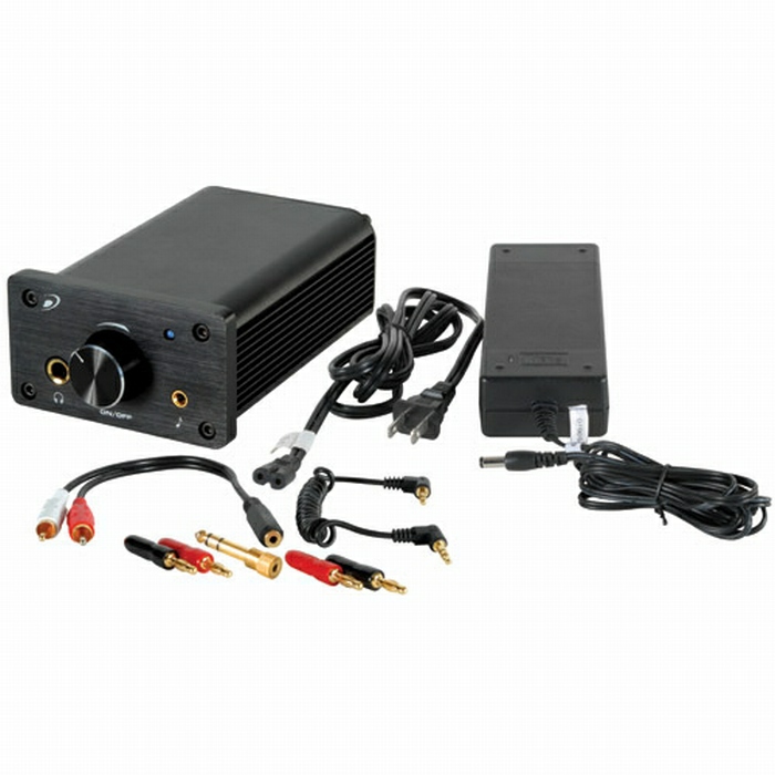

Dayton TK2050 amp
These new Dayton TK2050 amps might be pretty cool.
Parts-Express.com
ayton DTA-100 Class-T Digital Amplifer 50 WPC | dta-100 dayton audio dayton dta100 Dayton audio t amp t-amplifier t-amp t amp t amplifier class t amplifier class-t amplifier class t tripath tri-path tri path tripath amplifier ster
Parts-Express.com
