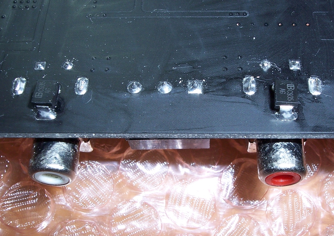

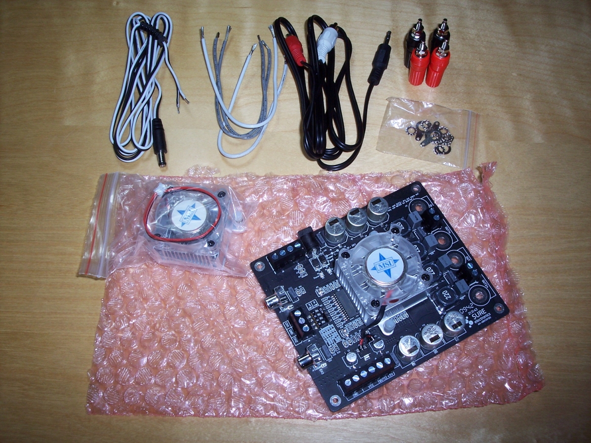

I have just received my 2050 amp there seem to be a couple of changes, one the amp came with an extra 12v fan and the whole heatsink appears to be attached via a pair of clips instead of glued, so easy to swap the fan out for the 12v and run it on a 12 v battery or a low volt ext supply.
Also underneath the board across from the input to the GND is a pair of what look like large caps?
The markings are U943 with AG underneath, I don't recall this being mentioned on any posts but maybe I just missed it.
Any ideas?
I have received my board just yesterday, it is equipped with a MSI chipset cooler and underneath three are two component marked C935 AG, I believe that are bidirecional transient suppressors, a sort of zener mounted to protect the input.
I don't remember if theese components were assembled in the previus version of this board.

I think they're diodes. This is the first one I've had, so I never saw the old version of the board. I'd be surprised to find out that they're big capacitors of any kind. I find it interesting that SURE seems to pay attention to this board. They added the fan to the heatsink, then ran the fan at 5 volts. I think both ideas came up in this thread.
I looked back at the early post on this thread and it seems they are some sort of supressor though the numbers are now different, anyhow I will be removing them.

Theese suppressors adds a parasitic capacitance to the input, I have not find any datasheets about them so I don't know the right value but I think that the best way is remove them.

I have my first board up and running as a test mule.
So far I have added new input caps (foil) and left the small caps in parallel, removed the other input caps and resistors and those odd devices across the inputs and removed the 2 main diodes on the power input.
The amp is running on 26V battery power using large SLAs.
The sound for the first 5 mins was terrible but it soon smoothed out (funny characteristic that) it is burning in nicely and has 6 hrs or so up and frankly sounds mighty fine even now. It runs very cool, I cannot detect any heat on the heatsink, but then I am certainly not pushing it hard either, currently just of my iPods dock outlet.
At this point I would have to say it is the best bang for buck amp I have ever heard.
I am planning to add air core inductors and lay them down parallel with the board and place them in copper tubing with a good air gap to fully shield them.
I think I might place tank caps right at the chips on the bottom of the board, probably 1000 uf pannys with 2200 uf outboard in place of the current tank caps, I will probably put small tant caps across the 1000 uf caps as well.
Separate 5V supply for the fan from its own reg etc fed by a separate battery, this will feed all the fans as there will be 4 2050 boards plus 2 2024 in total to feed a pair of 6 Driver OBs that I have had running on gainclones for the last 18 months or so.
Largish value cap across the batteries to kill residual noise, I will need to test for the optimum.
Change the resistors needed to match the power supply.
Place a pair of copper clad shield boards above and below the current one earthed to the ground point on the amp board,
So does anyone have further suggestions that are likely to give a real improvement or warnings for my intended pathway.
