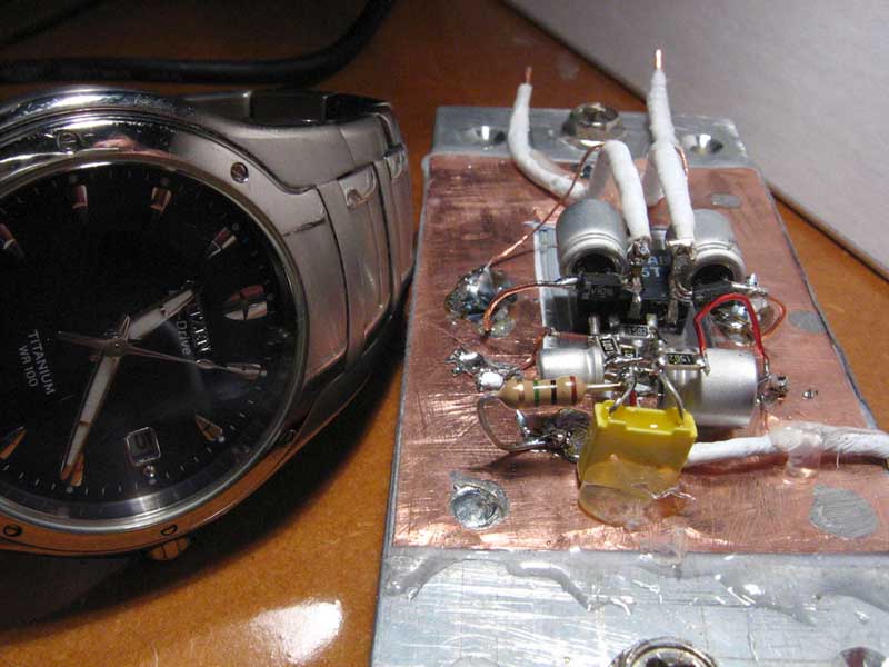

For example the by far the best sounding gainclones I have built are very small with ultra short circuit paths, meticulous star pointing and shielding, the choice of actual parts was far less important in the end than the construction method. A pic is attached of the micro clone built around an LM1875 chip runs on 12 or 24V dual rail and has 3200uf caps just off the board not shown the whole thing fits in a copper coffin just a little bigger than the circuit itself. It runs dead cool even on 24v despite running a gain of only 16. These modules are actually my benchmark, up until this 2050 amp nothing has come close for detail, resolution and soundstage, they basically sound like really nice tube amps but it is all changing now!
There are probably a myriad of small issues with these boards and I am still trying to come to grips with them but I learn every day.

Hey V bro.. now this inductor thing is interesting, on a mildy related issue I found that the sound of the amp was substantially different when I changed the speaker cables out from straight figure 8 thin cable to cat 5 twisted cables (3 cat 5 cables per length). I noticed the resolution was better by a fair margin and the chip seems to run pretty much without any heat at all, certainly I can't feel any heat at the heatsink.
It had some heat with the small figure 8s and I thought the change was just due to burn in but maybe not.
No other amp I have ever used has seemed quite so responsive to a cable change of this type. mmmmm, got me thinking now.

I wouldn't give the Sure that much credit, what you experience is always the good chipset. Making changes to a load changes almost any amplifier's performance, that's got nothing to do with inherntly low colouration. Class T is inherently sensitive to the load and the output filter should be tailored to the load quite well to keep it linear in the audio band. This is one slight down side to these amps.
Yes the inductors change the current draw and usually low current draw is a good sign I would think. I only have real life experience and just some unproven ideas about what is the reason. The first time I saw this phenomenon I was quite surprised too, I saw the idle current drop 35% on an amplifier just by changing the inductors!!
The fact many people overlook who are familiar with conventional amplifiers is that a class D amplifier ALWAYS switches. Due to this the temperature the switching devices are showing is not so much related to the load and in-band output level. Actually with class T the swithing frequency is also variable and lowest at idle and I have tested amps that ran cooler at max output than at idle! It's pretty much reverse psychology...
So, this switching wave form is always there, even when it is all silent in the room, the output filter is permanently filtering this energy, that's how it happens.
