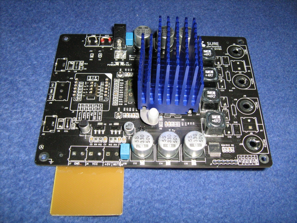

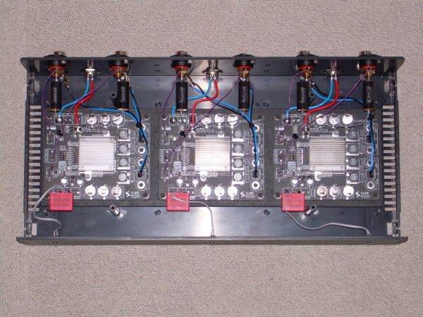

Hi Scott,
This is the picture of the modifications I have done so far.
Output filter caps are placed underneath.
I have measured the dc offset as follows:
gain setting off: L 29mV, R 57mV
gain setting medium: L 21V, R 22V
gain setting high: L 24V, R 24V.

R23, R?
Hi Scott,
This is the picture of the modifications I have done.
You just need to remove R23/ R? pair (I don't have the new version schematic) whenever you jump the input cap. They are the resistors next to the removed input caps. They look like they are after the cap in the input flow but they are actually isolated from the amp by the caps. They serve as input termination to ground and are the first thing the input encounters, along with the removed over level protection zeners. With the caps jumped, the 2.5v bias of the input section is now shorted through the resistors. They serve mainly to keep the amp quiet whenever it is on with no input connected. You can add them back in, in front of your new caps as a resistor or a pot or install your new caps in the stock pads or run without them but most sources sound best with a true 20-100K load to work into.

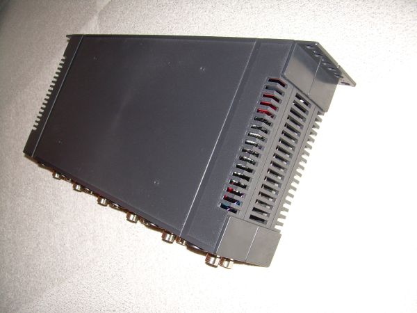

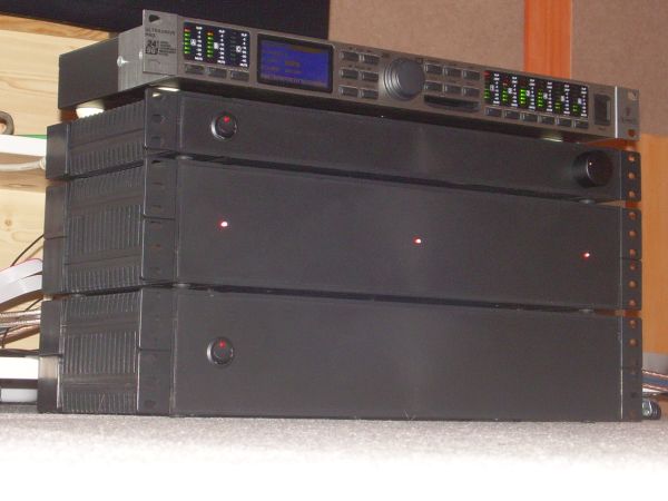

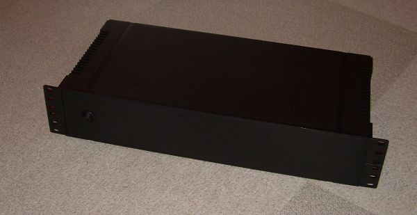

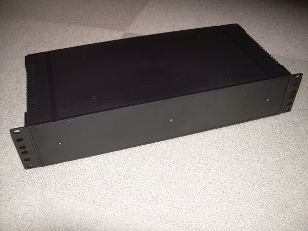

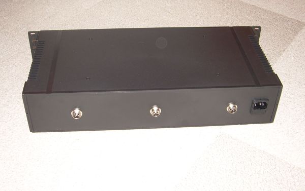

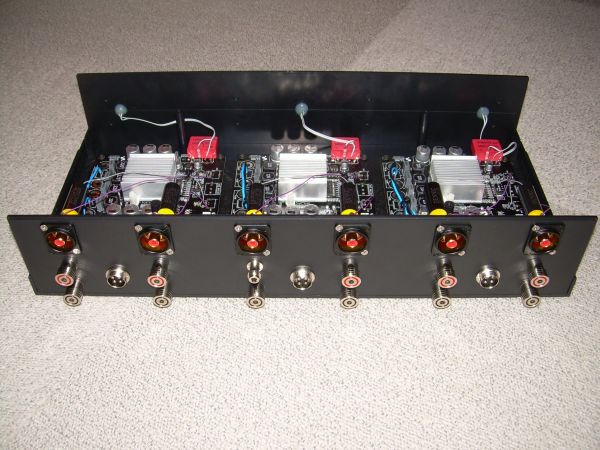

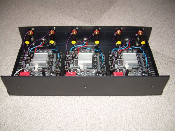

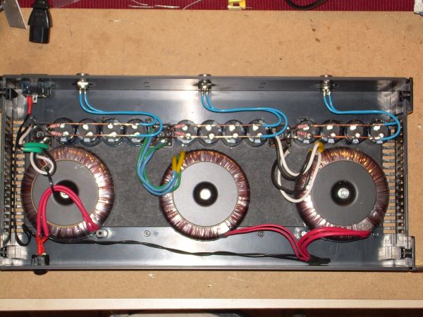

Here some pictures about my 6 channels SURE TK2050 D amp.
The amp and the psu are in separate box.
The fan was removed, the biger heatsinks are coming. The imput caps and resistors and supressors, and the diode in the psu line was removed. The input caps are 2,2uF Bennic XPP.
Pictures about inside of the amp:

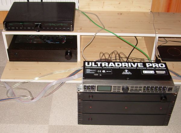

In my system:
- Slim Devices Transporter
- Modded Behringer DCX2496 active DSP loudspeaker manager
- 6 channel analogue volume controller with 6ch ALPS motorized and remoted pot
- Six ch Sure D amp
- Tha amp PSU
