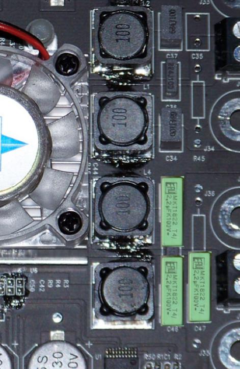

hi, this is my completed assembly:
Dr_Vega, OK I'll be carefull if I reroute PS lines! As for the sound, hélas if you have a close look at my board's pic you'll see I've played with gain. And defo no sound in any case :'( BTW, on a singing board it's handy that one can bypass the SMD resistors and try his own favorite resistors via the tulip Vin & Vout! And also do a fine gain adjustement.
Scott, I've read more and yes found that these low value coil don't call for the Zobel.
Simple is better for me, will play with Zobel if I need it later. I guess these caps are MKS/MKT, wonder if some MKP can do and fit!... or things like PPS...
Thanks,
Matthieu

Also, the manual is for the first version of the amp, so the layout and schematics do not necessarily match your board.
they seems to match. Don't mind the V1.0 on the file's name, it's V1 of this new amp, not the older amp wich had a V1.2 manual.
As for the IC you'll read that it's the fan's controller.
Is it now worth to change that set-up for a passive cooling? Avoid a noisy IC by removing R1/R2?
Dreaming on the pdf until I get a working board...

Where did you get the updated manual? Parts Express still has the manual for the first version (AA-AB013). It'd be great to get it and update the instructions for the updates on this thread.

Thanks for the link Malefoda. It worked for me too. I'll send Parts Express a message where to update their manual.
I haven't tried to modify the new board, yet and haven't looked at it closely, I just installed it and am listening to it.
On the older board, those caps had through holes in the board and I mounted big caps under the board. Don't know if the new board is through hole or surface mount.
