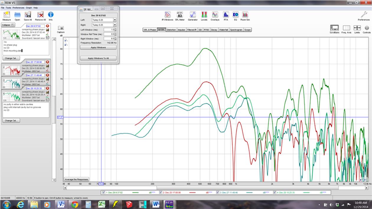

Here is a collage of REW measurements comparing results with and without phase/volume plug. I've been a little disorganized and I'm trying to fix that but this is the best I have at this time. These are all taken at different times and volumes so absolute SPL is meaningless.
Green (at top) is with no phase plug and no CD. Only problem is the lack of bandwidth. I don't understand why it falls off so soon but that clearly isn't an eigenmode problem.
Red (next one down) is with a truncated cone volume plug with the holes through the horn wall simply continued through the volume plug. The edge of the hole is at the edge of the base of the volume plug. The volume plug added the sharp null and made very little other difference. The null, I’m guessing, is a standing wave phenomenon.
The volume plug is a ¾” thick truncated cone; 5.5” dia on the bottom, 3.5” dia on the top; the bottom of the dust cap comes within 1/8" to 3/16" of it. I don't want/need more than 3mm of travel...
In the next measurements I took the CD off the back so as not to be confused by its reflection null. With the CD off, the apex's reflection null is high enough in frequency to not confuse the picture around 1 Khz.
Green, the next one down, is where I closed off the original holes in the volume plug, hollowed it out somewhat to create a duct to a new hole in the top of the truncated cone. This hole was 1 3/8” diameter (my largest forstner bit) and offset from center towards my horn wall holes to minimize duct length. I tried filling the excess volume in the “duct” with putty to make it more like a duct and less like a chamber and saw some low pass filtering as a result. That is probably worth another picture. In retrospect, HR says I should have made a larger hole.
Blue is another variant of the phase plug. I shaped grooves across the top towards the far side of the cone to try and minimize the distance that sound had to travel from that side. This is, I think a dead end.
I think its significant that in these last two configurations I still have the early SPL drop off but the phase/volume plug allows the SPL to come back up once the frequency gets past the null. That is probably just showing the lack of acoustic filtering. The plug has a volume of 195 cc. Cone traps 425 cc.
Well I just routed another phase plug blank but I think I'll wait for your thoughts before I do more than shape it to the cone.

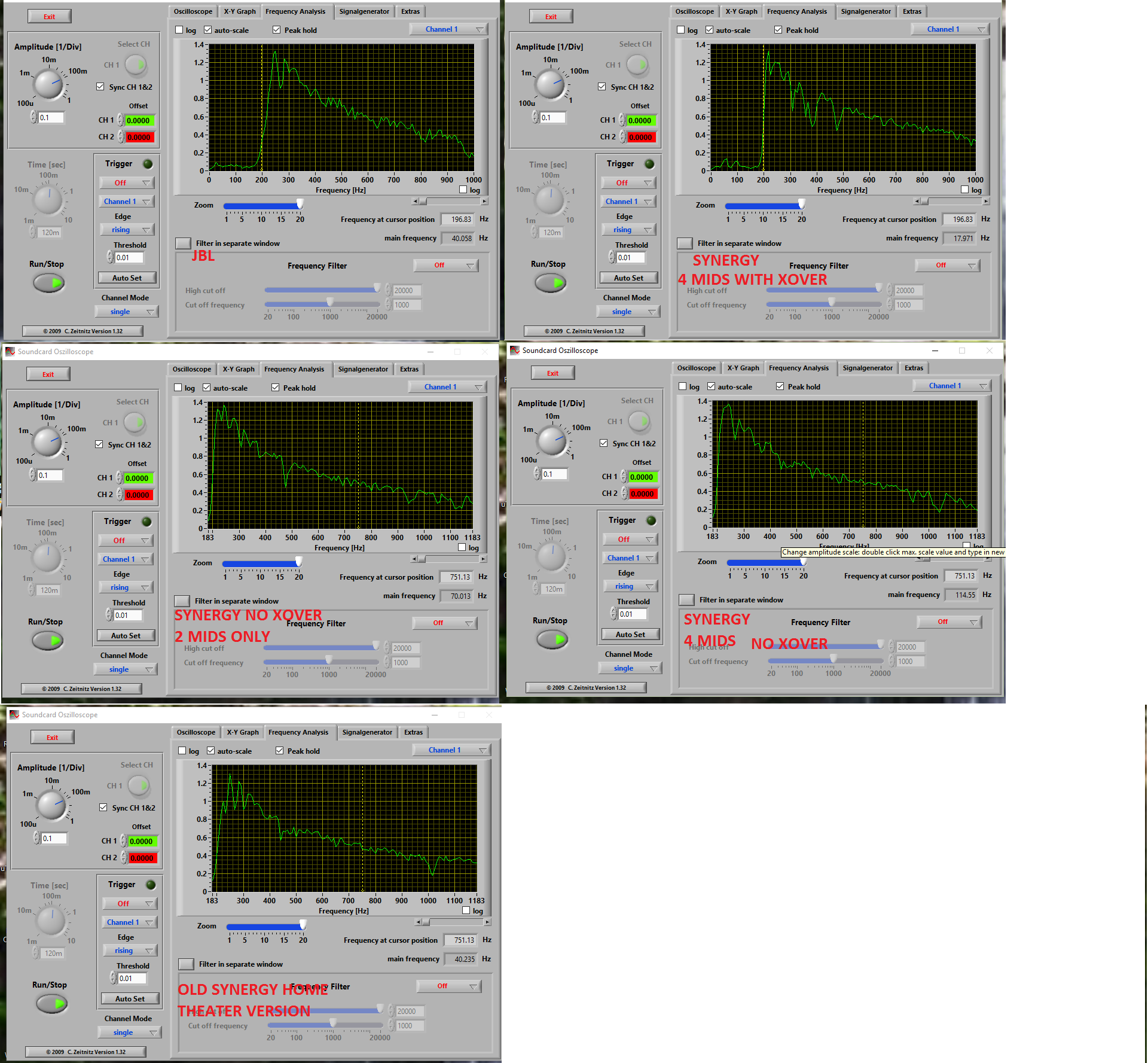

Hello to all.
Being a fan of Synergy conception I was following for it for 16 (?) years from Tom Danley Unity.
So I have build Bwaslo synergy, I also got PSE144 and my last experiments was Art Weltersys Tripp 10.
First of all I would like to say big thanks to all of you guys. With out of your support this thing will be impossible. So bellow it's a measurement of all of them. I tried PSE144 with and without xover with 2 and 4 mids. Tripp 10 I tried with 5-6 different drivers. The most interesting are B&C, JBL2123H and Isophon P170. For 6.5" Isophon I use only one port on each side and lot's of experiments with cone correction. I want to mids go up to 900hz. Finally on JBL with third variant of cone correction and 5-th for Isophon I got this:
Old Synergy - Bwaslo version.
Synergy -PSE144
The first graphic should be last.
