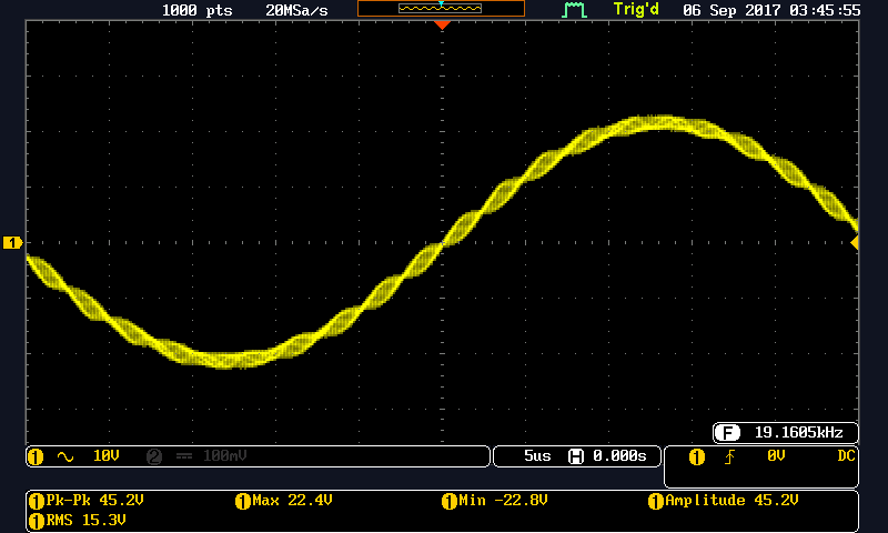

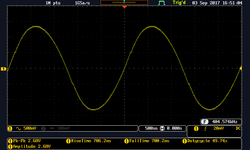

No, such large RF-ringing 'blibs' are not normal.Is this normal at the output of the amplifier?
Did you mod the design? Different layout? Adjustment of gatedrive & dead time?
Or is the scope probe connected with a long GND wire forming a loop partially over the switching stage?

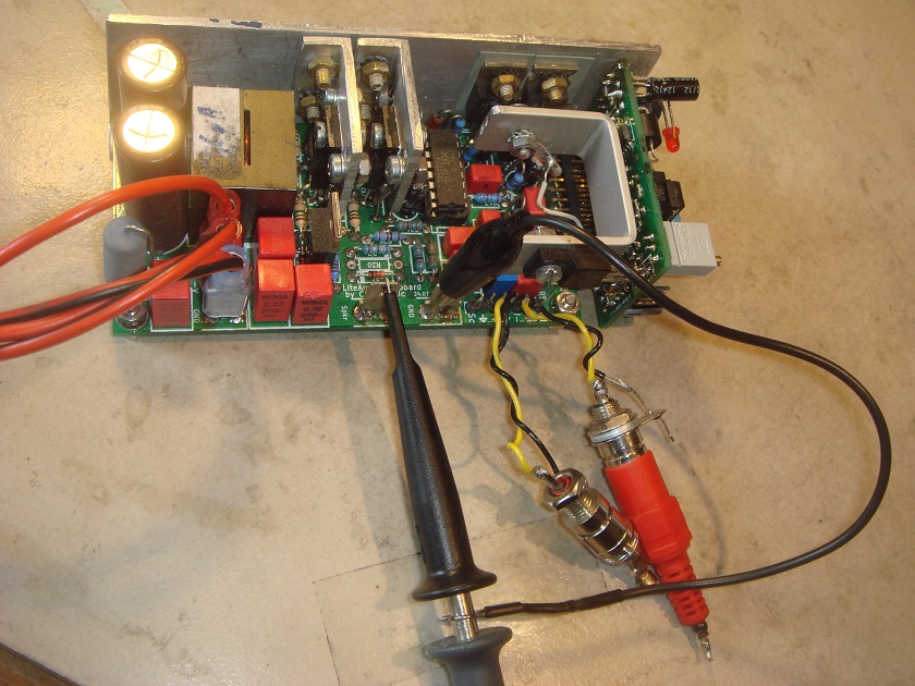

Nothing modified at all, same PCB, (Your PCB) scope GND is connected directly to the GND pin on the PCB.
For double checking I grabbed my old sample (+/-40V version) from my storage. Attached what I am getting.
Looks clean even when using the long GND clip in an ignorant way.
In your screen shot there is more which does not fit.
The frequency is high.
It is even above the max frequency of the +/-40V version, but at the same time the magnitude of the carrier looks more like a +/-80V version.
Could it be that some misplaced component in the area of the feedback or modulator is pushing your +/-80V version to higher frequencies?
If so then this could lead to such blips, because under this condition the ZVS during idle would be messed.

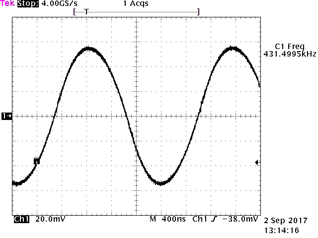

For your reference I am attaching my measurement:
Scope Tek TDS784C set to a sampling rate of 4Gs/s and full 1GHz bandwidth. Used probe was a 450MHz 1:10 probe (Elditest GE4512).
Scales of screen shot:
Time base: 400ns / Div.
White trace: Output voltage, 200mV/Div.

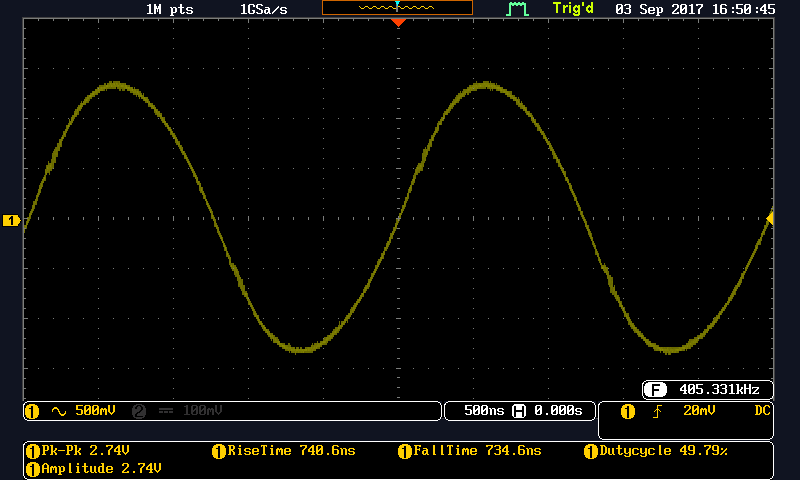

Hi Markus,

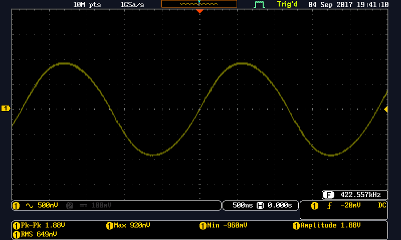

Due long inductor wires, that's why I had the problem, the inductor was made and wired quickly for testing purposes.
See below, Image with full 100MHz bandwidth DS0009, and Image with 20MHz bandwidth limit ON DS0010.
This is the +-40V Version, I am going to build the +-80V version next week.
Thanks.
Does it look better now?
Thanks.

From you screen shot I am guessing that you are working on a +/-80V version and most likely it is suffering from one or multiple wrong component values, which leads to a very high oscillation frequency of 456kHz, while the +/-80V is designed for roughly 260...310kHz.
The combination of 456kHz and carrier size in your screen shot indicates a wrong value in the output filter. Additional there might be wrong values in the modulator or feedback network.

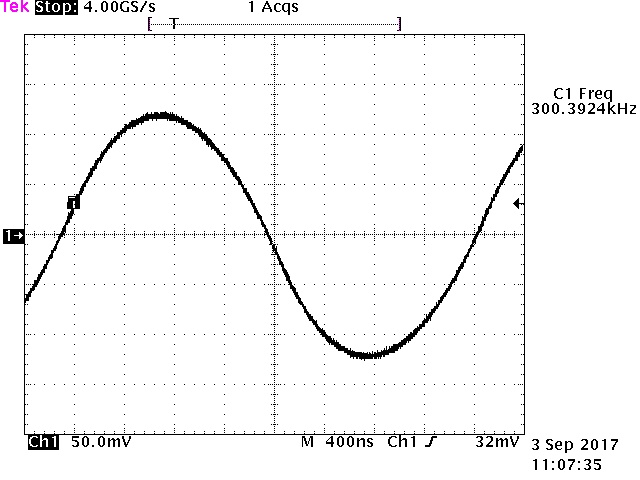

Here a screen shot how it should look, when everything is right.
... took this picture for double checking on my +/-80V sample today.
Scope: Tektronix TDS784C set to a sampling rate of 4GS/s and full 1GHz bandwidth.
Probe: 450MHz 1:10 probe (Elditest GE4512).
Signal trace: Output voltage, 500mV/Div.

So simply use my last post for reference for the +/-80V type.

When adjusted to 400kHz, the typical Pk-Pk size of the carrier residual at the output is 1.2Vpp..1.3Vpp. Your screen shot shows more than double of that, which would indicate still a wrong component value in the output filter.

Yes, this is looking much betterDue long inductor wires..
...Does it look better now?

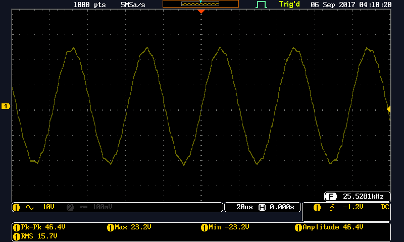

Shape is perfect.
Also size is coming closer, but it still deviates by factor 1.6 vs. the expected size.
When tuned to 423kHz and rails +/-40V and C24+C25+C26=0.77uF and L=15uH then the expected Pk-Pk size is 1.15Vpk-pk.
Your screen shot would fit to C24+C25+C26=0.44uF, i.e. when C26 would be missing or not soldered.

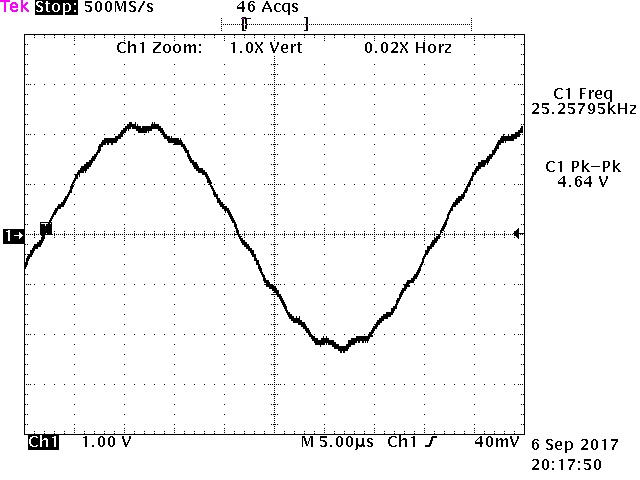

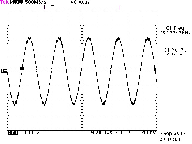

Some waves below.
..enjoy your amp..
Attached two screen shots with similar signal from my sample when operated from +/-39V without load.
Measurement with x10 probe ==> Vertical scale: 10V/Div.
