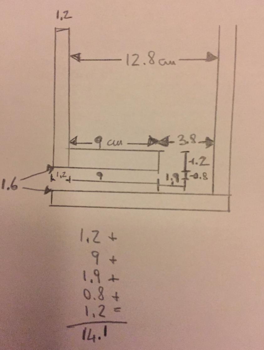

@kissabout2002 - Thanks, that looks correct, but now I am even more confused.
Great thing is - the TABAQs I've built to date sounds awesome!
lol....sorry again mate, at the end of the story if they sound awesome mission accomplish who care if few mm are missing....let's drink
![cheers :cheers: :cheers:](https://files.diyaudio.com/forums/images/smilies/cheers.gif)
until the Captain came and confused us all.
Don't blame the poor old Captain, you lot have had years to get this sorted!!
What about the folded with 14.4 width? What are the correct dimensions? Or is it correct?Hi Pugwash,
You are right I gone all over the history of this thread and realise the mistake, in few word what now is right is the TABAQ UPDATE 2 that is dated at the end of page 4 "March 3rd 2017", in this update you have two models the first with the shorter port and the second on page 4 the modification of the Tabaq Original, so the 790mm are the right one, here all the history on the forum so you can also check by yourself:
#1364 Robskillz point out the problem
#1366 Bjorn confirm the mistake
#1369 Ref.R2 is accepted as the right design
#1686 Bjorn reconfirm
#2018 Bjorn post the TABAQ UPDATE 2 drawing
Now as Luigiman suggest pick your driver and see then what is the most suitable Tabaq for it.......all the best
That would be great and the best idea. 1st post, updated pdfsBest would be if Bjorn updated his first post with all recomended plans.
As an general plan for 3" and 4".
The driver will work very fine in standard TABAQ design. Which has been reported by several builders![]()
You might reduce the stuffing from 100 gram to 80 gram. However, I would stick to the 100 gram

Thank you very much for this sim, it is much appreciated. Your post #2571 is also very relevant here. I wonder (before I go and update my dxf files, again) - would there still be any benefit in increasing the cross-sectional area a little? The bottom end of the sim looks pretty good to me, but I am no expert here?The driver will work very fine in standard TABAQ design. Which has been reported by several builders![]()
