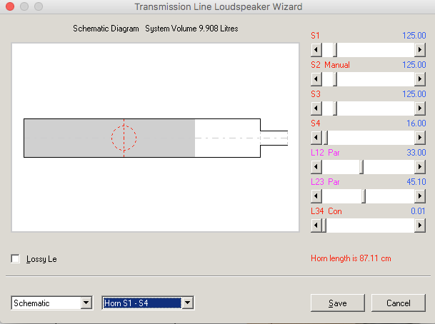

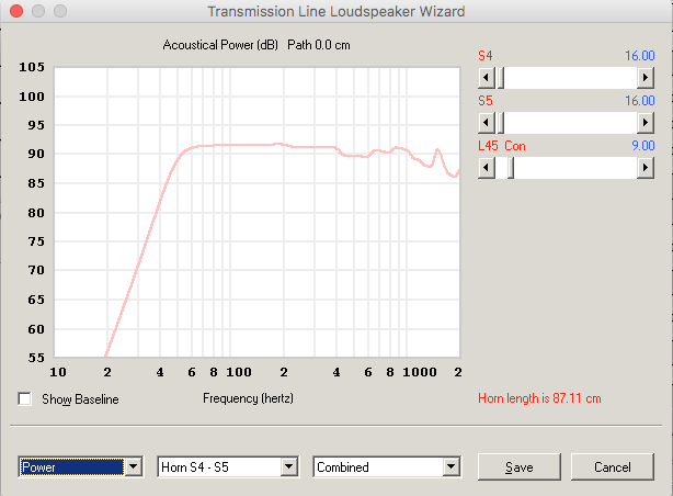

Perceval, can you explain to me how you get the Transmission line loudspeaker wizard in Hornresp? I just can't find that option...
Once you are in the Input Parameter window, after keying in your driver's data, click on Tools, and look for Loudspeaker Wizard.
It will allow you to change csa or length of the line, along with filling and vent size.

never managed to make it say Transmission line at the top
For an OD or OD1 design, the caption changes from "Offset Driver Horn Loudspeaker Wizard" to "Transmission Line Loudspeaker Wizard" when absorbent filling material is added.
Ah, OK, makes sense. Thanks, David, and thanks for all the work on the app as well. I'm just starting to use it after using the Leonard Audio software for a while, so I'll get there...and I better stop using this thread for support, and post on the Hornresp thread in the future!
