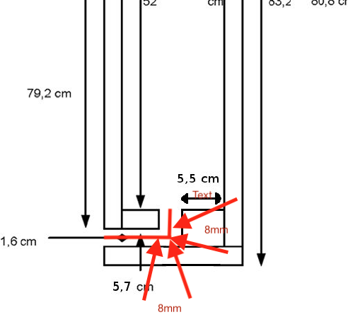

Hi again,
looking at the Tabaq_update pdf, 2 plans are drawn, naturally I chose the "wrong" one.
Anyway it sounds really good, but why not build another one.
Just adding to some confusion regarding the portlength.
In robskillz plan it says portlength is 97mm.
I made a Cad-drawing of the plan and my math says portlength is 89 mm.
57mm + 12mm (front) + 12mm (port to front) + 8mm (1/2 of port) = 89mm
Is my measurments wrong or did I miss something.
/Per

Hi Altes,
you just missing 8mm because the line is calculated in the middle of the port.....all the best

Ahh, those 8mm, got it.
Thanks kissabout.
Is the plan correct otherwise?
55mm x 28 mm block in the corner?
/Per
Yes correct..
