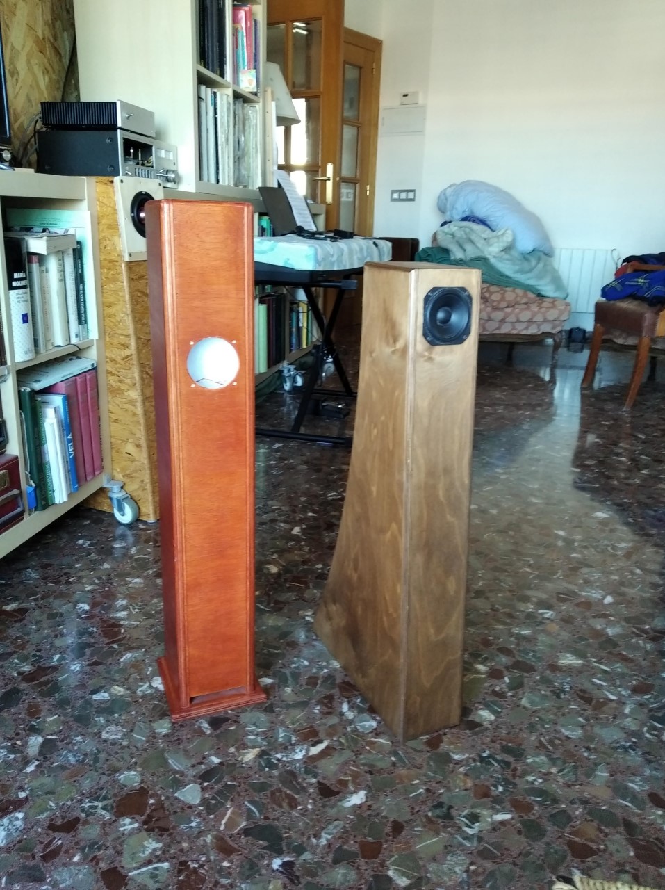

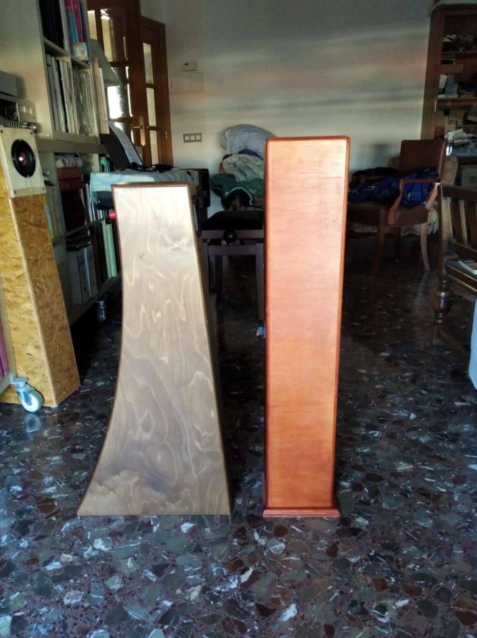

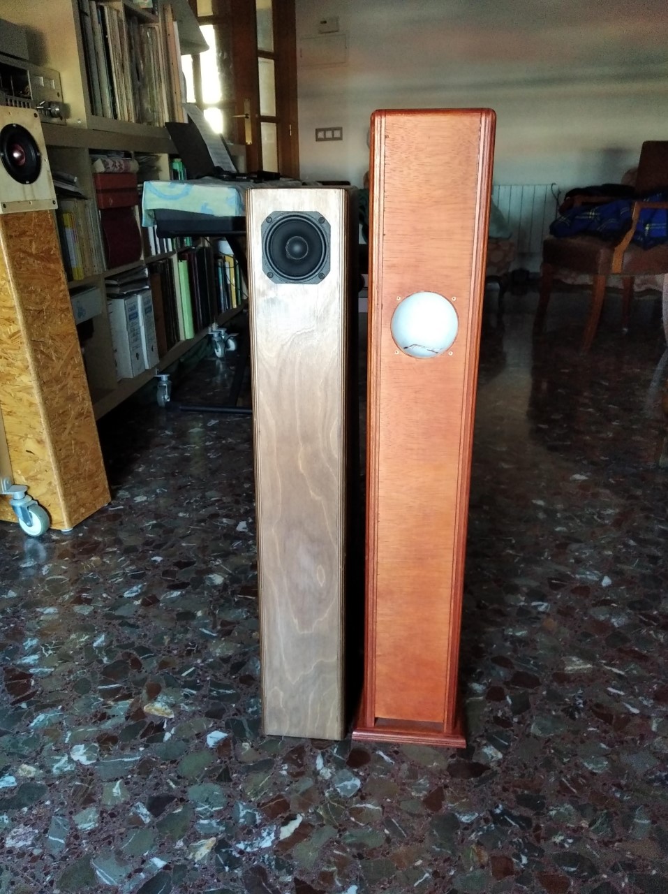

Maybe some pictures help
This Tabaq is 18mm plywood, and look a bit bigger than usual.
Frugel is deeper but smaller. It's designed to work close to back wall. But is much, much work than Tabaq, not for a newbie.
About WAF, Frugel wins.
Sound/effort, Tabaq wins clearly. 🙂

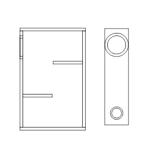

Hi guys, I’m doing a folded version of tabaq for faital 3fe22. I’m wanna ask if Its ok to fold the line in this way. I attach the profile of the folded transmission line to see if it’s ok that the offset part of the length in the line is behind the speaker and not under o upper the speaker.

Hi, I'll try to explain (sorry, my english is baaad)
FrugelHorn Lite were designed for Fostex FE85wk. Expensive (100$/pair) and very very good drivers, I really like them. You can use many other 3", probably the best cheap option is Faital 3FE22. Check the FrugelHorn page and thread.
The ones in the picture have Vifa TC9 (3.5") which sounds good, detailed but not too bright, just enough bass. Sweet and polite, another recommended driver for FH Lite.
In the background there is the regular FH3. Is much bigger than FH Lite or Tabaq, and powerful with better and deeper bass. In medium/small rooms reach 40-50Hz, enough for movies (in european apartments). Many drivers to choose, cheap or expensive 4-5". Now I have an aliexpress driver which works ok.

Btw, those are very nice speakers you got there. Those woods are mesmerizing!
Thanks 🙂.
All are regular plywood. FrugelHorn Lite is walnut dyed birch. Tabaq is mahogany dyed calabo.
Is not difficult to get a good finish with plywood, much easier than particle board + paint. When the plywood box is completely finished sand all faces, put some nice dye and acrilic varnish (never gloss). 😀
I have searched the info about folding quarterwaves in all the internet, and... most people agree that it should work similar to straight lines, and measurements should me made with the center point of the speaker driver and with the middle of the line.
Yes, I have built in the exactly same way and also built in another type of fold, but had to make face of the speaker wider (width of the line 15 cm, cross section the same). The sound of them differ a little: wider baffle sound richer, narrow one - more accurate. I am sure, that baffle width changes the sound, but I do not know how much the type of fold changes the sound. My speakers of choice was PS95-8, which I like, but is a bit too shouty in the upper frequencies and RS100-8 which sounds like nice very flat speaker, only with that annoying ringing and coloration from metal cone, which I hate. I haven't listened to 3fe22, but I have 3fe25 which is very impressive driver - powerful, visually much much more xmax than in documentation, crisp and clear in all the range. I think 22 will be similar, but I havent build my 25 into TABAQ, so cannot say anything how they fit for this speaker.
Here are my foldings of the slightly modified TABAQ. I really recommend to buy variable length vent tubes of similar cross section, they are worth it - with the stuffing change and change of vent length you can change the sound of your speaker every evening 😉
