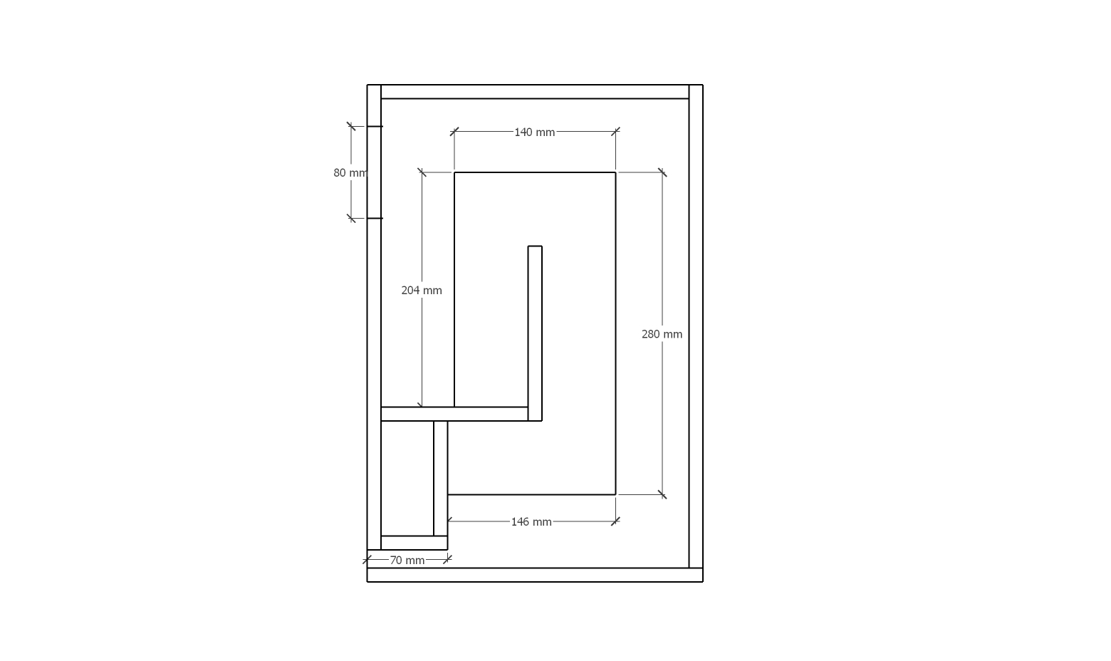

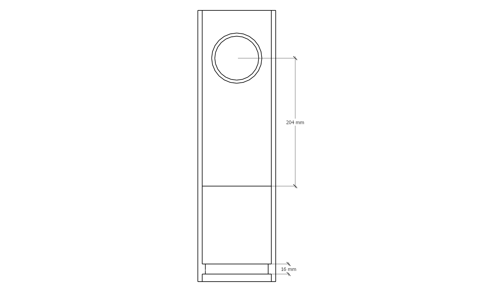

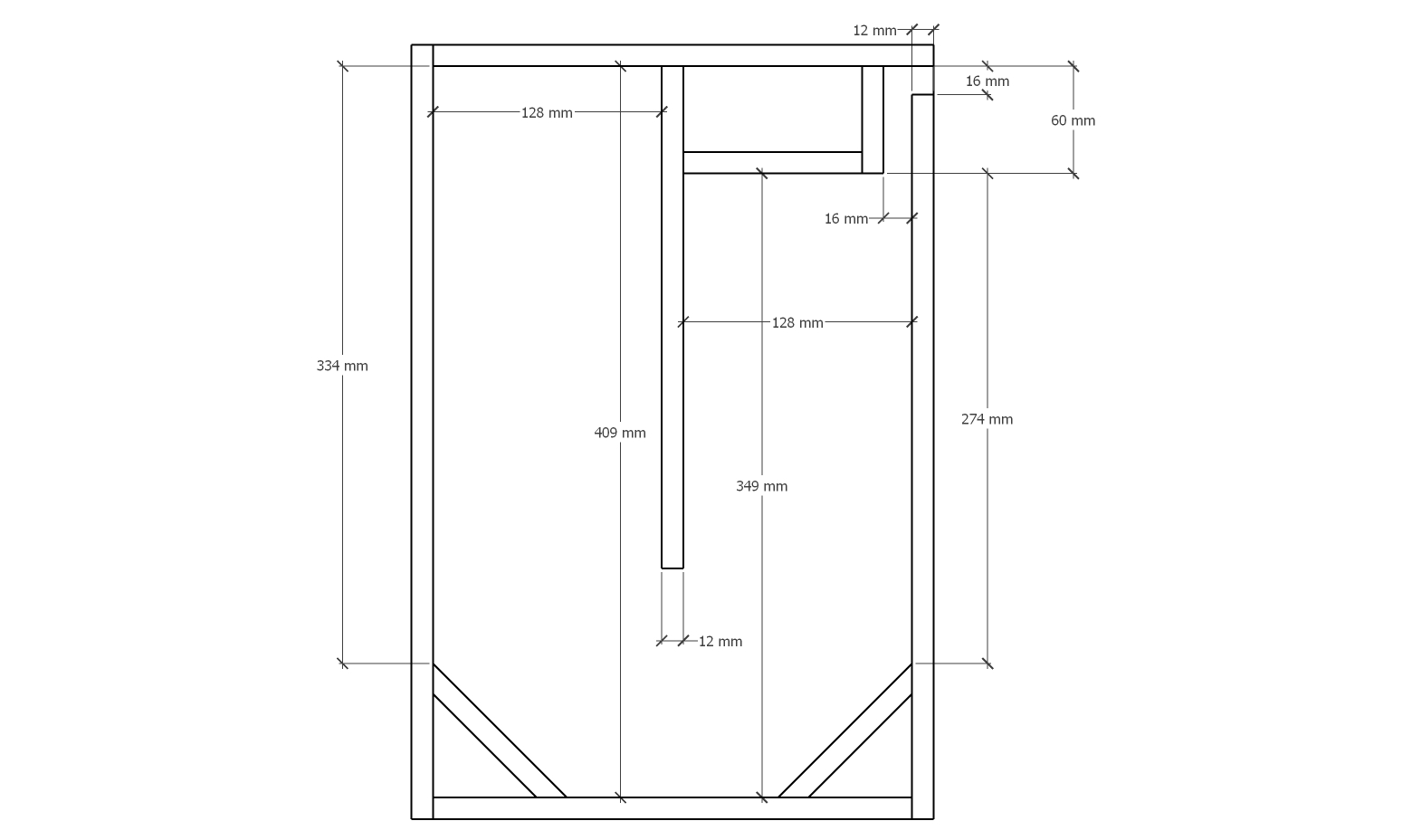

Hello,
Just need some clarification on the TABAQ drawing that I have attached. Idea is to make a TABAQ with a total length of 842 mm. Total length is divided in two segments: 128cm2 @ 770 mm and 16cm2 @ 72 mm. Now straight to the question. Does bends in the path length changes the path length of the TABAQ? Is there any improvement in making them?

There is a consensus, that the line length is measured in its center axis, then the length is exactly the same and the overall internal volume is the same. But those rounding corners are not needed and may be even worse for the sound. As the internets say (actually most of the info is in the forums, like this one...), the bends do change the sound, but in my opinion it is not quite possible to build the same speaker with the same front baffle, vent placing and still have different bends to measure. The only exception is probably to build the same wide-ish baffle and different bends, but I haven't heard about such experiment.
Offtopic: As I already asked in another thread and wise minds answered, it may be better to make port closer to the speaker and in the same plane. In my personal opinion rear vented ports are good if you want to boost the bass from the wall/corner in the back, but I have found with my tin ears the quality of such boosts in most cases is terrible, as a bonus you need much more space even for small speakers. What top vent will give in your room conditions I have no idea.
+1

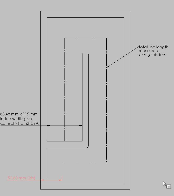

I measured along the centre line of the line, with square corners, and this makes the overall volume identical to a straight line. See my method attached.
Check the way I folded my TABAQ, also attached. BTW this is a slightly different CSA and length specifically for the smaller, higher Fs FaitalPro 3FE2, you would have to tweak it to the standard line and port length, but I found it made a nice form factor, with the port on the bottom of the front baffle.

You've had your answers, me, I'll just add a couple of things....
Don't put 45 deg corners along the line. It looks cute, and it seems a good idea when you look at it, but the only thing it helps is getting the higher frequencies out the port... which is something you definitively don't want.
Keep the corners square... it will help kill those unwanted frequencies.
The other thing with your design is a visual one.. well, at least for me.
The driver will be weirdly placed on that front baffle, and the OCD side of my personality would find that aggravating!
The way luigiman designed his folding appeals to that side of my personality better!

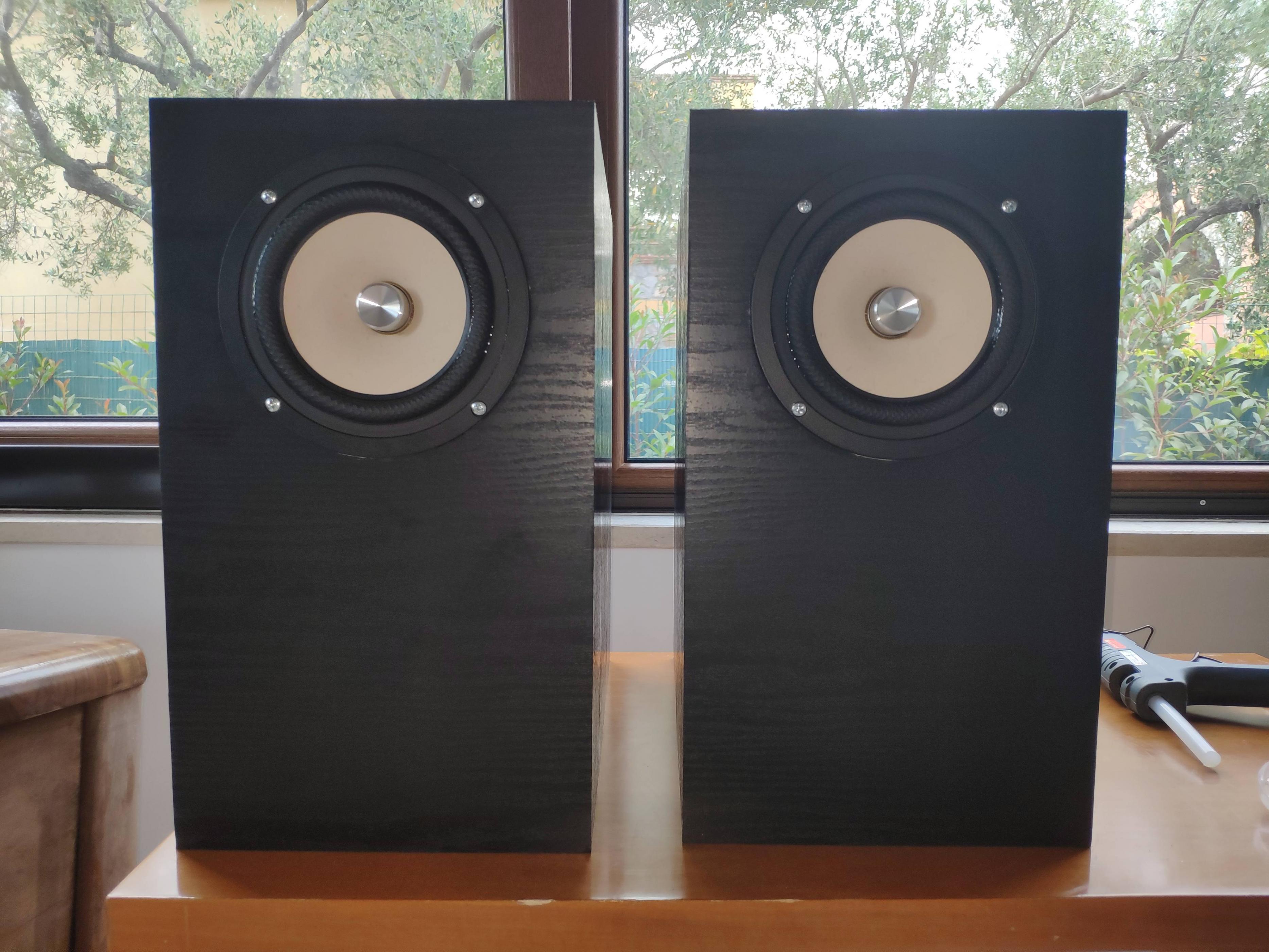

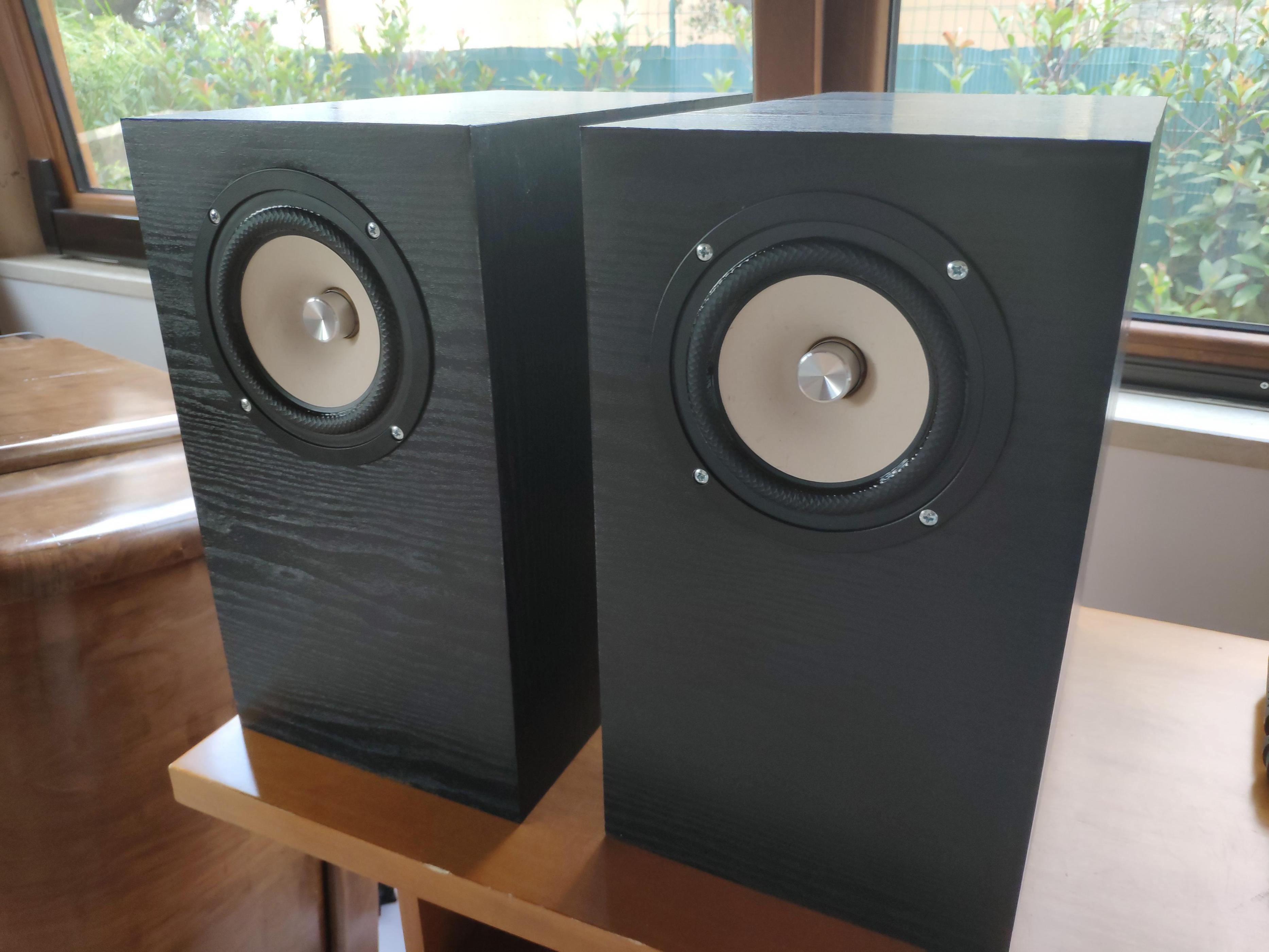

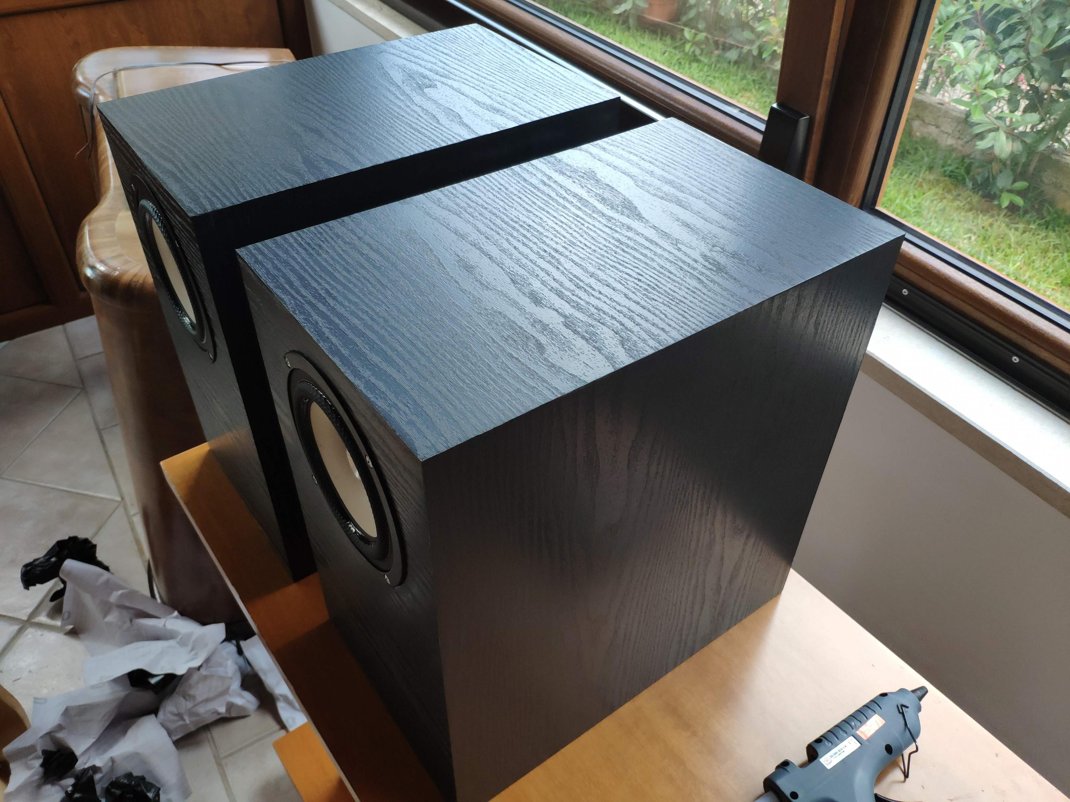

Just a quick post with the final version of my TABAQ...
The painting quality wasn't good, so I used some sticky plastic with wood effect to finish them.
I'm 70% satisfied with the result. The sound is great as anticipated in my previous post.

Thanks for advice. I have attached updated version of the folded TABAQ.
Line length is 77cm, the original was 78cm if I am correct. Speaker center is 20,4cm from line end, the original was 26cm. In my Hornresp simulation I chose 19,3cm, I think it will work well anyway. It remains a question if human ear can hear the differences in real world listening.
It looks ok for me. The only suggestion from my side to go with variable vent tube...
Thanks everybody for the help![]()
Looks professional and nice, as most Italian made things. Btw, do you have photos of the back side?

They do look great!
And I'm sure they sound really nice.
Enjoy!
