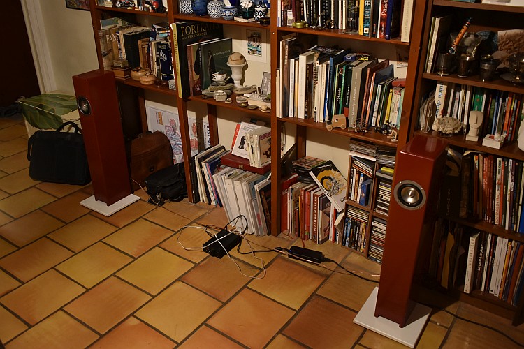

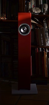

Hi guys,
I used to look regularly at this thread, and also was curious of the sound of the Titanium 4" large band from Tang Band. So I launched myselft and built a Tabaq, using the latest simulations from Bjorn Johannesen.
You can see the result on the enclosed photos, and also I made a blog to get more details, and the plans (I changed calculations to use 16mm MDF instead of 12mm).
Fireside Tabaq box << Blog Galactique
I called it "Fireside", because it is the name of a Danish Tobacco mix from the 80' ...
On the blog you will find an attempt to give better listening impressions of the result : a virtual A/B listening comparison between the original signal and the signal recorded from the loudspeaker boxes.
Let me know if you like it

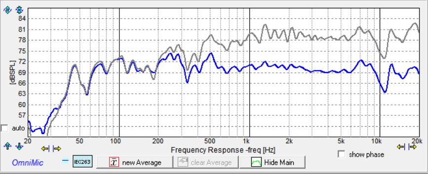

I also measured a bit, but my equipment is very very basic, so I'm not sure of the result (although measures I have seen in this thread confirm that 4" drivers from T.B. can reach 50Hz with the Tabaq design).
Have fun Doing It Yourselves (as much as I did) !

Hi guys,

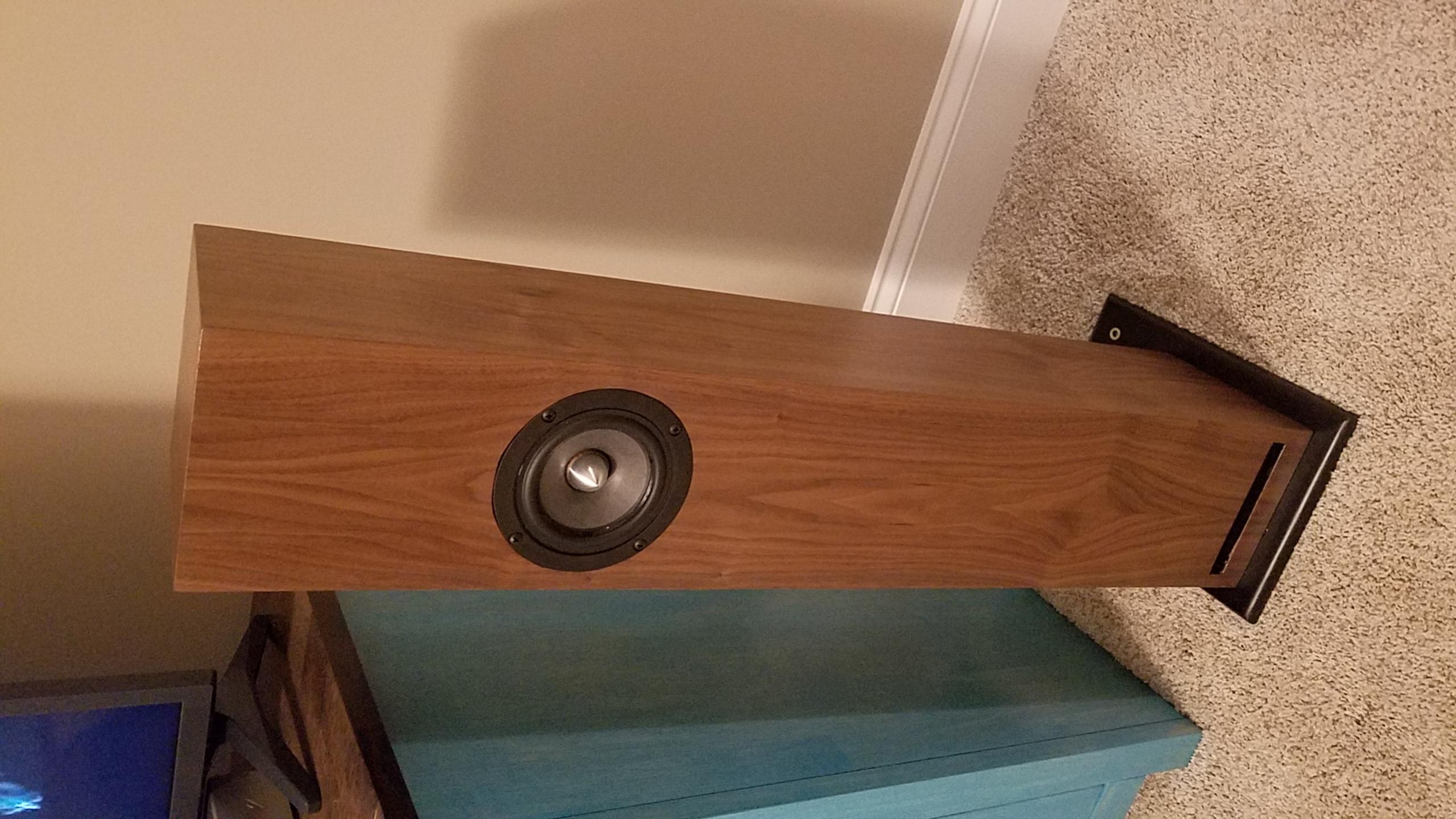

Tabaq with W4-1320SB
Thanks to this thread I dug an old pair of W4-1320SB drivers out of my garage. I bought them 10+ years ago intending to make a set of "bandits," but never did. Glad I waited because I really enjoy these Tabaqs. They punch far above their driver size! In the attached images you can see the raw in-box measurement and a measurement with BSC circuit installed at ~1 meter (SPL not calibrated). I used 1/2" MDF, parts-express walnut veneer, and finished with some wipe-on poly. I enjoy seeing all the varied Tabaq finished products here, so thought I'd share mine too. Thanks again!
