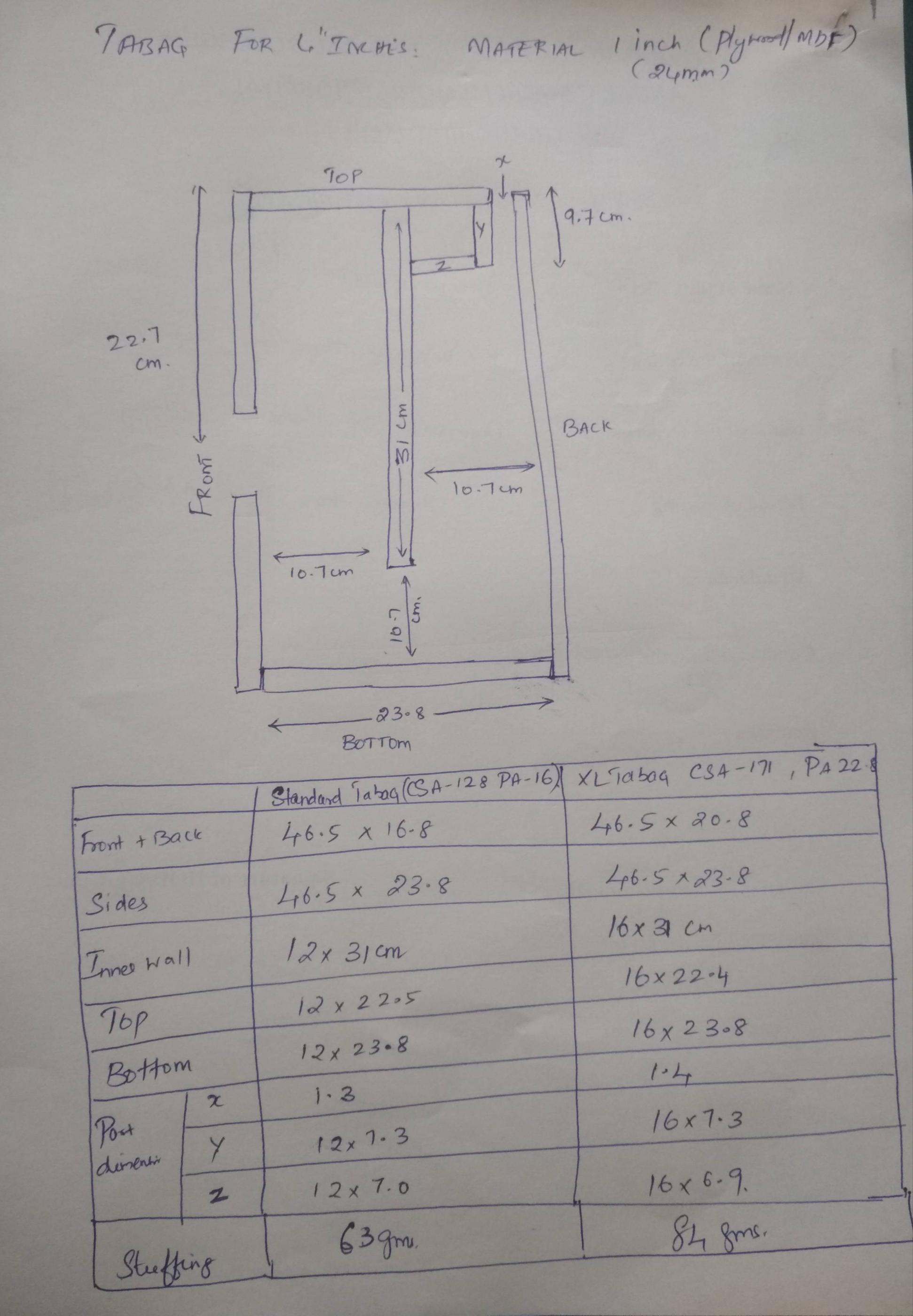

Dear all, with respect to Bjorn's Pdf depicting Tabaq geometry for 4 inches, Bjohn gives us two options
1. Standard TABAQ with less stuffing
2. Tabaq with increased CSA and port area.
I have hand drawn a box version for both, using 24mm plywood /mdf
In the increased CSA, for identification i call as XL Tabaq. In this the CSA is 171 and Port area is 22.8 This can be easily achieved keeping the 10.7 inner width same and increasing the cross section length to 16cm(against 12cm in standard TABAQ box). The port area is also them easily achieved by increasing the port opening to 1.4cm ( against 1.3 )
Here's a hand drawn table.
I welcome suggestions and corrections.
Thanks Bjohn for the wonderful design.

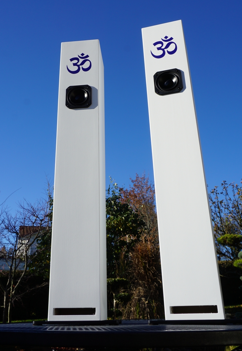

Finished my Tabaq with Peerless P830987. Still burning in but after 10 hours they sound great. When I had the tiny drivers in my hands I was sceptical, but now that they are playing against a wall, not sub needed. Amazing achievment from Bjorn, thanks again ! I have previously build a pair with Faital 4FE32 but I don't have them side by side so I can't compare. The sound of the Peerless is very delicate. Now playing Radio Paradise FLAC channel, Bird York/In the Deep and boy what a delicate voice she has ! The end-user is a yoga teacher so I thought adding the ohm symbol is appropriate. She has seen them through a telco and she likes their look. Hopefully she will like the sound as well
Driven by my Pete Millett engineer amp, great sound. Soon I will drive them with a 3e-audio 3255, but this is yet to be built. So much to do !

Beautiful build, me too one day want to try the P830987, for now still ultra enjoy 4FE32...all the best
P.S. wha is the meaning of the logo on the top? Sorry just curious

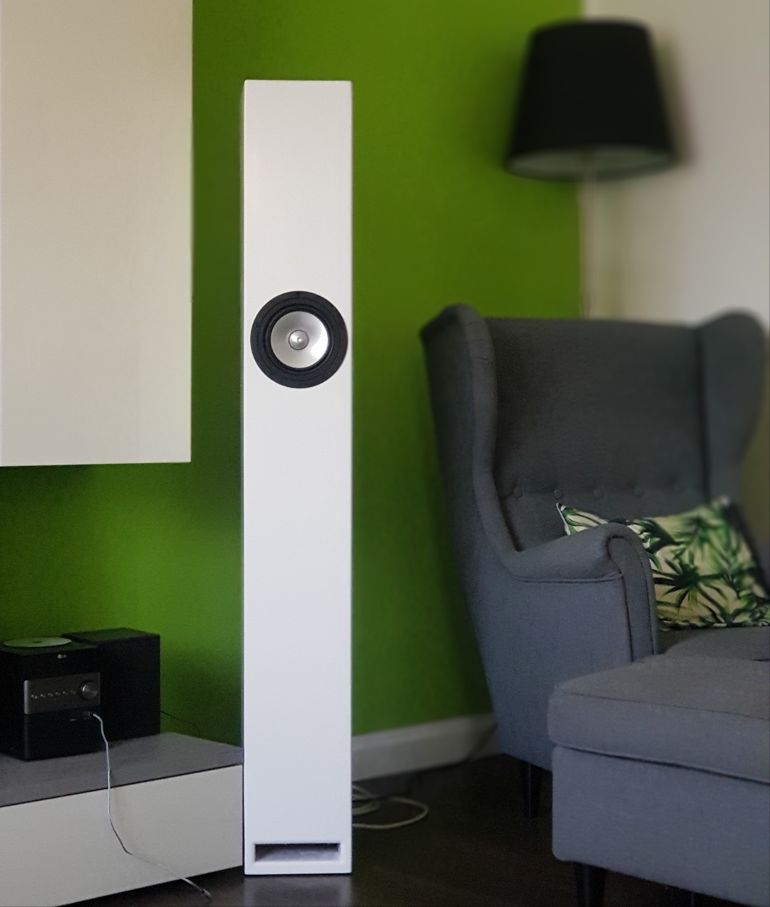

Finally I finished my Tabaq tl for the Markaduio cnh110 tomorrow I will also receive the DACBerry AMP² and I will start to do some rehearsals ..
Very nice Tabaq congrats, so enjoy the music
