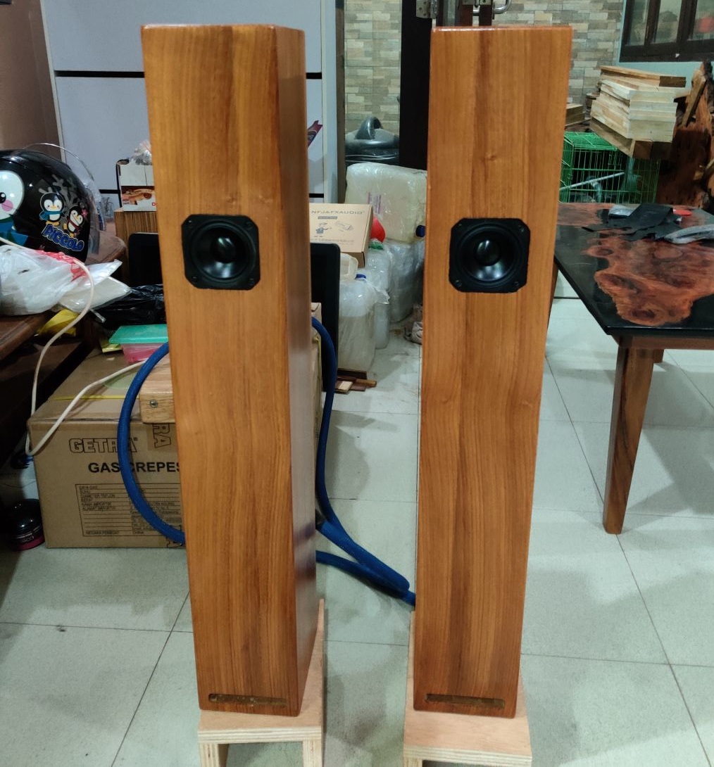

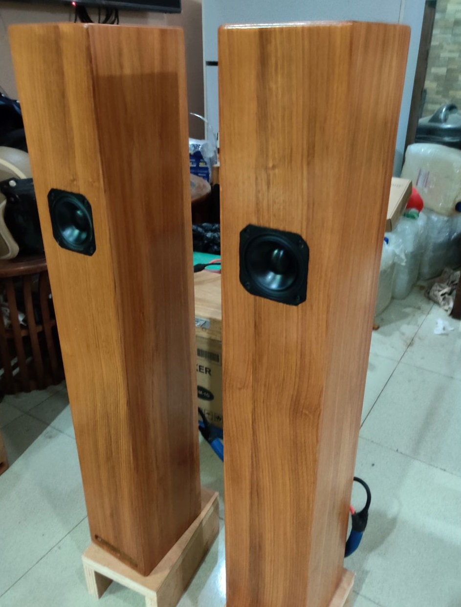

I'd like to thanks for such an incredible design and willing to share it with us.
the speaker sounds so good and Precise, the bass is fantastic....
made it based on Tabaq 2020, with speaker Peerless 830987 with BSC 1mh + 5ohm.

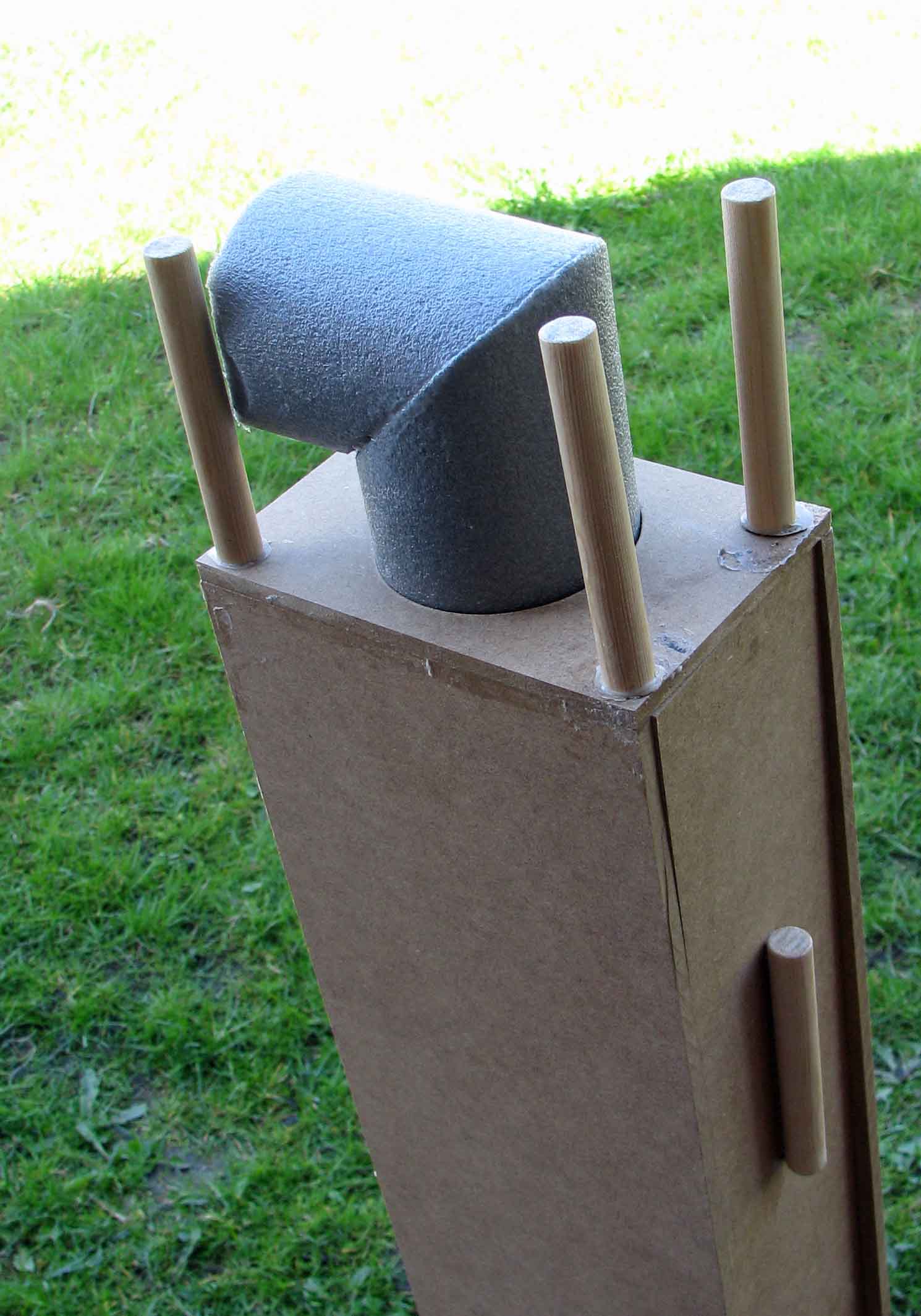

You could make the port "external" or make a foot with a similar geoemtry. Please take a look at the image enclosed.
By making corner speaker, you will probably have to add some more stuffing, you can test to see what works. The problem might be a dominated bass, which can be controlled by suffimg. By adding more stuffing you will also have an even better conrol of the displacement (cone movement) resuling in a clean bass and sound in general.

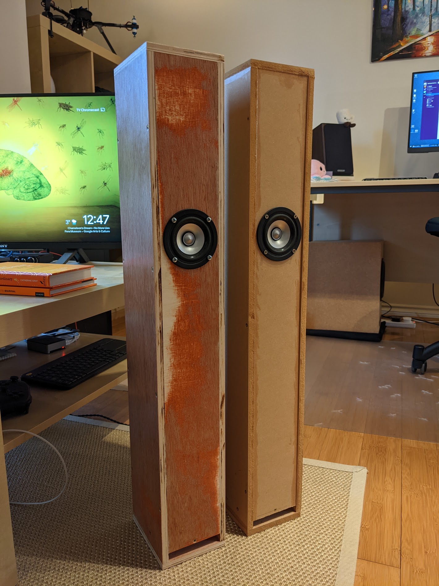

On the right is one of my first pair of TABAQ from 2018. I didn't have a car back then, so I couldn't buy sheet material locally & instead paid an online wood shop to cut the MDF & deliver it to me. The quality of the cuts was awful, but they sounded fine.
Now that I have my driving license & my first car, I can buy sheet material from my local DIY superstore & they just happen to sell 0.81m long sheets which will fit in my (small) car & are just long enough to make TABAQ with! So to continue practicing my very beginner woodwork skills I've made one replacement TABAQ & will perhaps start on the second one next week.
I have some black bolts on order to replace the silver ones with, so they blend in with the black of the driver's basket better.
