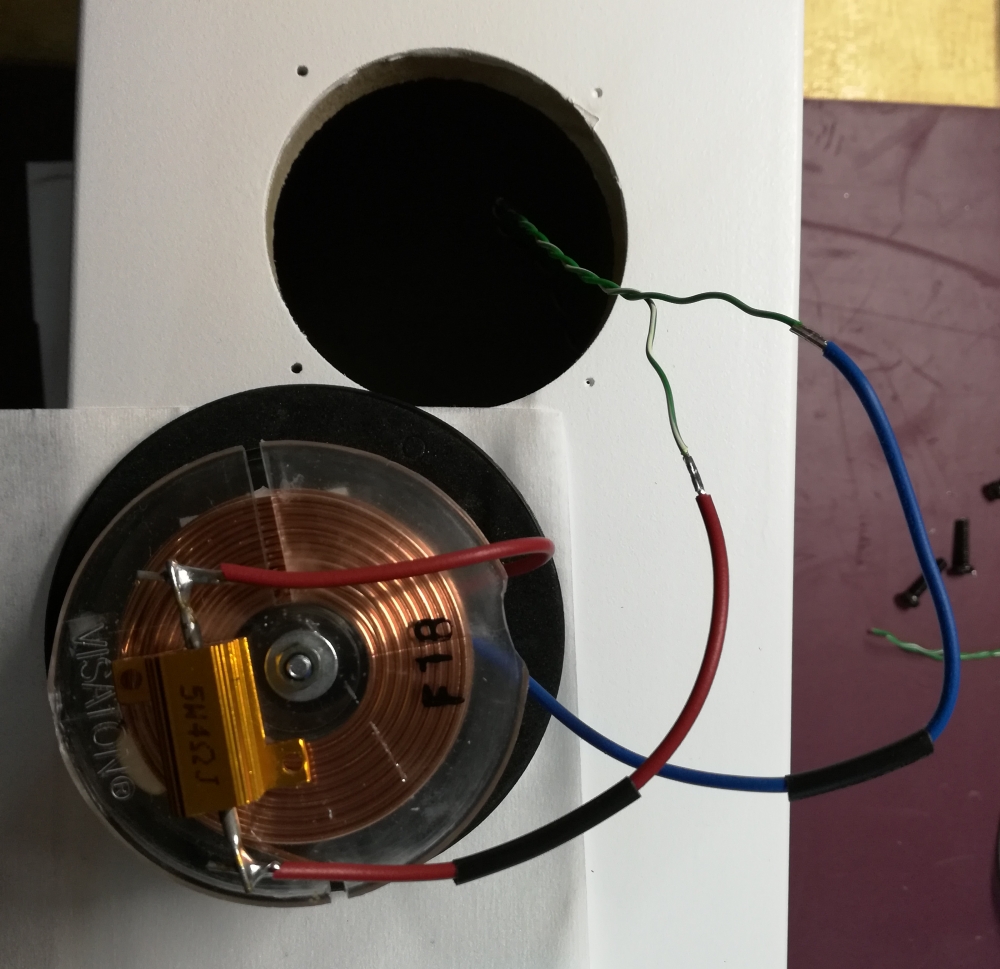

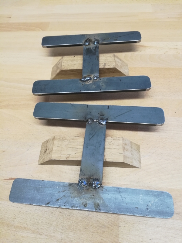

I forgot to mention, I have installed a BSC filter in it, screwed to the inside of the speaker connector (1mH // 3.9 Ω). It's diameter is 1mm smaller than the hole, I was lucky. Not shown on the pics are the outriggers, below a shot while I built them. The feets extend on the sides. Fixed to the bottom using epoxy-glued nuts and countersunked holes.

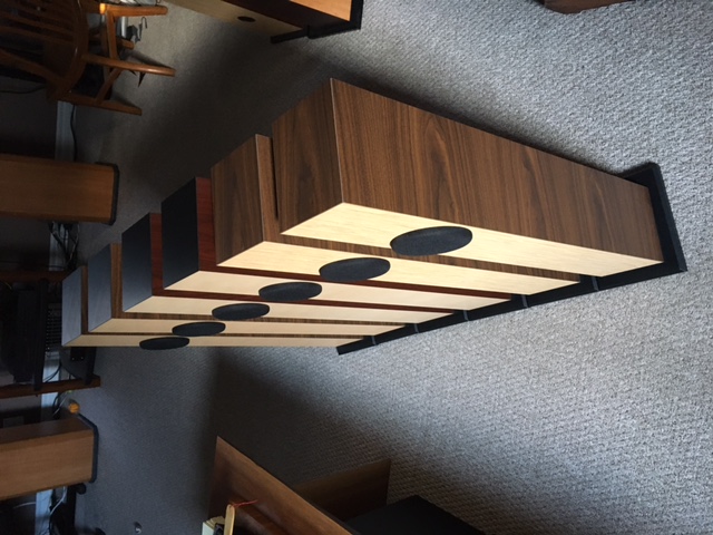

Finally, after a long way, I finished my first build. I have to say I'm amazed by the sound, although it's my first time with a full-range too and I can't be objective.
I think that the W5-2143 are a good match for the TPA3251. And what a bass![]()
