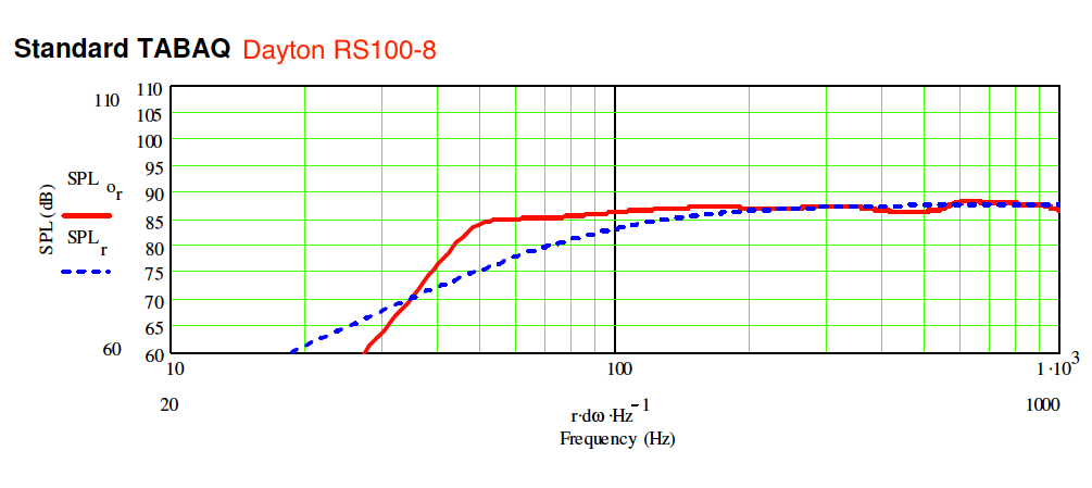

would a dayton RS100-4 sound alright in a TABAQ BOX (http://www.coolcat.dk/bjoern/TABAQ BOX Cabinet Plan.pdf)? from what i gather, it would. this would be my first DIY speaker project -- i'm still trying to get a handle on everything i need.

RS100 in TABAQ
Hi theaspin
I have never heard the B80 but from the specs you are right. But it depends on how the B80 sound, which is not something your can be sure of from the data sheets.
I can tell you the RS100 is doing fine in TABAQ.

The B80 and RS100-4 were tested in the Subjective Blind series of threads. The RS100 is a great value and has the advantage of 4mm of xmax so will make more bass. However, the B80 is a completely different class of driver with very low distortion and excellent CSD. It also doesn't have the ringing of the metal cone on the RS100. Dayton makes a paper cone RS100P-4 that you can try. The B80 is perhaps one of the finest full range drivers currently available from a smooth frequency standpoint and very clean sound without ringing. I think it only has 2.5mm xmax.
I don't know how the foam core is going to work with the sound pressure building inside the TABAQs to create that nice bass, but it is for sure an easy and rewarding build.
