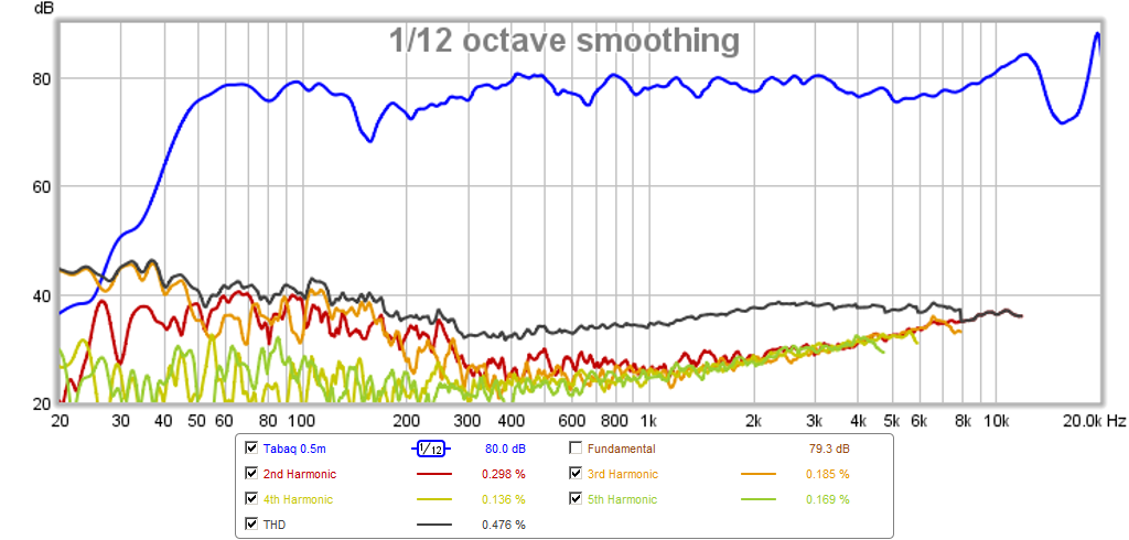

The curved shape of the Kvart and Bolge design is beautiful and lends itself to foam core construction. This was a fun build that demonstrates the ease of construction using the score and fold technique. I sort of took the liberty of making the profile by guess and by eye to be roughly equivalent to 20 square inches CSA. The length of the Tabaq is about 32in and a sheet of foam core is only 30in so an extender base had to be added. Just as well as it holds the 2.5 square inch CSA vent. I made a very perforated window brace that goes at the midpoint of the tube. Several straight braces are used along the 1/4 and 3/4 span locations to give more stiffness. The curved walls really add rigidity to the structure. Foam was glued around the area behind the driver to ensure back reflections are tamed. Th TL was stuffed with polyfill from the top to about the midpoint (held up by the window brace). A 5-way binding post was added to the bottom. The vent was set at 4in per the plans but this required adjustment after listening and measurement of the impedance. A layer of foam core and latex caulking was used as CLD to damp the front baffle vibration.

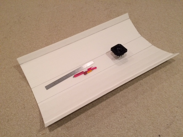

Here is the single sheet drawn and scored with a blunt tool. Wall segments are 4.5in baffle, 6in curved wall, and 1.5in segment leading to tail cusp.

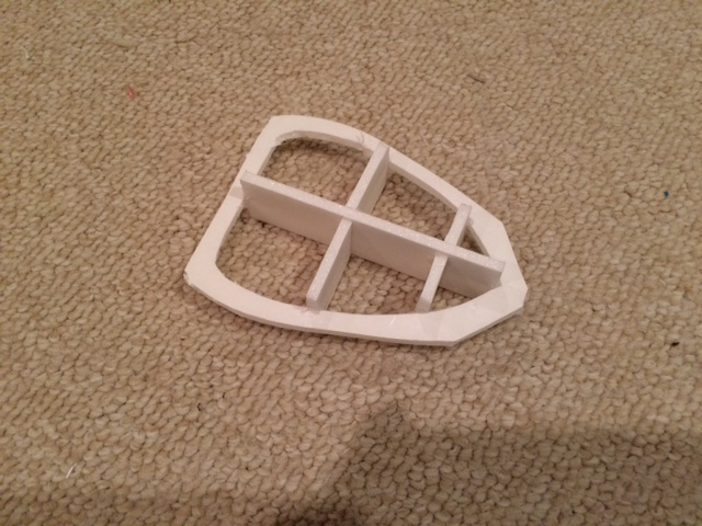

Window brace:
Detail of bracing and base extended before vent was added:

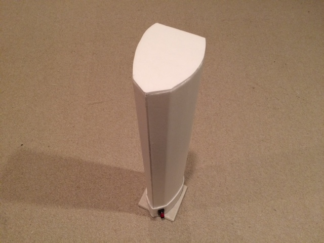

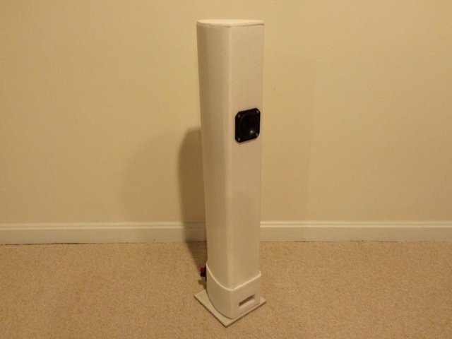

Completed speaker:
After initial listen, it sounded very bright and measuring the impedance sweep showed that the tuning was at 40Hz. Probably too large a volume created by the curved walls. I trimmed the vent via surgery and cut it down to 1.0 in long which have a tuning frequency of 54Hz. Adding a 1.0mH and 8.2ohm BSC circuit produced this excellent frequency response and distortion curves (taken at 0.5m and 1.41v). Response is very flat and f3 is 49Hz:
Here is the frequency response shown with a 5ms gate with the phase. Except for the floor bounce and cone breakup, the response is flat within a 5dB band.

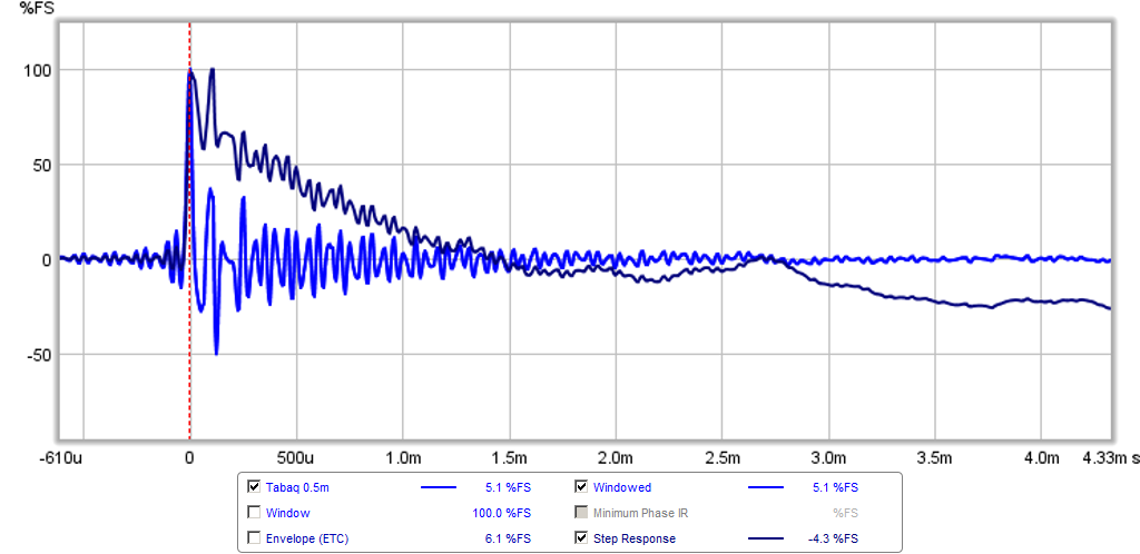

Here is impulse and step response. The P830986 is an aluminum cone that rings, but the ring is ultrasonic so doesn't show up as sibillance:
Listening to a few test tracks I have to say this is a great sounding speaker. With BSC it is very balanced and pleasant to listen to. The bass is quite surprising although overall sensitivity was only about 78dB at 2.83v due to the baffle step loss. A highly recommended build - but must have BSC to sound right.

Window brace:
![520844d1450860139-tabaq-tl-tang-band-tabaq-p830986-build-2.png](https://www.diyaudio.com/forums/attachments/full-range/520844d1450860139-tabaq-tl-tang-band-tabaq-p830986-build-2.png)

Completed speaker:
![520846d1450860139-tabaq-tl-tang-band-tabaq-p830986-build-4.png](https://www.diyaudio.com/forums/attachments/full-range/520846d1450860139-tabaq-tl-tang-band-tabaq-p830986-build-4.png)
![520847d1450860139-tabaq-tl-tang-band-tabaq-p830986-build-5.png](https://www.diyaudio.com/forums/attachments/full-range/520847d1450860139-tabaq-tl-tang-band-tabaq-p830986-build-5.png)
![520848d1450860139-tabaq-tl-tang-band-tabaq-p830986-hd.png](https://www.diyaudio.com/forums/attachments/full-range/520848d1450860139-tabaq-tl-tang-band-tabaq-p830986-hd.png)

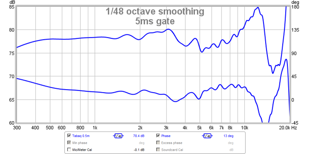

![520849d1450860139-tabaq-tl-tang-band-tabaq-p830986-gated-5ms.png](https://www.diyaudio.com/forums/attachments/full-range/520849d1450860139-tabaq-tl-tang-band-tabaq-p830986-gated-5ms.png)
![520850d1450860139-tabaq-tl-tang-band-tabaq-p830986-ir-sr.png](https://www.diyaudio.com/forums/attachments/full-range/520850d1450860139-tabaq-tl-tang-band-tabaq-p830986-ir-sr.png)

I don't know if anyone noticed, but for a speaker to measure this flat with no active EQ is rare. The curved edges on the baffle reduce diffraction I am sure. I have not even flush mounted the driver bezel yet. Some improvements around 1k can be had for free there.
The score and fold made this build incredibly easy and rewarding. Besides Bjorn's commercial product - I think this may be the first DIY curved wall Tabaq. Single panel - not 4 like a traditional prism box.
It really works. Thanks Bjorn for a nice design. The P830986 has nice bass and some "etch"'on the high end.
