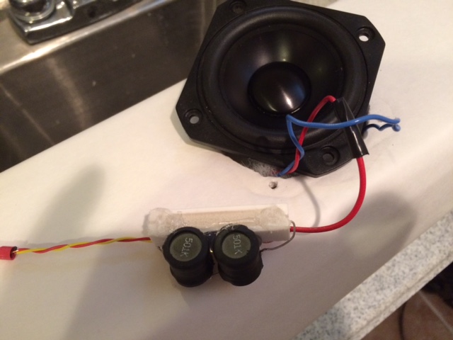

I just wanted give folks a heads up that really small cheap inductors can work very well as a BSC for a small low power speaker like a Tabaq. Normally an air core 1mH inductor can cost upwards of $10 and are quite large. I tried these on a whim and it works great - listening to it now. These are very small and cost under $1 ea. Coupled with a 5w $0.50 power resistor you now have a very cost effective BSC. The max current on the inductor is probably 2 to 4 amps.

Here is photo of the BSC in my Tabaq with two 0.5mH inductors in series and an 8.2R resistor.

You can try this for xo's - a BSC is just a very simple high shelf filter that many people might use more expensive air cores. Just check the resistance and include in simulation for xo. Also check max saturation current. These little guys are not going to give 10amps - but for small sub 40 watt speakers and teeters it's probably fine. For woofers you will need to use larger inductors to handle the current - but even there you can save some money with ferrite core inductors. I don't think air cores are necessary for woofer low pass.

To be honest I am totally guessing on the amps and I may be way off. The rated amps may be no more than something like 800mA? These actual units I am using are salvaged from an old Dish Network RF switch box. It's part of the internal RF to DC power converter. I cracked the boxes open and found these coils and ran them through my LCR meter and it had the right inductance at 0.5mH and resistance was like 0.5ohm. The wire gauge is pretty thick at 20 gauge. The wire itself can probanly handle 4 amps easy but the L value may saturate much sooner.
But let's look at current requirement in a 3in 8ohm Tabaq with 12v rail amp. I=V/R and V=10v max. R=8ohm, Plus 1 ohm R of inductor. We get about 1.1A max current. I never turn amp volume to max clipping so half current of 550mA is probably fine. It sure sounds fine - deep impactful bass, clear mids and highs. I should record sound clip for you guys to hear.

Main thing I am saying is that try cheap inductors for a BSC - you may find that they work OK and save money. I don't think that I am hearing $9 more sound quality in my big Jantzen air core BSC. Seriously - I don't. For $0.04 each or whatever Aliexpress is charging for them - you could probably make a series parallel inductor array of you needed more current with these cheapies.
