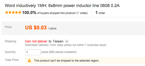

You are in Taiwan, AliExpress.com - Online Shopping for Electronics, Fashion, Home & Garden, Toys & Sports, Automobiles from China. should be a quick delivery to you. Here is an example.
Oops!
No go! Does not ship to Taiwan...
Oops!
There is a lot of venders at aliexpress for the inductor, have you checked other vendors?
Trouble is China's export laws.
We've bought cheap clothes and shipping was fine, but China puts a ban on shipping a lot of electronics stuff through dealers like Alibaba, Aliexpress and Taobao... at least to Taiwan there is...
