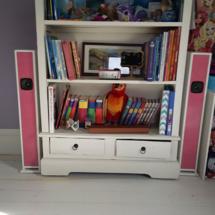

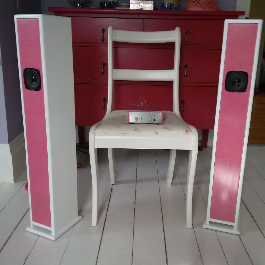

I thought i would share my contribution to the Tabaq family here. I recently finished these for my daughter as she is starting to develop her own taste in music and needed a way to enjoy that in her own room
. They are built to Mr Johannesen's design but the face and port piece are altered to frame the ply inlay on the front. The drivers were originally from a Harmon Kardon computer speaker system and sound very good in these boxes. I also repackaged the original amplifier to match the speakers. Thank you all for the inspiration you gave me in building these speakers, it was a very rewarding project that I hope my daughter and I will enjoy for a long time.
Graham
Graham

I thought i would share my contribution to the Tabaq family here. I recently finished these for my daughter as she is starting to develop her own taste in music and needed a way to enjoy that in her own room. They are built to Mr Johannesen's design but the face and port piece are altered to frame the ply inlay on the front. The drivers were originally from a Harmon Kardon computer speaker system and sound very good in these boxes. I also repackaged the original amplifier to match the speakers. Thank you all for the inspiration you gave me in building these speakers, it was a very rewarding project that I hope my daughter and I will enjoy for a long time.
Graham
Came out great and a great gift!

Thanks Bjorn and Perceval.
It was a fun project. The drivers I'm using have an Fs of 140hz but I kept the box dimensions and stuffing as per the original design because I expect to come back around to this and upgrade to the TB drivers and a better amplifier at some point. Right now my daughter is streaming from her I-pad over blue tooth, so it will never be hi-fi but the music through this set up already sounds far better than any system I would have bought for her pre-made, plus All I needed to buy was the wood so my total cost was under $20.
Graham
Graham
