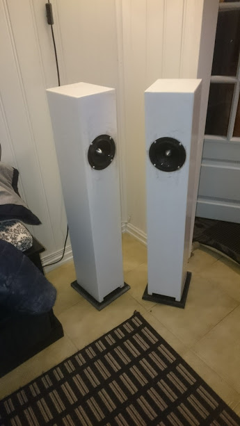

Finished my TABAQs today. They still need a proper paint job, but I had to take them in to test them.
I have only tested them for 20 minutes, but I'm impressed so far. They disappear in the room and sound nice and clear. 🙂
When I did the stuffing, I thought that the 4in version should have more stuffing then with 3in. I felt that they were lacking some bass, so I reduced the amount of stuffing a lot. Now they sound amazing, even my wife was impressed.
Thanks for a great project. 🙂

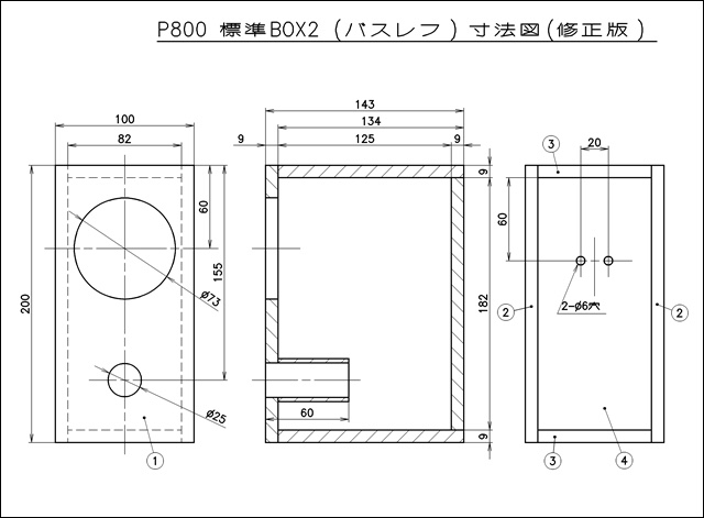

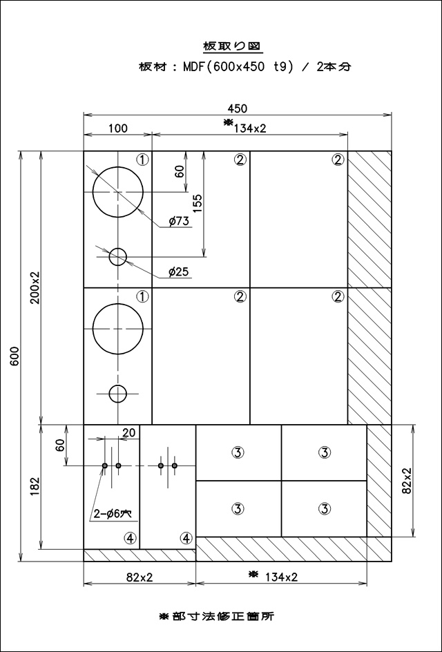

I recently came across an unusual Scanspeak full range driver at Madisound, the 10F/8422-03. My understanding is that this 4" driver, which sells for $22, was made for the Japanese magazine "Stereo".
Rick
Does anyone have a pdf copy or scan of that August 2012 Stereo magazine article? I can't find anything online. Of course, it doesn't help when you're using english to search for pdf versions of a Japanese magazine. lol

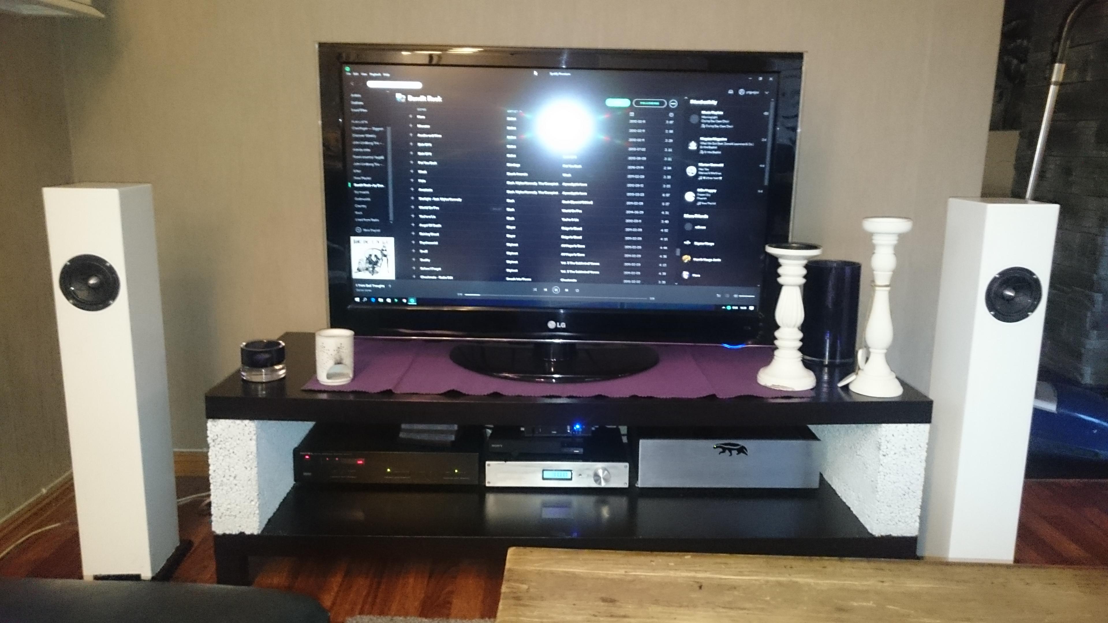

Finally finished the paint job and placed them in the tv-setup.
In this room they really transformed. I suspect that visitors will look around searching for the subwoofer. I really didn't expect that kind of bass from those small shoe boxes.

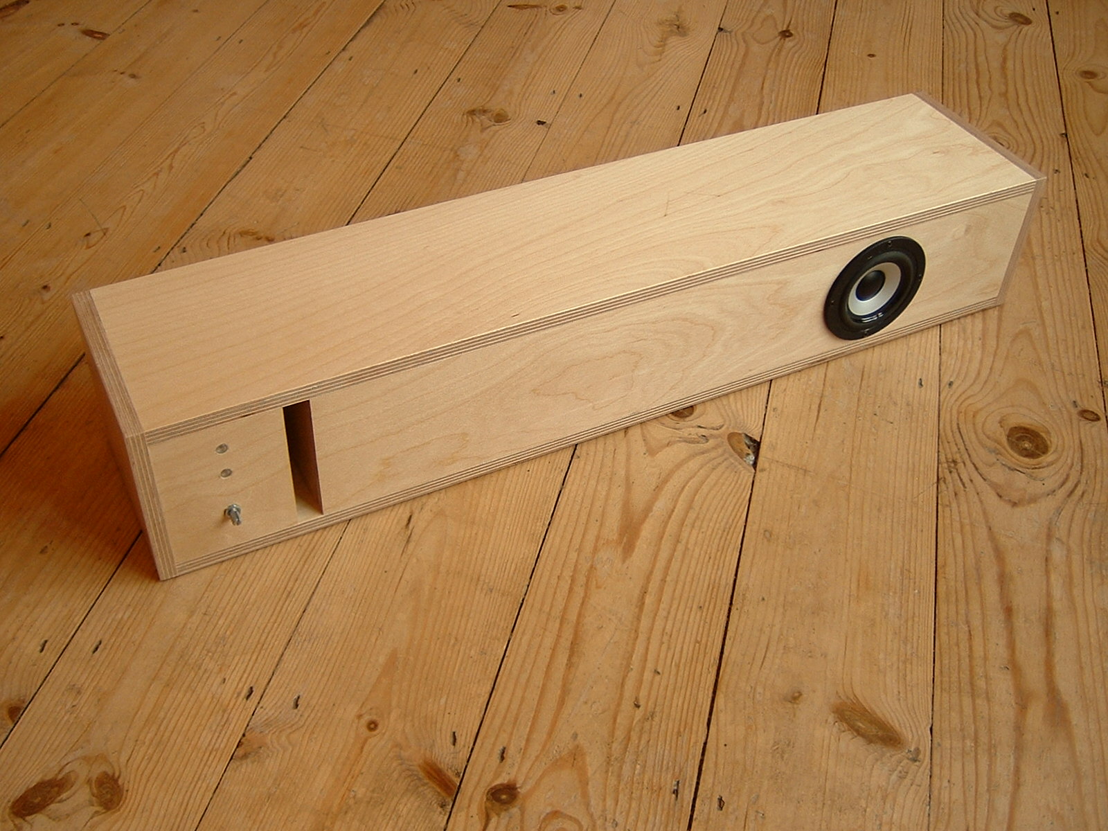

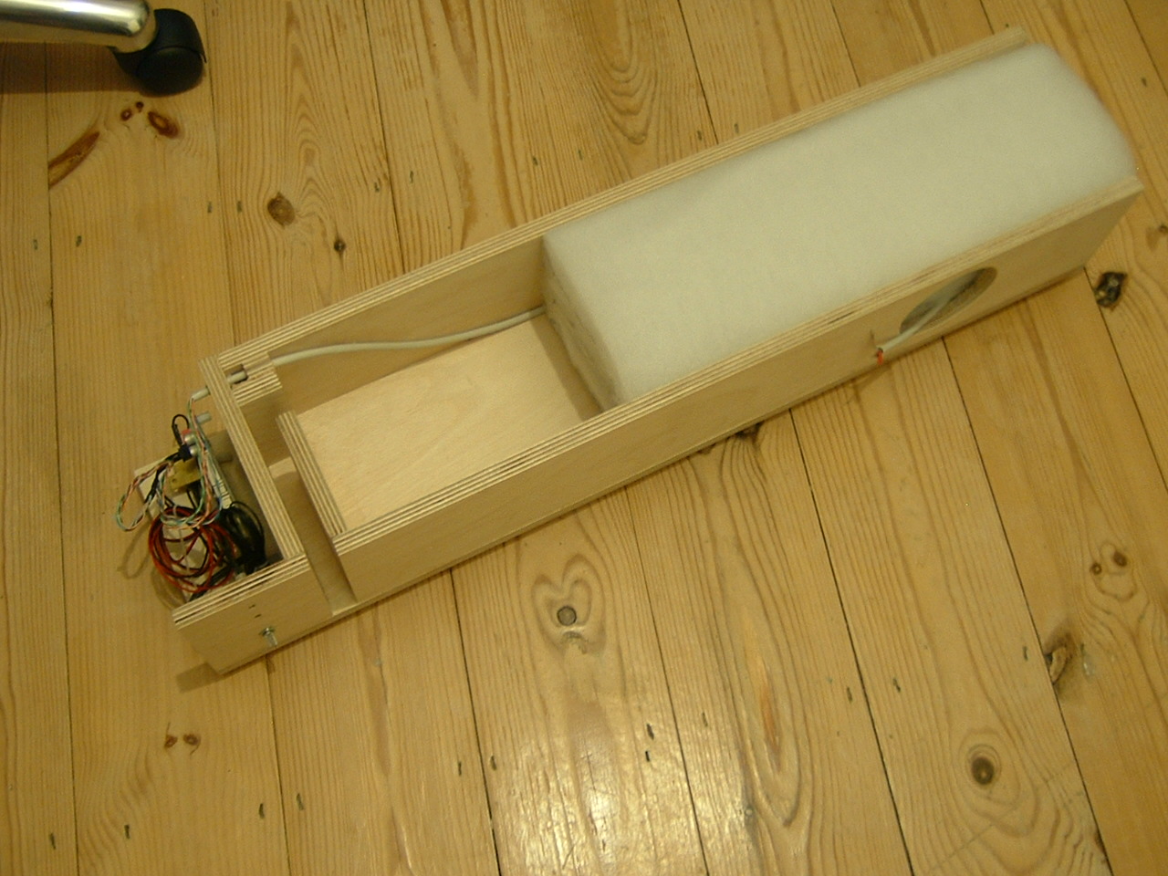

I finally got my active version finished and varnished. It's based on the shortened TABAQ that Bjørn kindly simulated on post 1396 and uses a W3-315E driver.
It's a single cabinet with an extra compartment containing a Class-D amp and bluetooth module with aux-in.
Many thanks to Bjørn for the original inspiring design, for answering questions and verifying the sim! :up: The speaker is now sat on a shelf in the kitchen.
Rob
