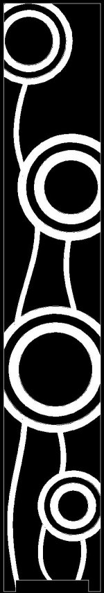

I'm thinking about painting this design on my TABAQ !
What do you guys say ?
Would love to hear your ideas as well !
