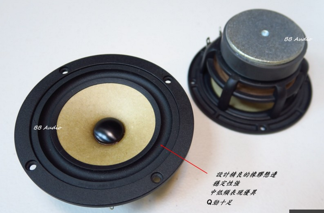

I might have found something interesting here.
New company started coming out with some interesting drivers.
Found this, which is about a 3.5", some funky cone that looks like bamboo, inverted surround, cute flat dust cap "a la Alpair", a strong and thick aluminium forged bezel and a nice airy construction behind.
I just had to get one and test.

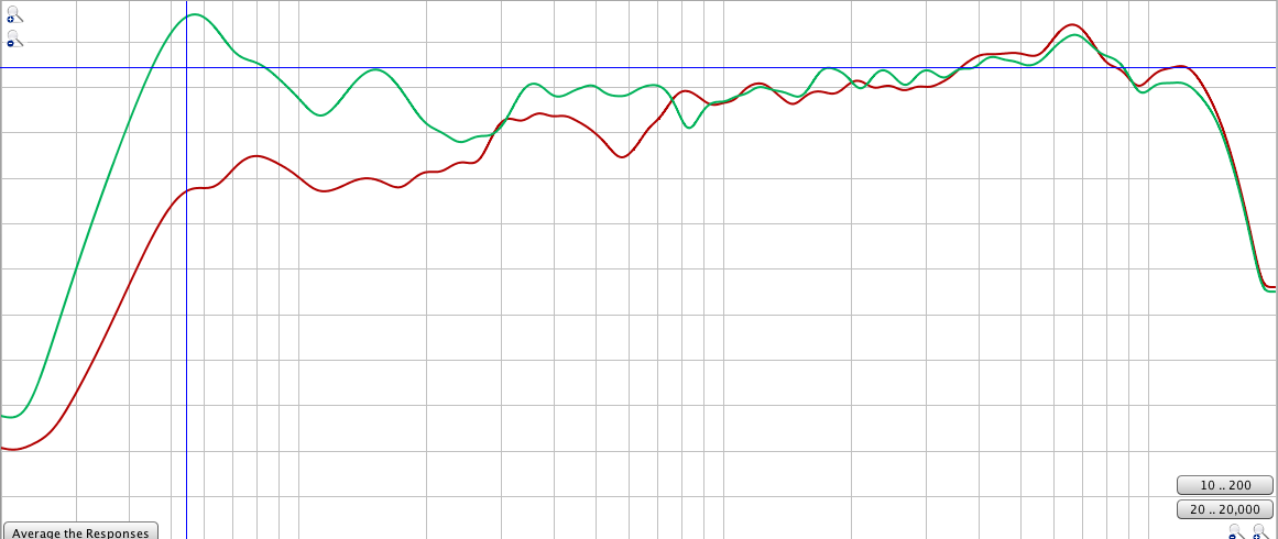

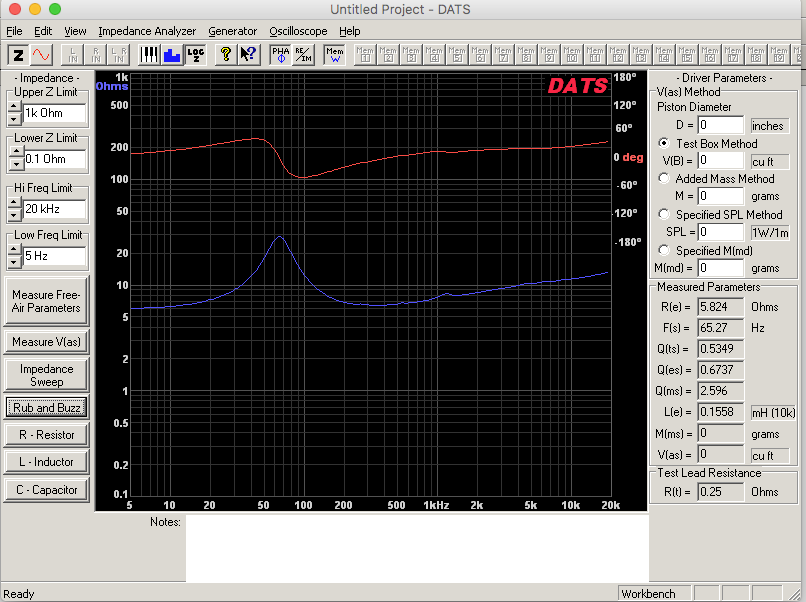

Ran DATS on it and it looked like it would fare well in a TABAQ, but the very low FS means that my current "test bed" TABAQs are probably too small, which is shown with the huge spike at 57Hz. Probably a little bigger dimensions would work well here.
FR in my test sealed box was a mild rising from 50Hz to 7kHz. Still had juice up to 12kHz, then would start falling.
In the TABAQ, the low end was raised with a spike at 57Hz, and still helped up to 300Hz. Impressive +20dB spike at 57Hz!!! I believe the original TABAQ was tuned to 55Hz? So, maybe this one could be tuned to 45Hz.

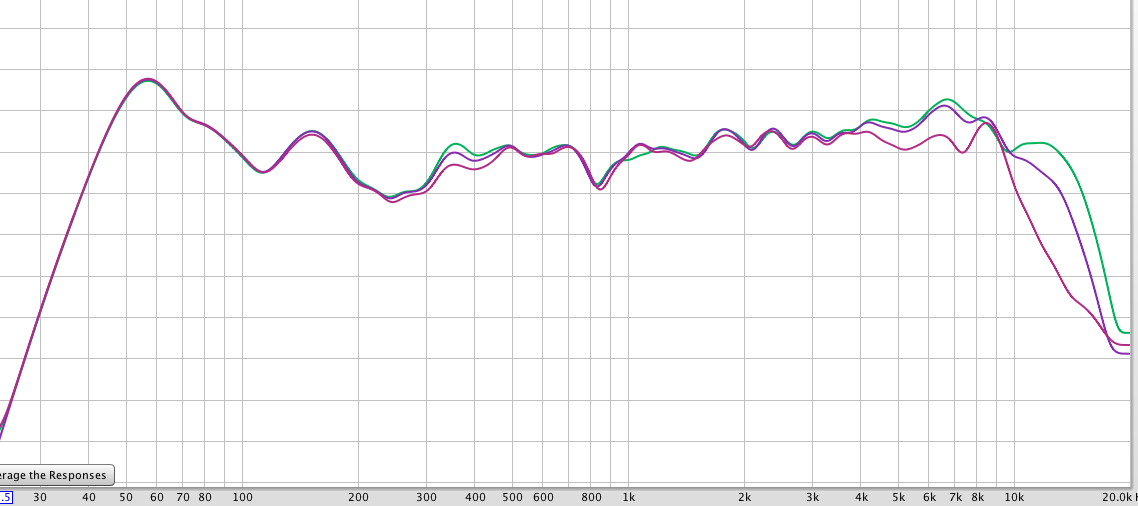

But, what really struck me is the amazing behaviour offset. Look at the FR taken from 0, 15 and 30 degrees. Very well behaved.
