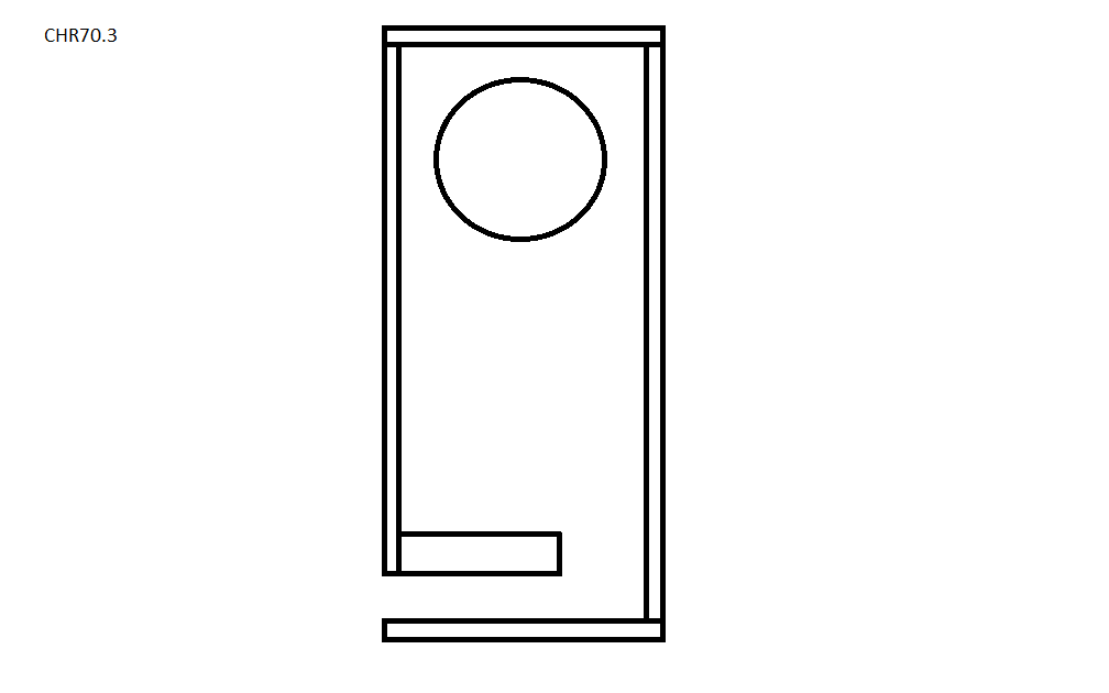

Your advice is appreciated on the 4 inch driver port.
Bjørn did as sim for the Mark Audio driver and recommended some changes including raising the height and port length of the cabinet.
I propose to keep the original cross section and "side mount" the driver due to its size.
I will also leave the port in its original position so it is pointing inwards.
Bjørn suggested a 5 inch (12.7 cm) port length, so if I lengthen it accordingly I calculate that this would leave a 1.3 cm space between the rear wall and the port end.
Would this be enough space for the port to work effectively or should I reduce the length and add some height to the shelf section?
Any suggestions or advice would be welcomed as I am eager to start building another set of Tabaq's!
A very basic and obviously not to scale diagram is attached.
Regards
Chris
cer2906,
did you see the TABAQ update with the new port in a L shape?
Having your port so close to the back wall, it will actually lengthen the actual port.
I suggest you use the update as design cues, and work with your port length of 12.7 into a L shaped port.
On the other hand, you could mount the MA driver directly on the front baffle, as the design intended, and glue a piece of supra baffle to help with diffraction.

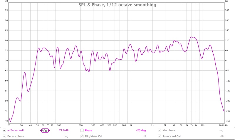

Over here, I got my hands on a nice driver, I believe.
This is with the TABAQ placed on a wall. The dips at 125Hz, 250Hz and 500Hz are room related.
They are a tad bright for my ears, and I think with a 1mH and 5 Ohms BSC, they will be quite good.

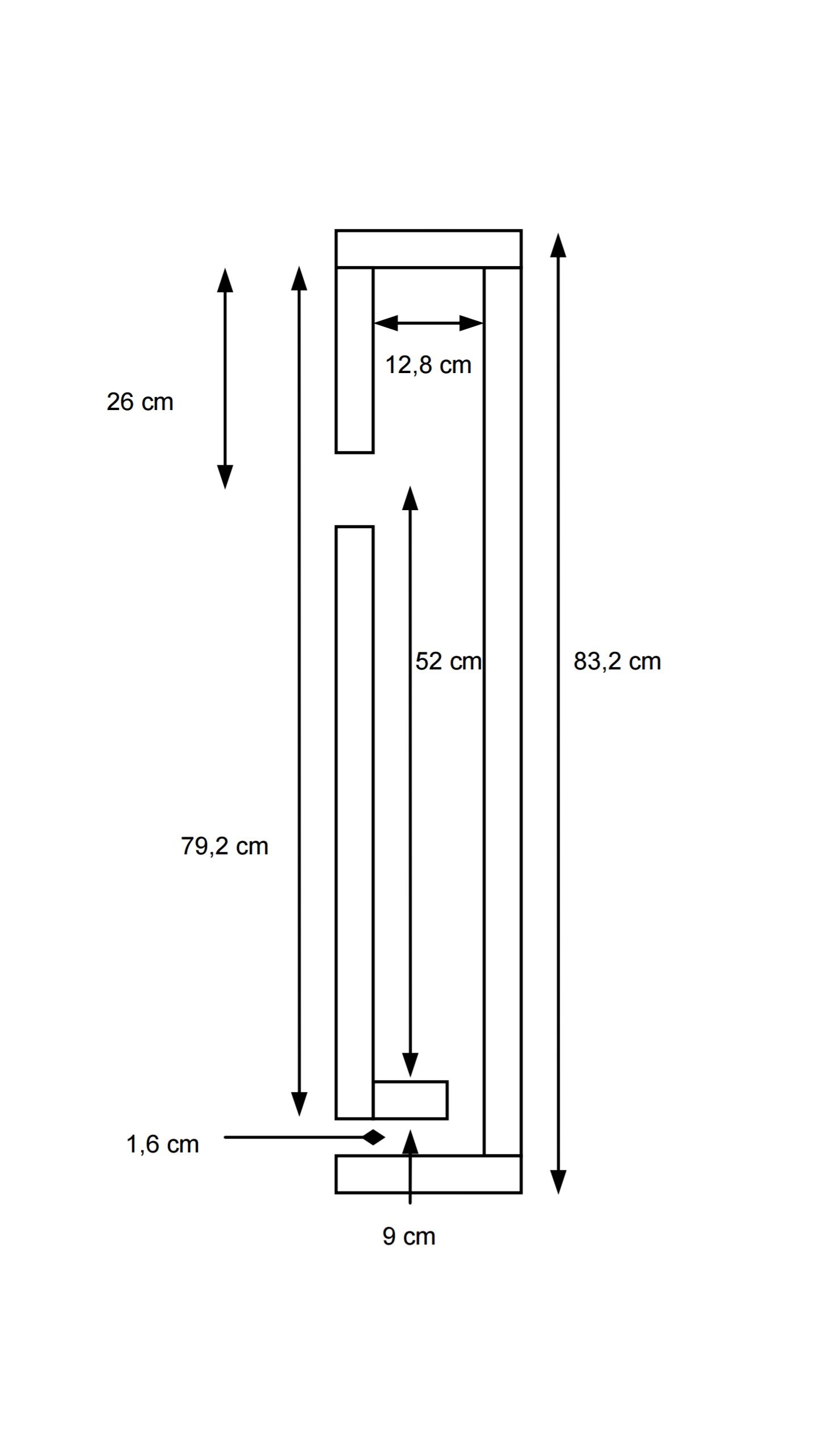

Hi Perceval,
Thanks for your quick response!
I have seen the many variations in the thread, but would like to get the design for this driver as close to Bjørn's suggestions as possible. I appreciate I may be over thinking this with the Tabaq being tolerant to small changes.
I have come up with the diagram below which I think follows the correct way to measure the port length.
As my previous post, it's just a basic drawing to get the idea across.
I'm grateful for any input.
Chris

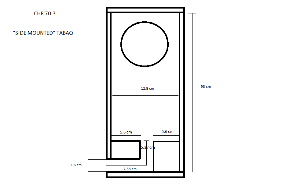

Hi
The port is 9.7 cm long with a cross section of 16 cm2.
Bjørn
Hi Bjorn, thanks - but I'm building using the original spec, with a 4" TB (as advised). Was the original port cross section 38cm2? Or did I mess that up. I calculated it as 10cm wide x (12.8 - 9 = 3.8)cm deep.
What I'm trying to determine is what depth to make the shelf piece, since my w x d will be modified a little. I might be thinking about it incorrectly. (?)

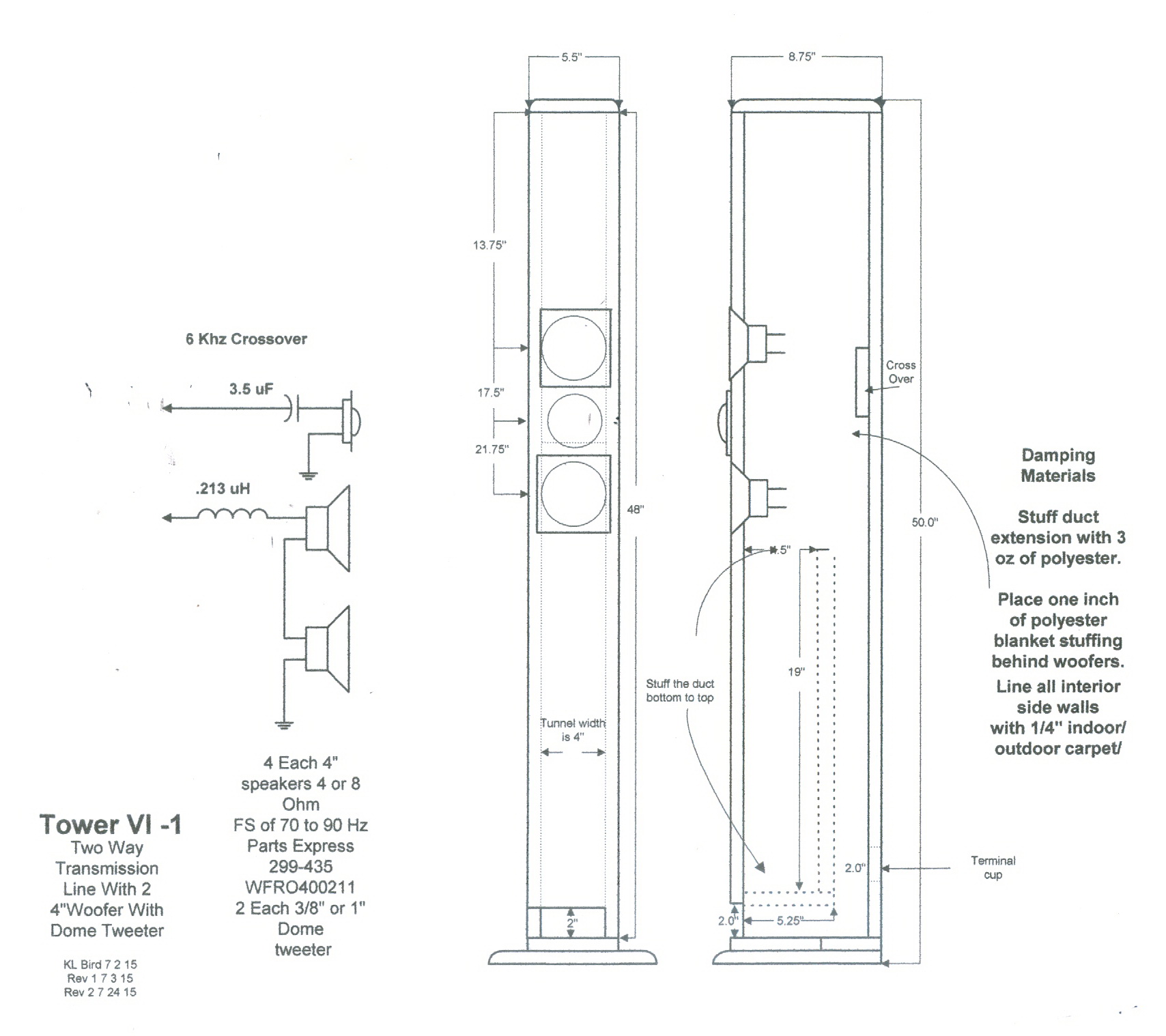

KLBirds TL speaker
Hello everyone.
In the post No:1348 of this thread Ken Bird shared his project of TL speaker.
Has anyone tried or simulated the KLBIrd´s project? What is your opinion?
As far as I´ve "fallen in love with" the ribbon tweeters I would like to use the ribbon´s capability to enreach the output in higher frq levels of the TL speakers.
I am considering to use the MTM configuration (the tweeter in the seperated chamber) of TL speaker similar/the same kind as KLBIrd made. Again attached in my post.
The considered tweeter is Fountek Neo CD1 NeoCD1.0
The fullrangers would be pair of following frequently mentioned TB drivers W4-1320SJ (QTS=0,35,Fs=75Hz, Xmax=3mm) W4-1320SJ - 4" Paper Full Range - TB SPEAKER CO., LTD.
or
W4-1052SD (Qts=0.44, Fs=70Hz,Xmax=3,4mm) W4-1052SD - 4" PP Full Range - TB SPEAKER CO., LTD.
or never mentioned in this thread
W4-654SE (Qts=0.43, Fs=65Hz, Xmax=4,15mm))W4-654SE - 4" Paper Cone / Full Range, Woofer - TB SPEAKER CO., LTD.
Do you think would it be feasable to go this way? And finally be happy when listening the music?
If the idea is OKey which of listed FRs you think is the best option?
Thanks a lot in advance.
Jan

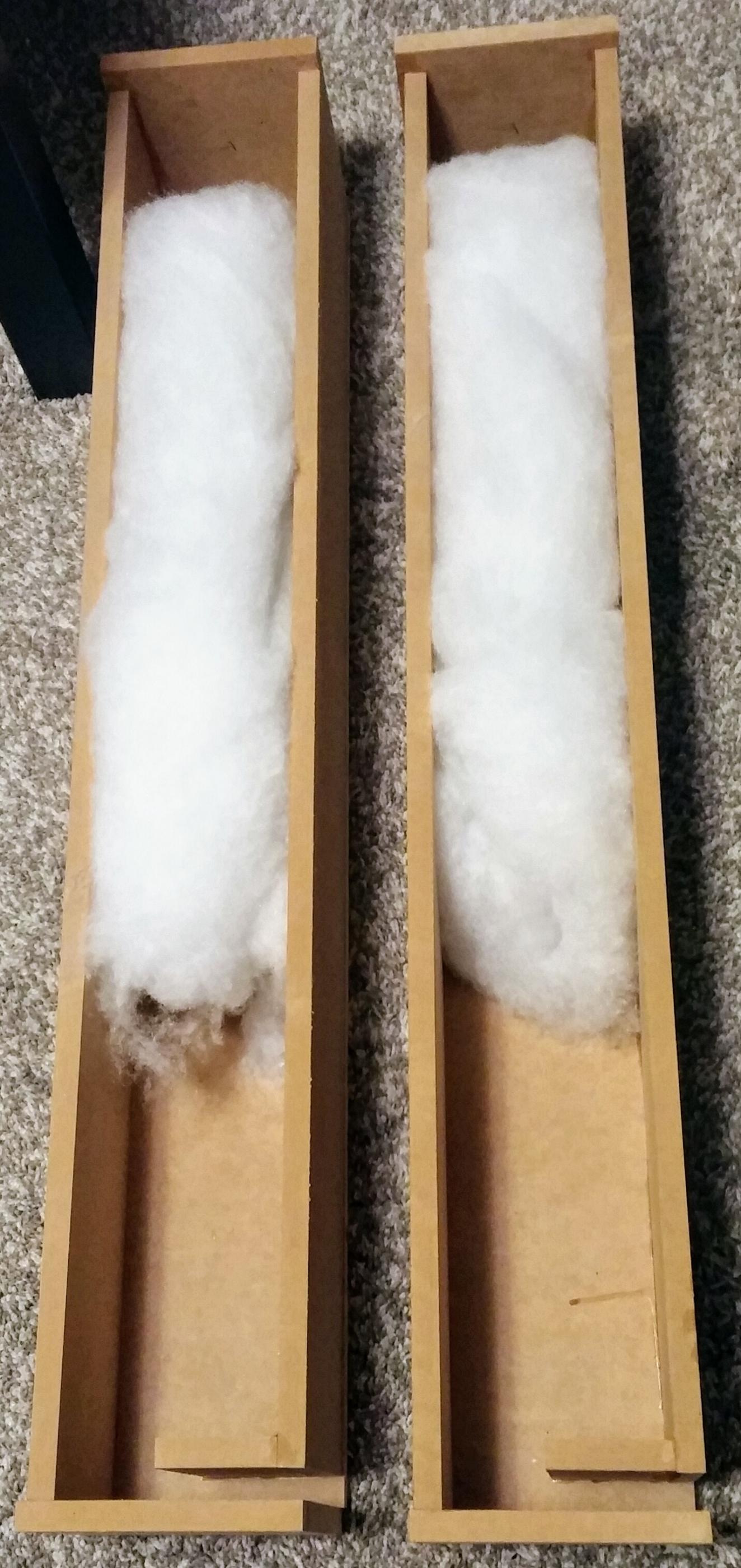

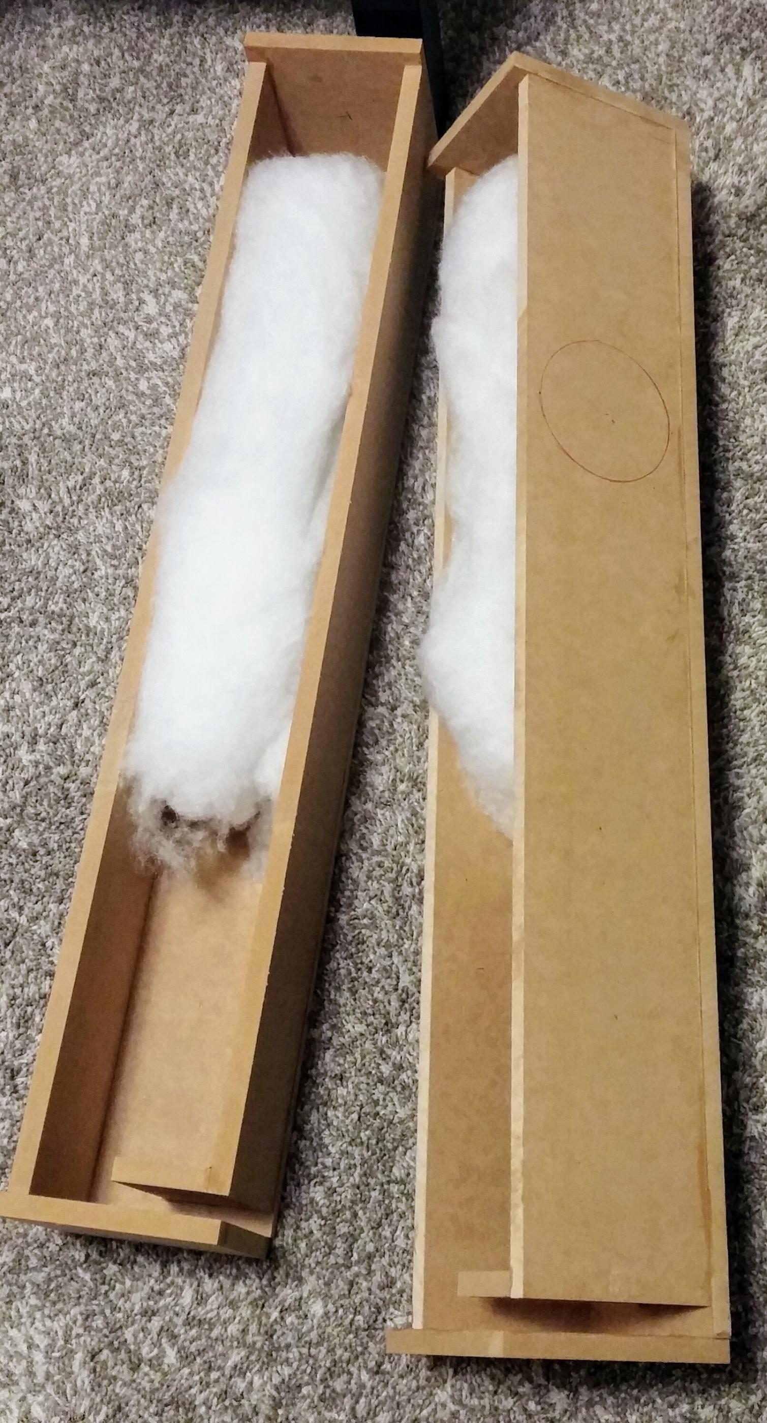

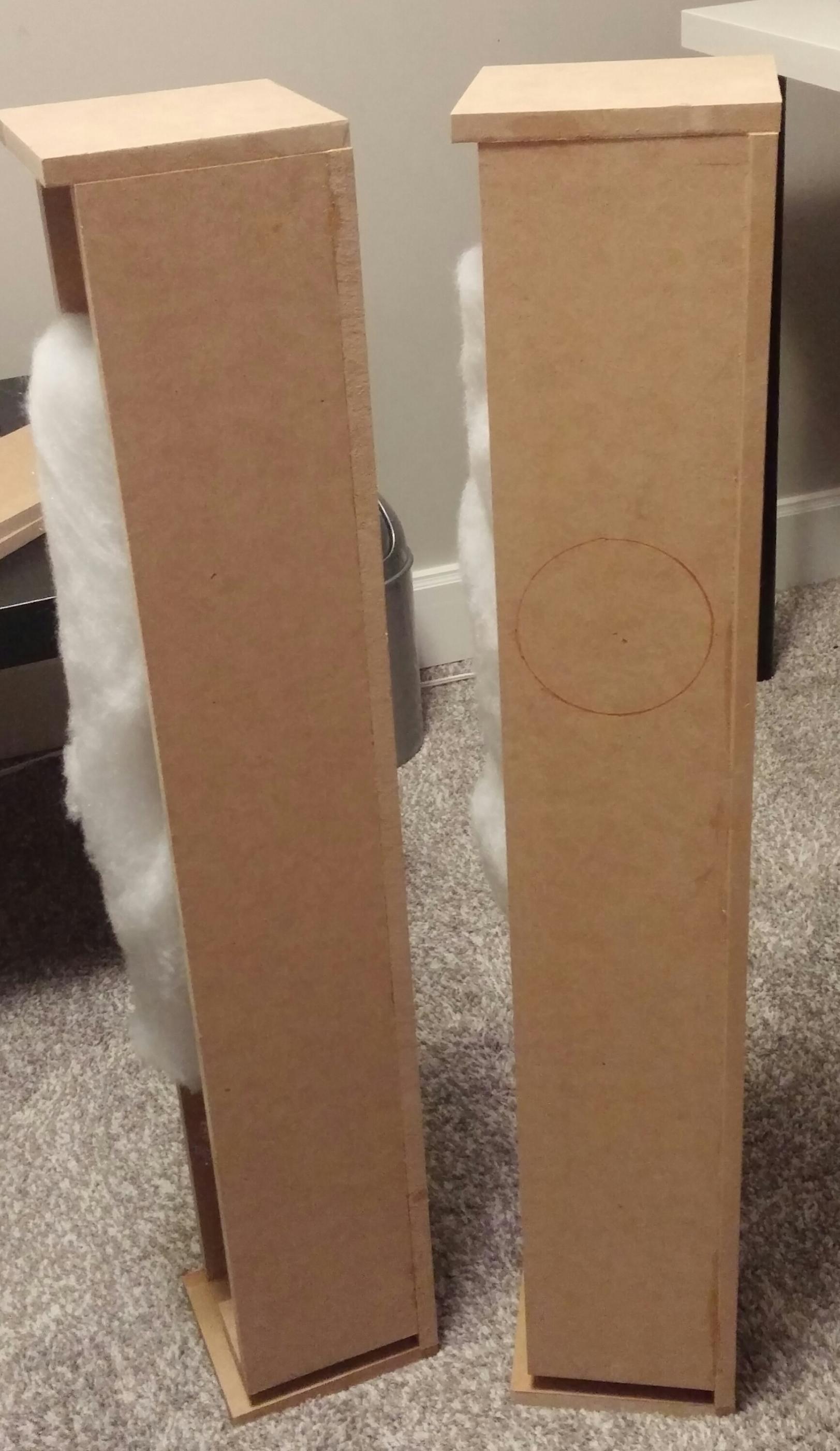

I knocked my Tabaq's together today, but my drivers and stuff won't be here until next week. They're a bit rough, but good enough for a first experiment. (I've only 'built' OB's up to this point)
Driver will be the W4-1052SD.
