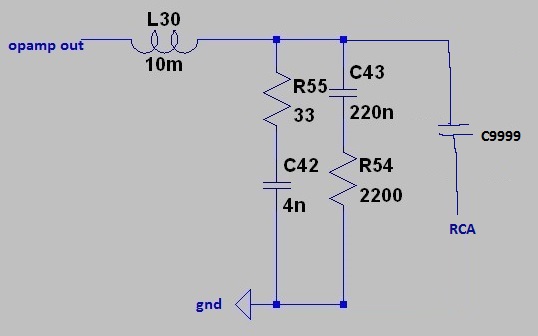

I put a cap in series with the RCA connectors, and now the effect I described in the previous post is gone. Also I feel better about my speakers.
I tossed the original DC-blocking caps, and forgot to take note of their value. I replaced with 1uF, because that's what I have on hand. Does the cap value affect the NOS droop filter? And either way, is there an ideal value for this cap? I can't help but think the bass is a bit diminished now, though I'm going from aural memory, which isn't terribly reliable. I want to say the original caps were 2.2uF, but I wouldn't swear to it.
FYI, I updated the diagram. I labeled the DC-blocking cap "C9999".

At last I've gotten around to your filter request Matthieu
It turns out to be a very simple change. Since the 2200ohm resistor (in series with 220nF) is providing the damping effect and fitting a 10k load (as against 50k originally) means more damping comes from the load, the 2200R just needs increasing a little. Changing it to 2.7k does the trick - no other changes needed.

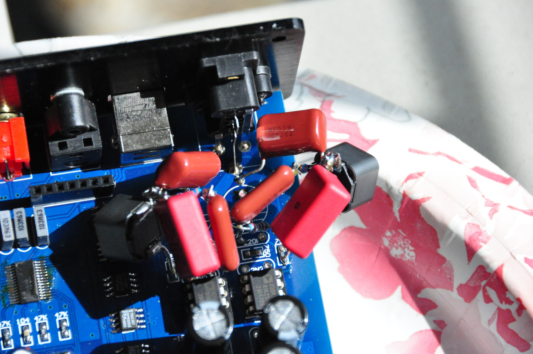

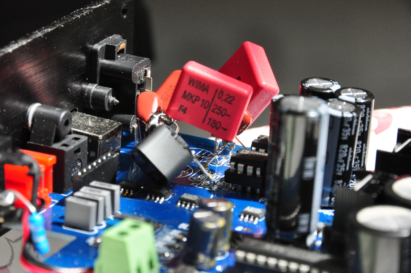

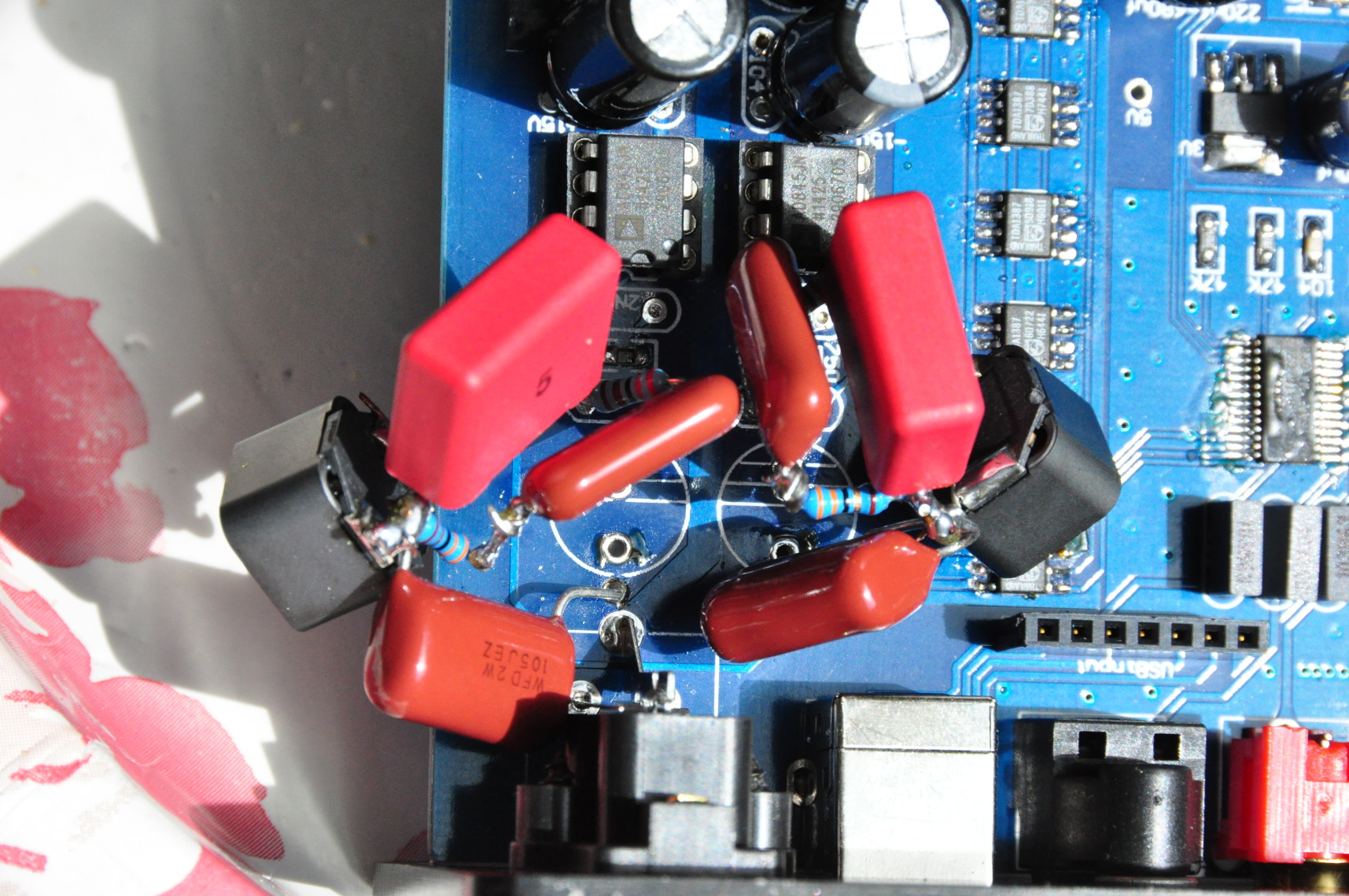

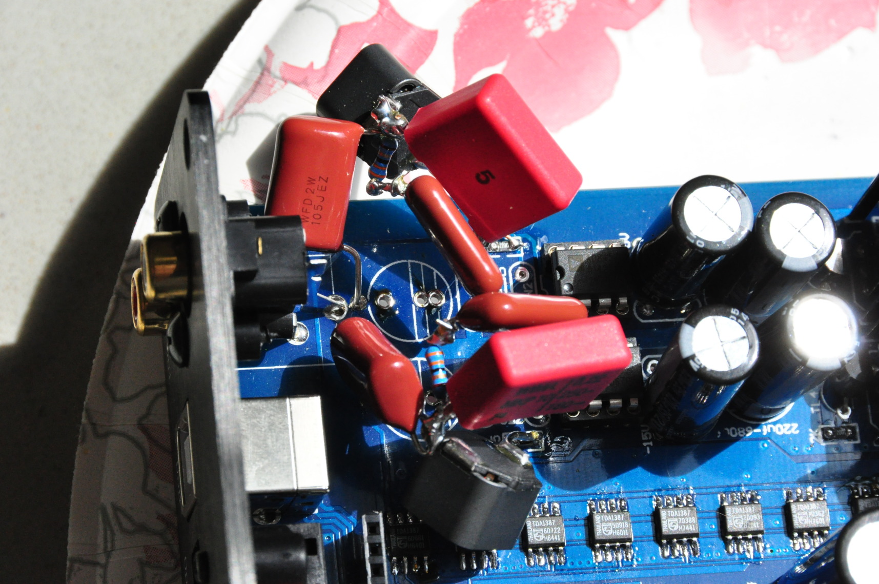

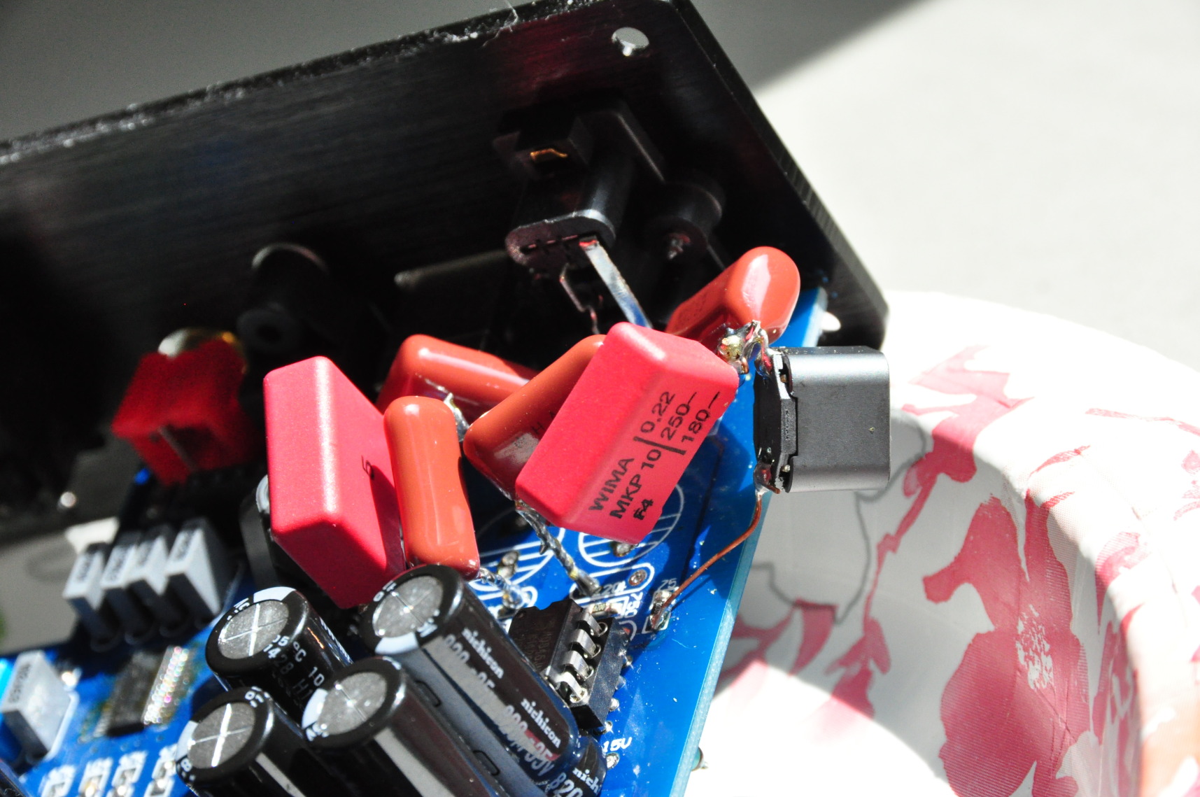

NOS Droop Filter pics
Here's some pics of my NOS Droop filter. Sorry for the "dramatic" lighting, I was using the morning sun coming in through the window. Should have added the flash.
I also meant to take pics before soldering them to the PCB, but forgot. I think it's harder to see all the connections when they are in "air sculpture" form. But hopefully someone will get some value out of these pics.
Note I have a capacitor in series with the RCA connectors for DC-blocking.

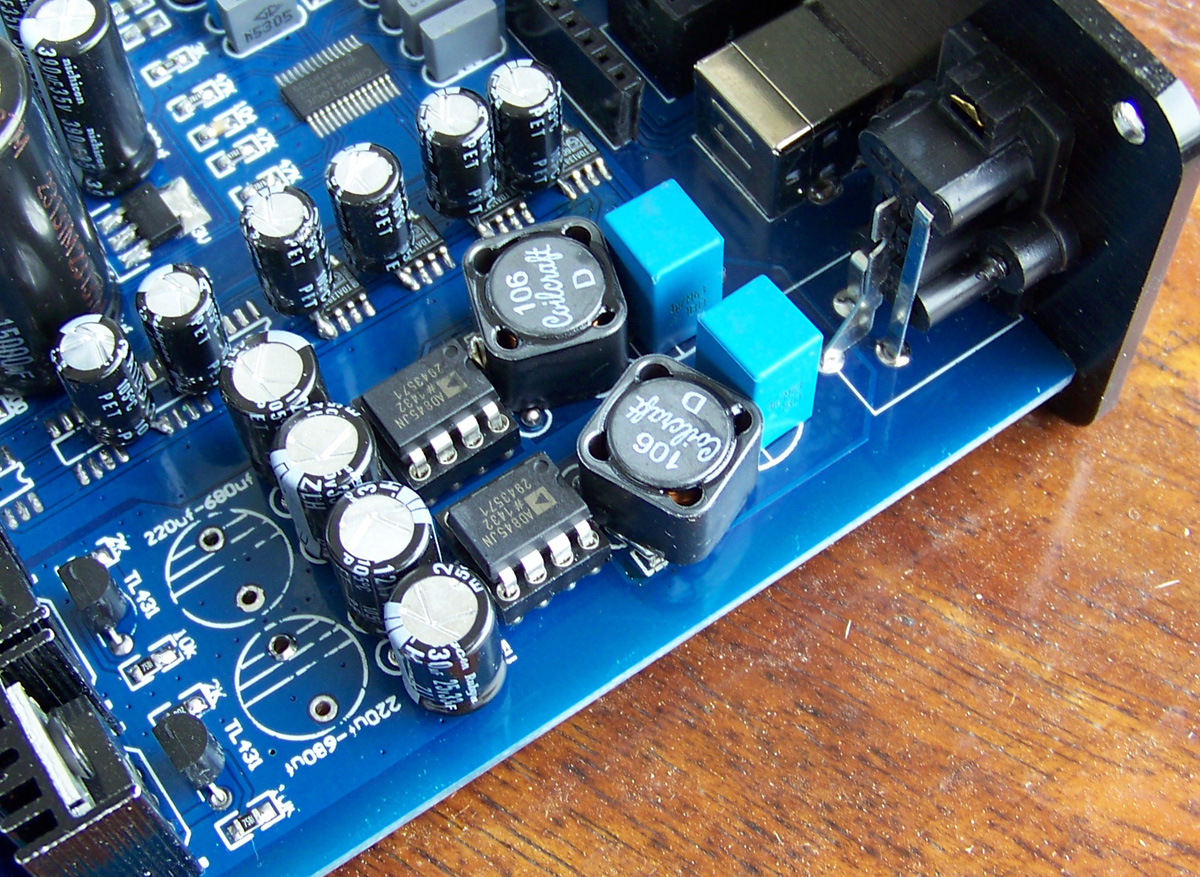

My take on that filter with abraxalito's values for my 10K preamp.

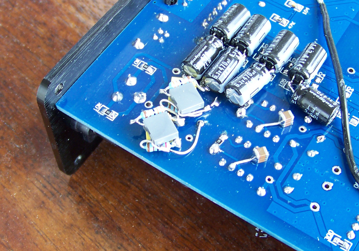

Gone quite far on messing the board, borken two tiny solder pads, first attempt I've made a short with one coil and these RCs barley fit (as caps) under the PCB. It's in and I'm scared to re-open the case... BTW, enough for me now on that gear but the AD844 to try. Will report my feelings about sound soon. Enjoying yours Matt?
Nice work fitting the filters on the bottom of the board. When I added the transistors for biasing the opamps into classA, I gave up any chance of ever getting my board back in the case. Now the "naked" PCB just sits on my desk, upside down (which makes my DAC supply cap "load bearing", since it's one of the tallest).
Looks like you also pulled half your DAC chips. Did you find that to be an improvement?
