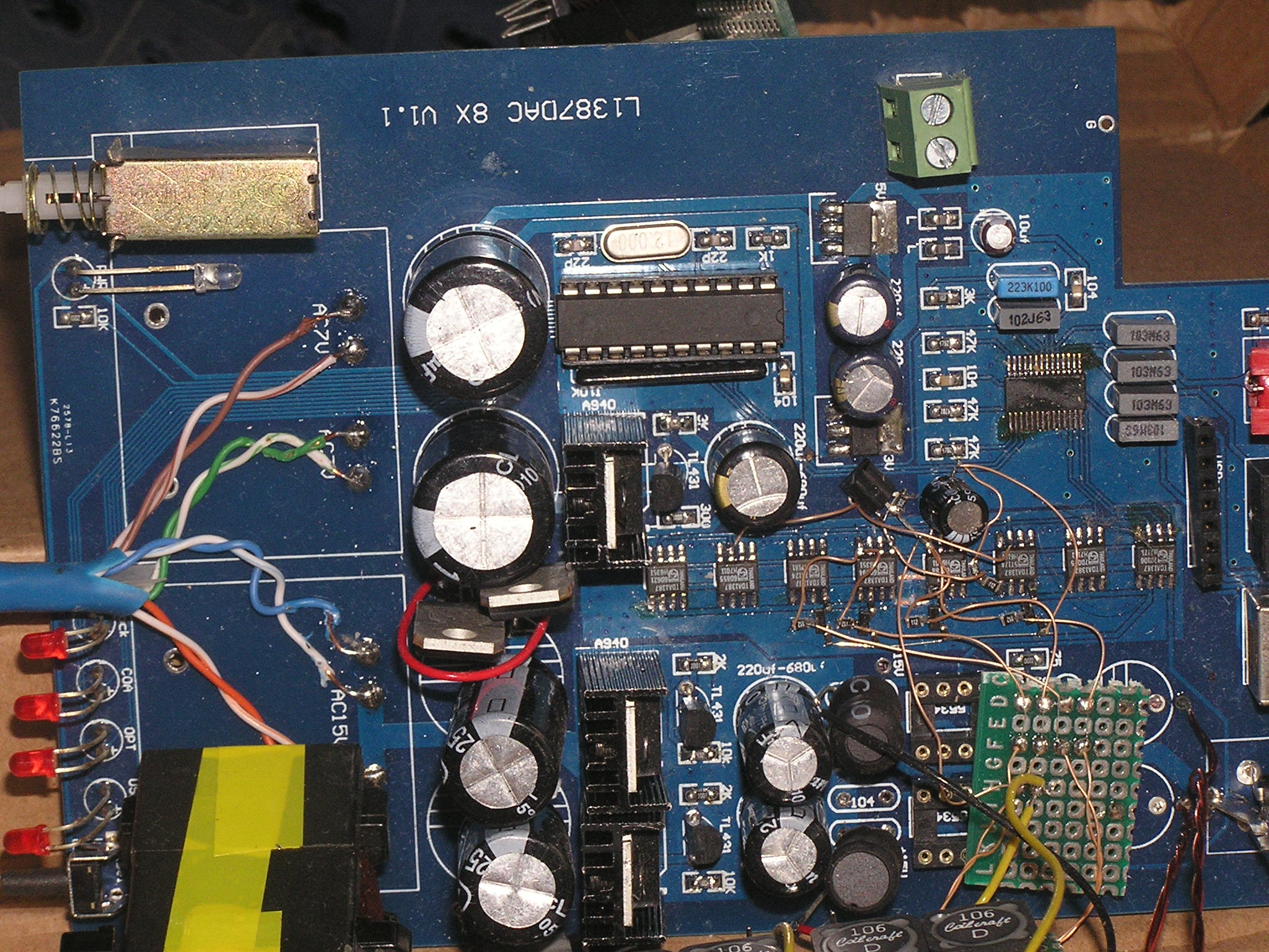

Now the problems (I wish it worked at first, but no, it does not and that annoys me to death).
First I have a 50hz hum on the left channel, never mind the opamp. How that can be on one channel as the two share the same supplies? The case or something? It is too loud for me to listen to this DAC, organ works are unlistenable.
- any way to remove it? I must remove it. And I have no idea of were it can come from :’( Ground loop? Where sould I cut?
Second, after a listening time of rock at moderate level I went to gentle music and noticed that the right channel’s LT1028 crackled. Digital silence shown no noise at all. But record's silence are terrible! Being scared that my precccciousssssss gears will vanish in smoke I’ve turned all off. My hand on the DACs’ case found it very hot. After a while I've moved both LT1028s to other channels. The same, very quicly the noises are on the right channel, so not an IC. AD844 back then: dead silent (but the 50hz hum of course). LT1028 back? Noises on the right channel. Now AD844 are in, boring but working.
- is a channel, not the other, just one, able to upset only the LT2018 opamp? Is it even possible? Or, even if the FM birdies when no-cap are gone, it still is oscillating on that right channel? Why? Worth trying the DIP package I have? (and sadly no more 47pF caps, so larger polystyrene 100pf and no compensating cap).
I’m lost, I was so happy with that LT1028 sound but that hum and worst the right channel’s rice frying noise… ='(
help!

Another random thought: my tda1387 8x DAC has displayed unusual single-channel degradation on a couple occasions. One was when I think I shorted something when sliding the card back into the case. Not sure if that's the real reason, but when I more carefully re-seated the card, the problem went away. The other instance was when the mains cable wasn't fully seated. (And in hindsight, the first problem could have also been caused by the AC cable too I suppose.)
The only other thing: looking at your picture where you re-routed the RCA grounds: it looks like me like you scraped away the PCB laminate to expose the grounding layer, and soldered to that? Any chance that was a poorly-chosen location? (Just a random guess here, don't take it the wrong way!)

I suggest you change your LT1028s to LT1128s as the former isn't unity gain stable. Hence oscillation when used for I/V purposes. The 10pF capacitor you mention doesn't look to be sufficient to get stability in this application.

Thanks for the prod - as a result I've at last gotten around to the promised photoshoot and here's the first pic. I'll draw up some schematics by hand based on the pics, just to be certain y'all get diagrams based on what does actually work in practice
The discrete I/V stages can be seen just underneath the row of DAC chips. The I/V resistors I have are 1.1k (marked 112) and they're soldered directly to the collectors of the I/V transistors (BC807s) - the other side of those resistors is analog ground. The BC807 emitters go to the DAC outputs and the bases go, via ferrite beads, to a reference voltage generated by a TL431 shunt. That's in a TO92 package on the north side of the DACs and its decoupled by the 'lytic to its right (220uF). I think that I chose the reference to output around 4.5V but I'll need to check the resistor values to be sure. Incidentally the positive side of the 220uF cap isn't going to any PCB traces, its just floating above the solder mask.
<edit> On reflection I now consider those 1.1ks as overly optimistic values - probably I'm running into saturation of the I/V transistors on digital peaks, so I'll scale them back a little. Ah no - scratch that - I remember now that the filter impedance being fed from them is also around the same value so the AC impedance seen is about half that of the 1k1, no issue. Duh!
