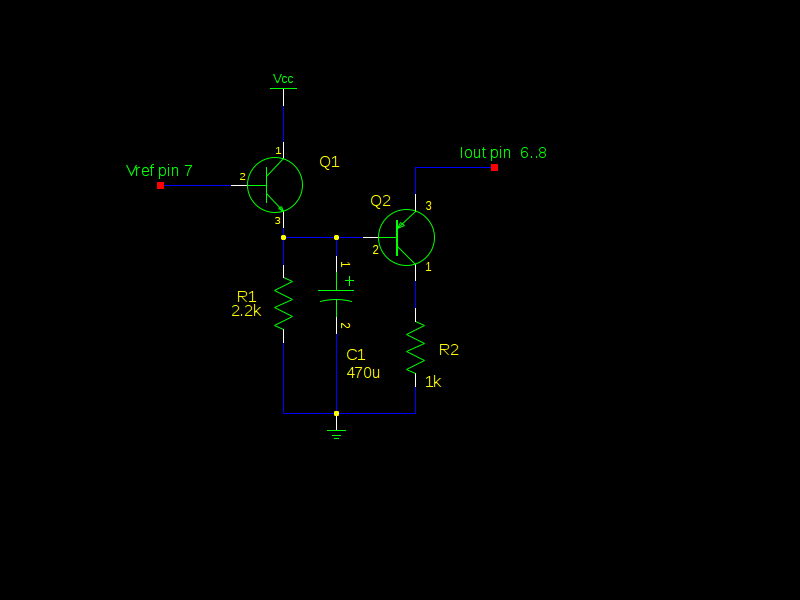

At long last here's the schematic (hand drawn as LTSpice's TL431 symbol is really confusing) for the discrete I/V modification.
Implementing the balanced outputs requires four of the BC807s (or BC327s if you're doing this non-SMT) plus associated FBs and 1k1 resistors. Only one TL431, 220uF and set of voltage setting resistors is required though - there's plenty of current available to feed the 3.8V voltage reference to 4 I/V transistors.
<edit> Incidentally I've implemented a couple more lily-gilding mods to my current DAC. First I've replaced the resistors feeding the shunts from the res caps with LM317s configured as CCSs in series with resistors for ballast. This gave a subtle improvement in bass 'weight' or definition probably as a result of having better LF PSRR with the current source. These 317s have been included on all three of the analog supplies (but not the digital). I'm also experimenting with adding biassing current sources to the I/V transistors which I'll talk about if there's any interest in that.
Can i use this for single TDA1387?
Yeah you can though you'll probably want to increase the I/V resistor (currently 1k1) by a factor of 2 (if you're not using the passive filter) or 4 (if you plan a passive filter with 39mH inductors).

Very interesting your scheme you use the dac as a current source for emitter but
way you don’t use the reference pin ?
The reference pin isn't used as a reference for the transistor that's right. It doesn't give the correct voltage. To get the highest swing I've set the reference voltage (3.8V) for the transistors as high as possible within the output compliance spec of the 1387 (up to 4.5V on a 6V supply).
An alternative
A connection like a NPN BJT with the base connected to the reference voltage of your TDA1387 and a Resistor connected from emitter to the GND.
The output on emitter Vout Ref is lower by a one Vbe
Not quite ...
If you're getting highest performance for YOUR project at some ad hoc Vref of your choice, you're most likely SERIOUSLY compromised somewhere else in your DACs topology. Find n' fix those ... then come back to Vref PER DATASHEET SPECS.
Uh... not quite... the datasheet value for Vref is optimal. Philips didn't just toss off a convenient value for the sake of what most manufs (SoundBlaster, etc.) would use. They OPTIMIZED the 1387/1545A for the pwr/voltage/current available via commercial regulators.The reference pin isn't used as a reference for the transistor that's right. It doesn't give the correct voltage. To get the highest swing I've set the reference voltage (3.8V) for the transistors as high as possible within the output compliance spec of the 1387 (up to 4.5V on a 6V supply).
This circuit doesn't suit my needs because the Vref for TDA1387 is roughly one sixth of the supply voltage. In this case that's 1V - after buffering with an NPN EF that becomes 0.4V meaning the I/V transistor goes into saturation unless its output swing is below 100mV or so. Far too low an output voltage range for my needs.
errata corrige
Yes i have made a mistake this works well with TDA1543 and TDA1545 .
Ok the output of tda1387 is a strange output ....., now i have read well the data sheet...the I/V stage have reference to ground .
If you connect my stage to the gnd as reference and a -6V on emitter Resistor of the first NPN it can work ?
