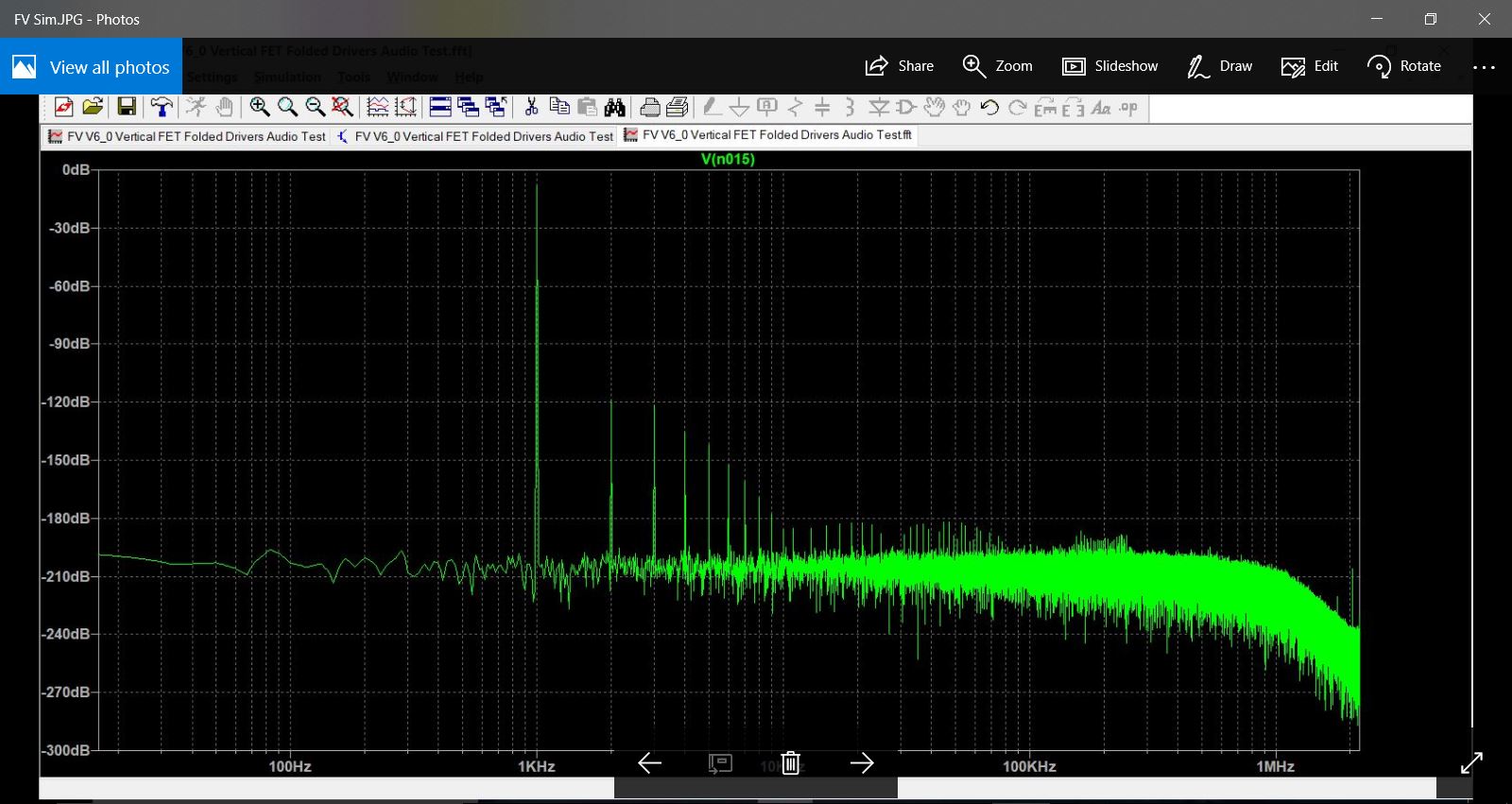

Whoa ! Now that sounds just like a chronically under biased output stage with a large discontinuity around the crossover point.
This is really interesting with regard to the Texan and it seems as though this distortion could be a characteristic.
I've repeated the pure tone test with a simulation of my amp and I don't see anything like we are seeing with the Texan, which seems to show the simulation is possibly more accurate than we would have suspected. It really does seem to be adding all this junk on its own.
Creating a .wav from the simulation of my amp shows 'zero' artefacts of the kind we have seen above when I view it in Audacity which is like a double proof the idea works. So the PC isn't adding anything of its own to this.
All the artefacts you show from my Texan files, I see even using Audacity. Its bad :D

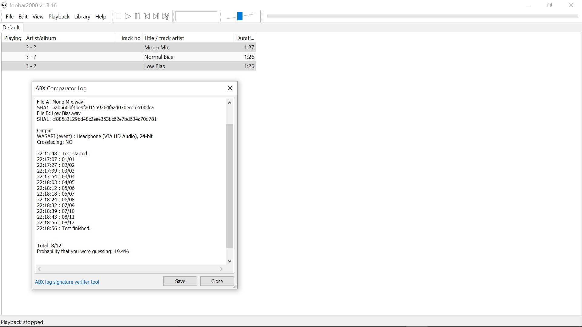

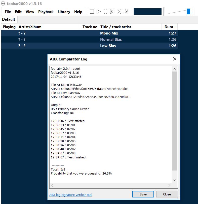

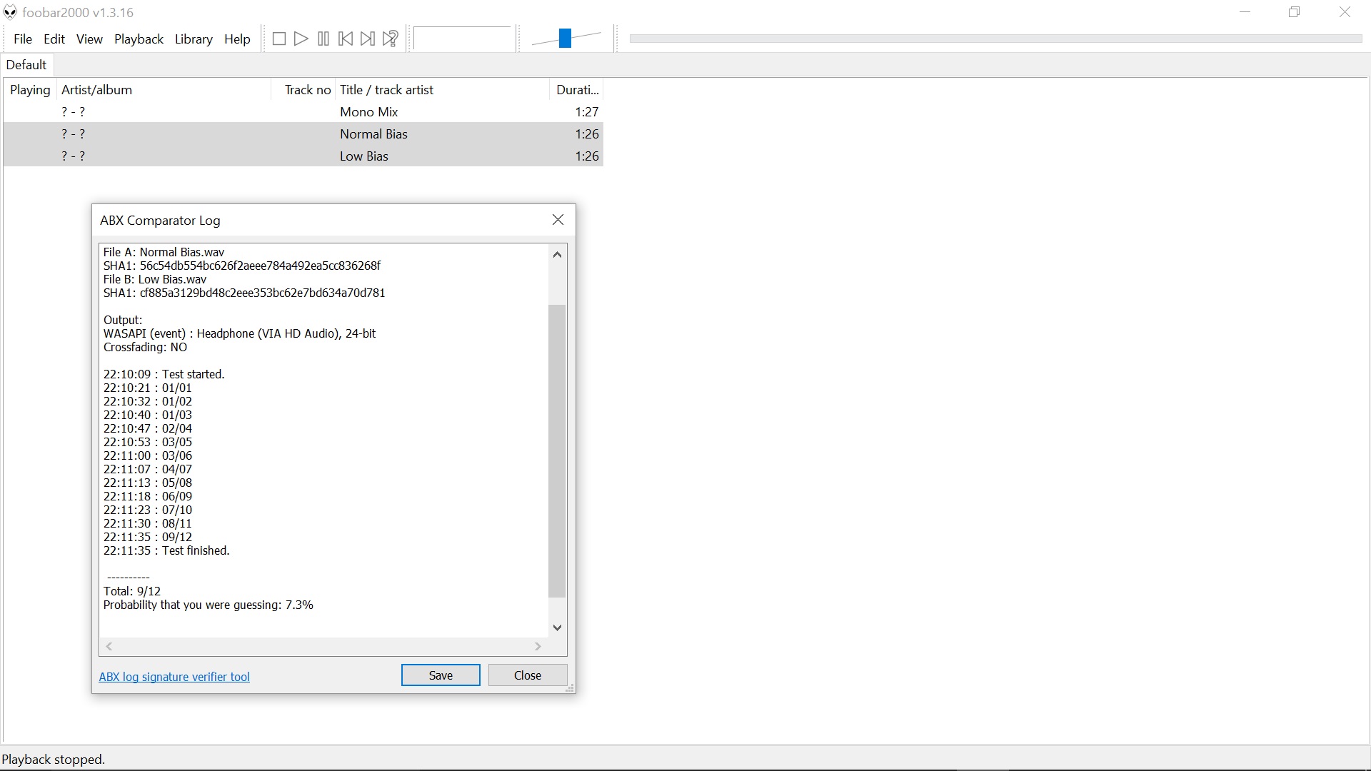

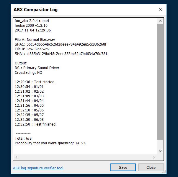

These were two consecutive runs, nothing discarded in between. Laptop and headphones for this one.
Impossible to discern to me too.
With the tone track was very easy but not with music.
When I know the track is playing I'm sure which is which but when I run the ABX test I fail.

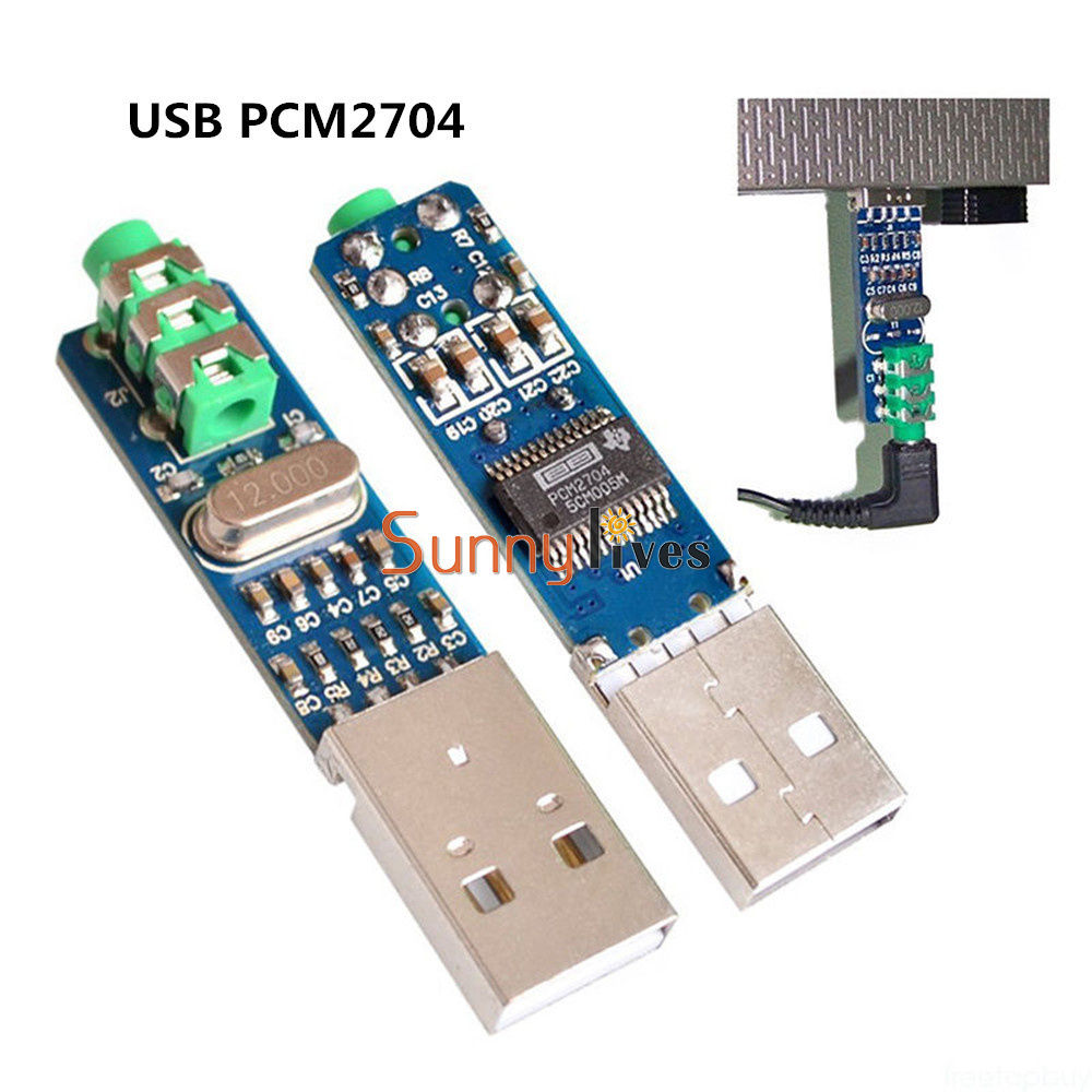

$5.00 USB dac plugged into Laptop > El cheapo 3.5mm-2RCA cable > Yamaha receiver > Stax electrostatic heaqdphones.
