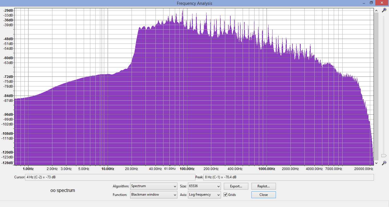

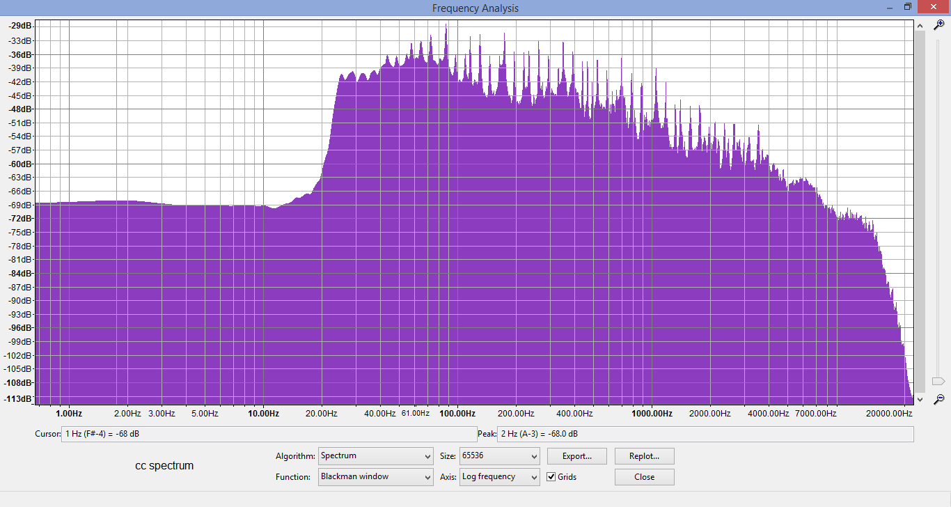

Yes 😀. And the guys could have found which file is original and which is recorded quite easily even with Audacity. The non-original, recorded file has infra-sound roll off due to ac coupling in the audio chain. The amp used has 1uF/33kohm input coupling cap/input resistor. This makes 4.8 Hz LF roll-off. See the attached Audacity plots. (Sorry for different Y scales, Audacity is just Audacity. But one can read from Y-axis the dB and compare)

All that said, I understand that the recorded file may sound more pleasing to someone. All I wanted to get is the proof that the files were really discerned. I am not offending anyone, I just want to make understand that the brain sound evaluation is a complex process and we may be unintentionally biased and fooled by our brain.
