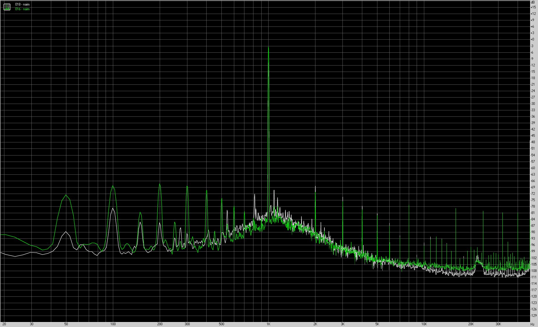

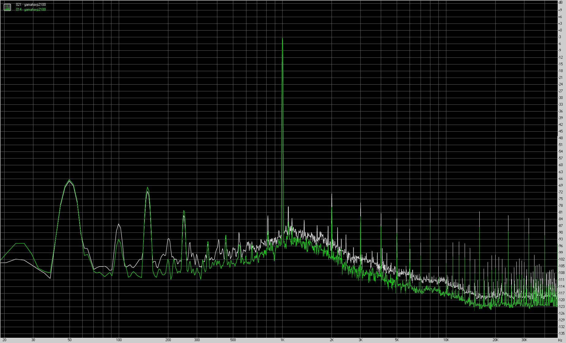

Good time. I read with interest this thread of the forum. One acquaintance took the spectra of distortions from his clone NAP140(1К+22К) + NAC, and compared it with the spectra of the Yamaha amplifier P2100. White color indicates measurements with the equivalent load on the amplifier output. In my opinion - the spectra are similar, according to the distribution of harmonics, in the main points, except for a slight difference in the levels...
It was very interesting to see the spectrum of this complete set from NAIM, so I myself own such a system. I apologize for the inaccuracy of the Google translation.
Nicholas.
Nicholas.

Nice data Nikola. I think there are some differences between the green and the white traces but I don't know how important they are. Do these amplifiers sound similar ?
