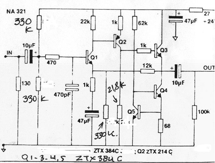

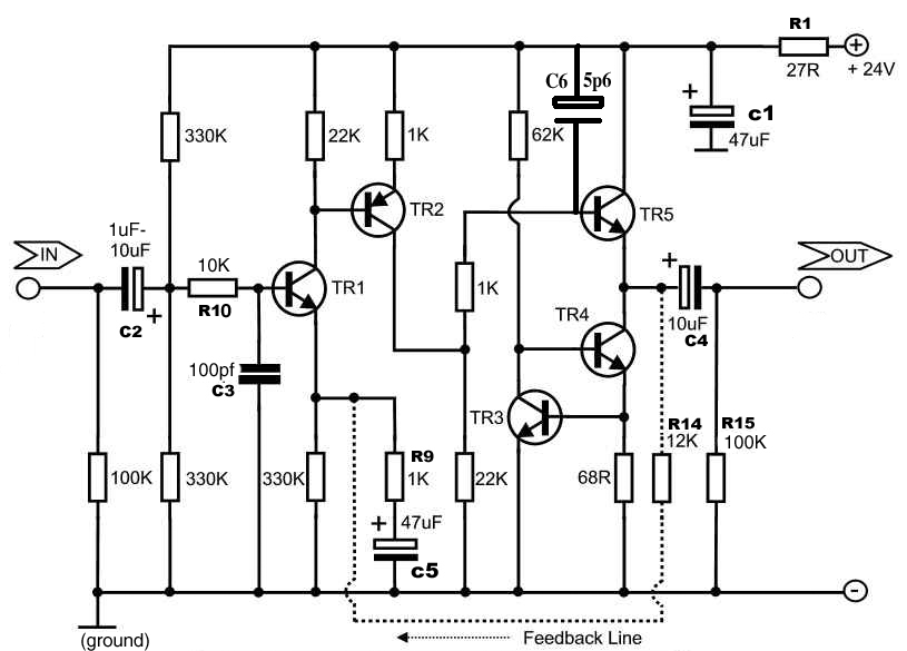

Whilst the NAP200 power amplifier referred to is a similar electrical design to NAP140, I think its recommened preamp is the later model NAC152X. The NAP140 matching preamp is the NAC 32.5 or alternatively, NAC 42.5. Of course, any type will work OK, but if you are looking to polish the overall response flatness and sound quality authentically, these are the recommended combinations. The source of the images, Ced. Taylor by courtesy of acoustica.org.uk, refers to the differences between the preamp models only as HF filtering with no suggestion that there is any compensating boost in the amplifiers. I can't see any evidence of it either.....This is part of the circuit with 5-transistors with a gain of about 10. The first part of the circuit is a high-pass filter (outside the audio range). You can delete this part of the schema....
Early NAC 32.5 Gainboard schematic:
![321_gain_board_schematic.jpg](/community/proxy.php?image=http%3A%2F%2Fwww.acoustica.org.uk%2Ft%2Fnaim%2Fpreamp_pics%2F321_gain_board_schematic.jpg&hash=90bc530feba1f4106106d51fd93bb86b)
and more recent version:
![Gain_board_schem.jpg](/community/proxy.php?image=http%3A%2F%2Fwww.acoustica.org.uk%2Ft%2Fnaim%2Fpreamp_pics%2FGain_board_schem.jpg&hash=13294460834b0d55f4a1e1408117428a)
