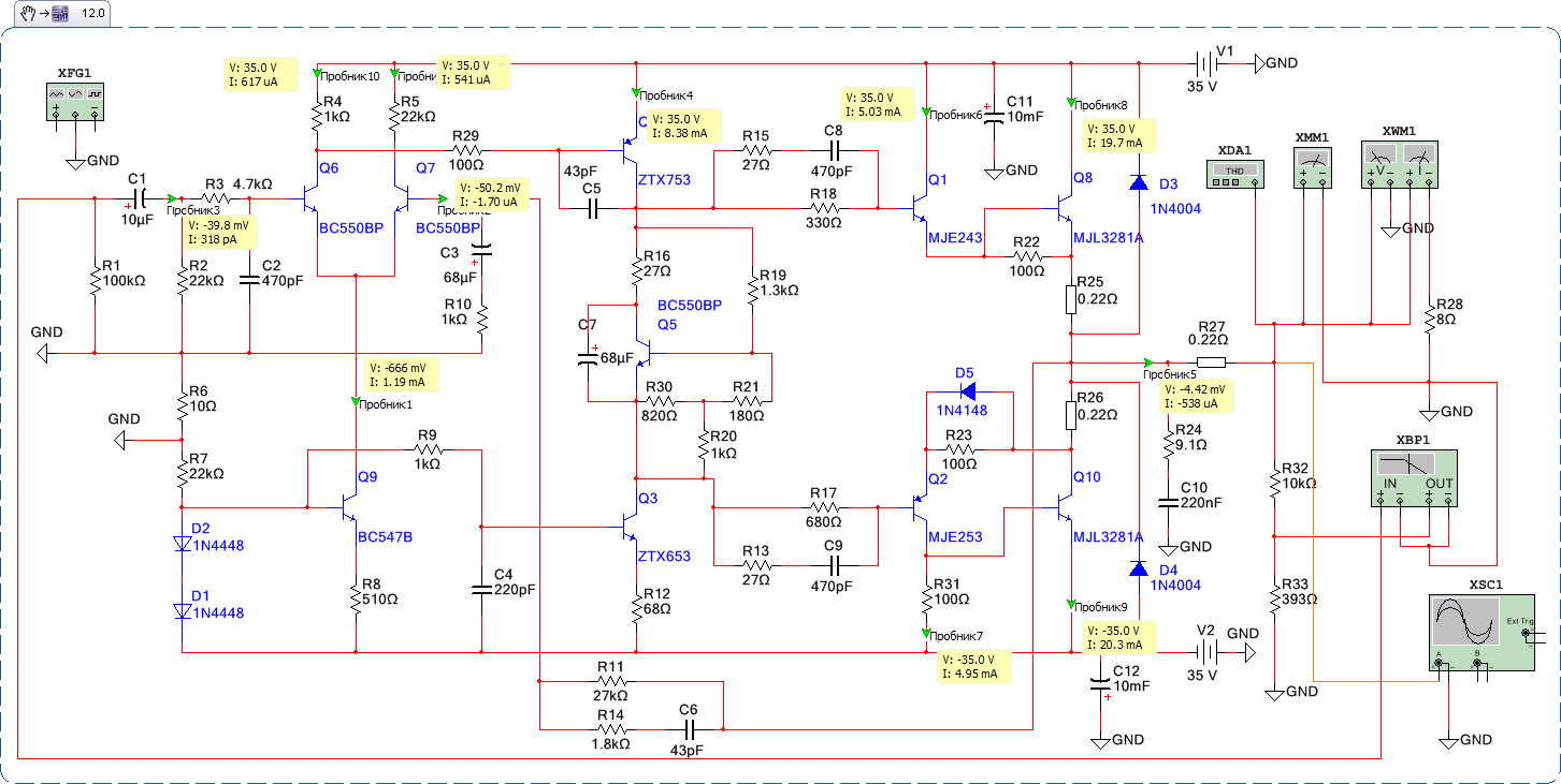

![qtHObtS.jpg](https://i.imgur.com/qtHObtS.jpg)
Funny thing that I never saw at the time. The feedback cap could be biased with a diode to it's other side. It could have a nett 0V for pennies. I said all caps shouldn't be biased. Obviously polyester can be. Even so some have memory effects and 63V polyester is not well liked.

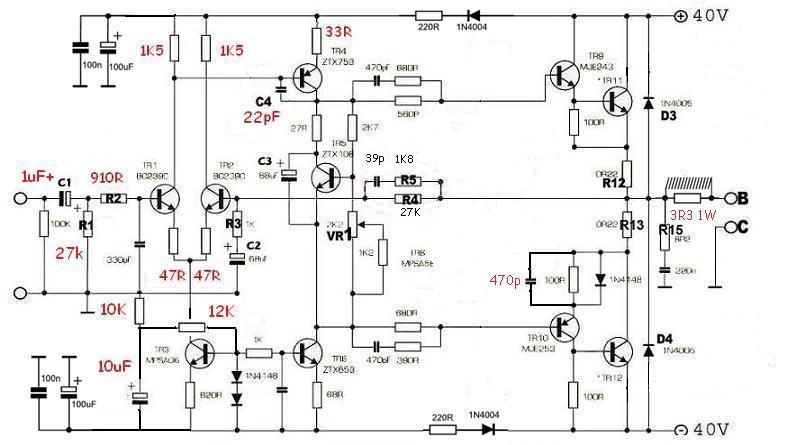

![dm9D73w.jpg](https://i.imgur.com/dm9D73w.jpg)
These version was modified by GB..
Any opinion..
It looks to be OK. The 1K5 1K5 is about right also. If we say circa 1V 1K5 that's about the same as before. Pure coincidence I put my silly JLH clone amp up. My guess is it will sound just like the other clones with better treble to use an old term.
Any opinion..
How do you like this amp, GB? Do you use the original transistors?
I would look at original 1K + 22K and 15 R to the VAS emitter. If you like that start adjusting the 1K to perhaps 1K3 and 30K. All guess work really. I have a hunch original Naim and 15R will do a bit. More of a risk is to add 1 uF to the 15R. As this amp has plenty of phase shifts goodness knows how that would go. It's mostly good book and good ear spec doing that, trying to satisfy both. It could end in smoke.
