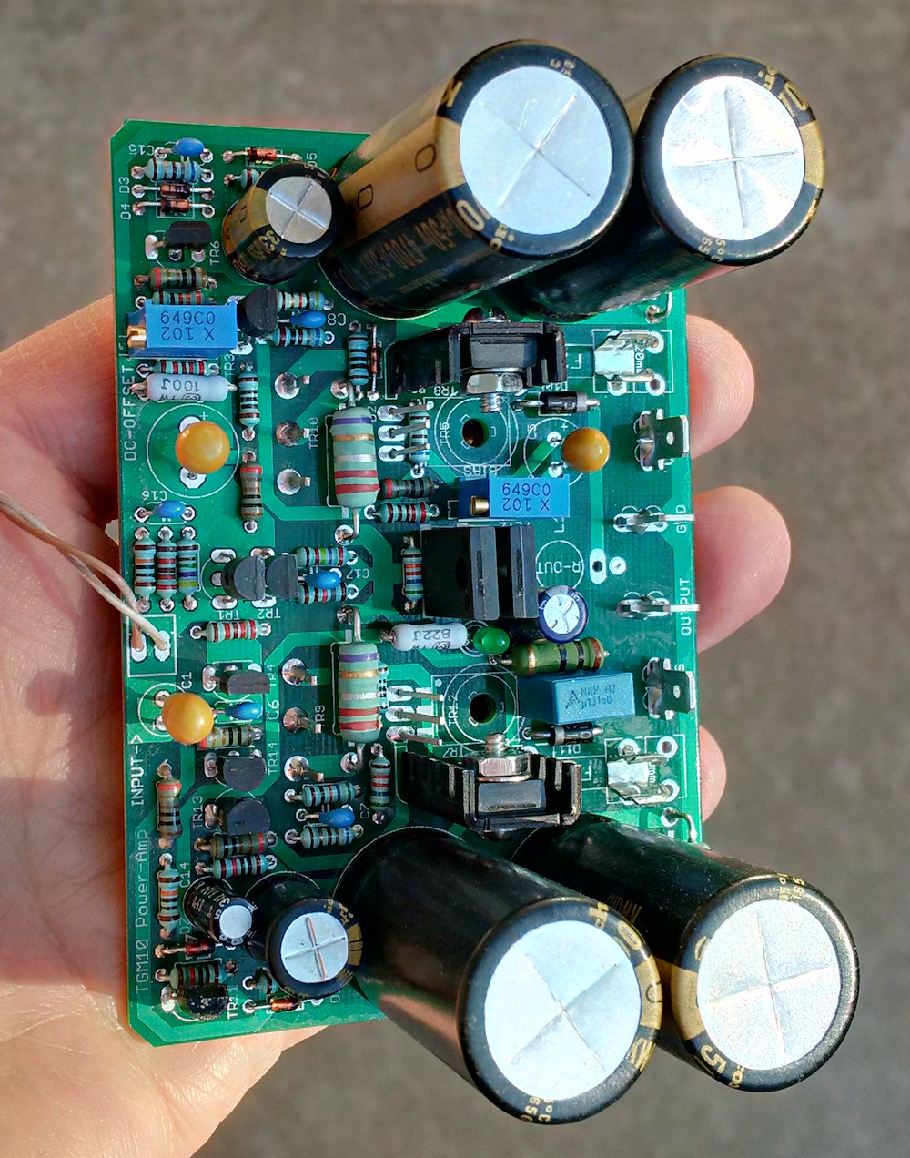

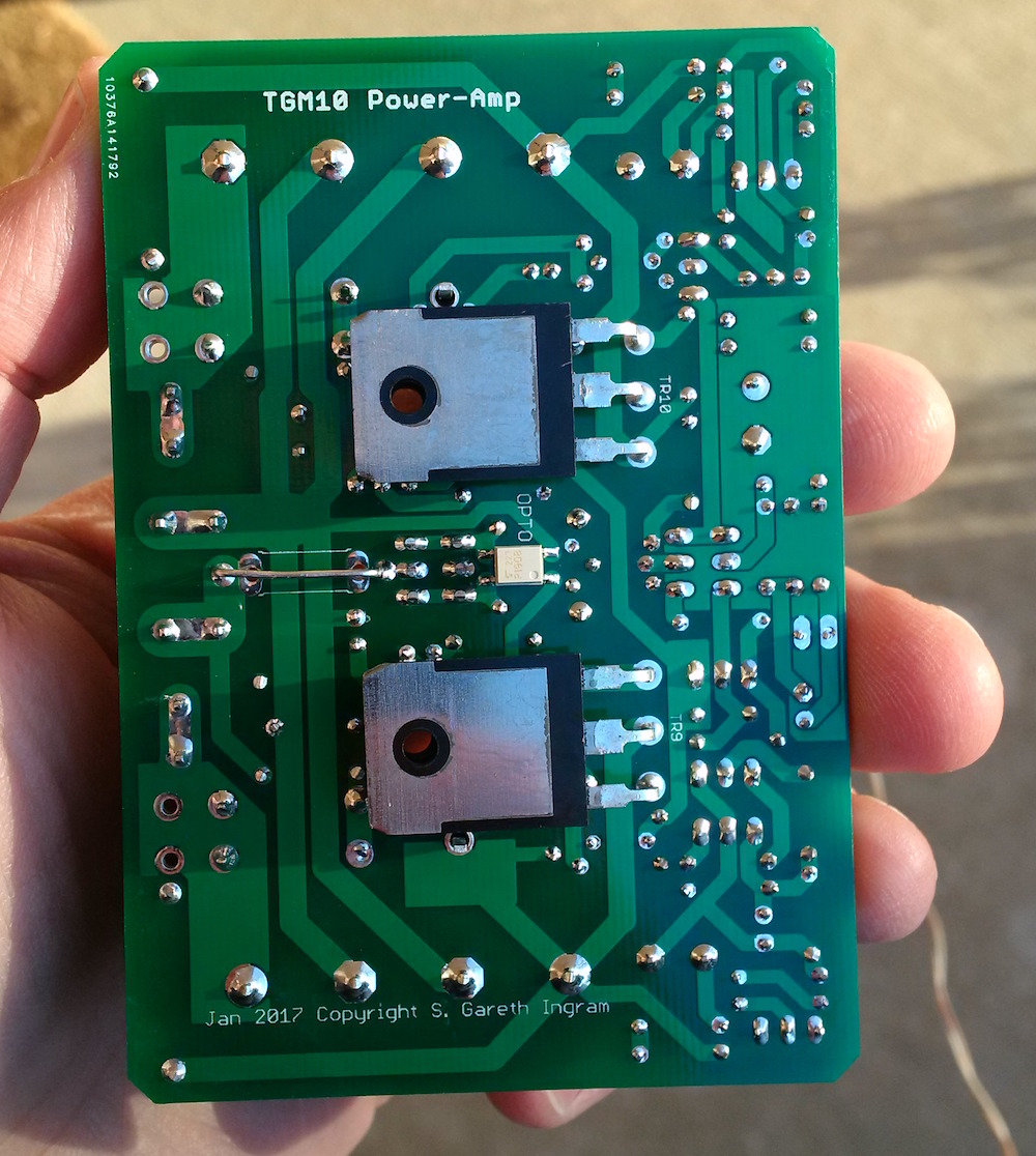

Making some progress

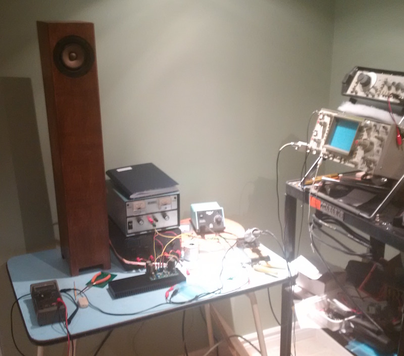

Well I have it powered up using a current-controlled bench supply. The supply is limited to +/-20V but it has some 5v taps so I've put them in series and created a current-controlled +/-25V bench top supply.
No smoke :xfingers:
It's just soaking on the bench for now to allow time for the heatsink to warm up.
Without adjusting any pots the idle current seems to be around 20mV across 0R22 which is 90mV. The power supply current meter shows 100mA per rail so there's around 10mA going through the front-end which makes good sense.
It'll take quite awhile to warm up the heatsink with only 2W dissipation per output device but I want to see if the thermal compensation is even close.
fyi - The bench top power supply voltage is too low to 'turn on' the speaker output relay. My circuit is designed to open the relay when the power rails to the output stage dip below roughly 34V (set by a zener so it can be easily changed). This is to ensure rapid disconnect on power-down.

I'm not happy with the bias and thermal compensation yet so this will have to be addressed before the o'scope gets poweres up. After an hour of soaking the bias was stable. I wired up a +/-34V supply.
BUT
a) I discovered the bias is sensitive to me blowing air on the amplifier. I've traced this to the CCS transistor. Spice simulations confirm it's relatively high sensitivity and impact on output bias current. I believe it's OK once sealed in a case but I don't like it. I am planning to place it in physical contact with the two diodes that are supposed to ensure better temperature behaviour of the CCS
Also
b) I fitted the wrong value of a resistor in the bias network that limits the range of adjustment. It'll need to be replaced.
crappy basement set-up !

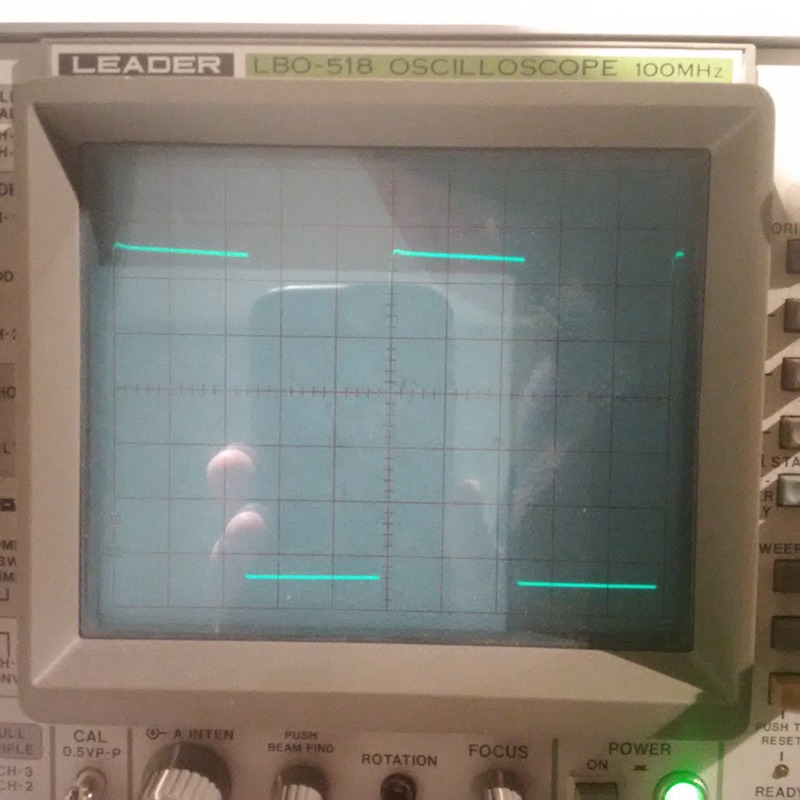

I hooked up the 'scope. Used the probe compensation test point as a signal source, gives 0.5Vpp square wave at 1kHz. It's much cleaner than my signal generator so it's my first go-to signal.
Without a load the output is clean and shows an amplifier gain of roughly x26. On first connecting it the green LED goes out and comes back on - this square wave gets the speaker protection all excited.
With a 7R5 resistive load we start to see a tiny bit of overshoot on the +ve side. I'm not using a scope probe here, just a wire into the scope input.
Of course, I had to have a quick listen. All I had to hand was a floorstander DIY speaker which I stuck on the table top and my Blackberry as a source playing Youtube. It made music (but let's not judge based on my BB - it wasn't that great). 🙂
