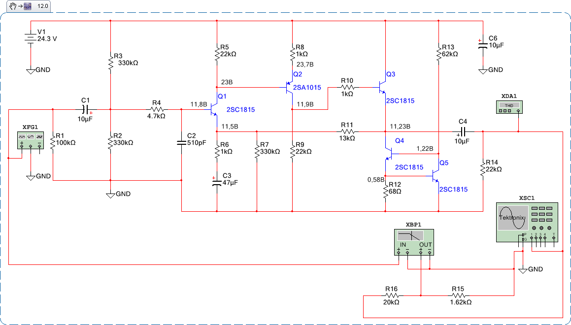

TGM10 - based on NAIM by Julian Vereker
So why not focusing on lowering the HF distortion

It's not the LTP. It is simply how much current you can pump into the VAS base. After that it is where that current goes. Ideally it joins the current in the VAS flow.
If the current gain of the transistor is high less current is needed to swing a voltage at the collector of the VAS ( effectively ).
High gain transistors are not available. If we add an emitter resistor to the VAS we make it look as if less VAS current is flowing as we have Re+re.
This idea is good to about 10% Re to Rc. If we say Rc could be a 4K ( 40 V 10 mA ) resistance that implies we wouldn't consider 400R. 10R seems mild. If we take 4000/13 = 308 or 4000/3 = 1300. It is vastly more as the CCS is perhaps 100K or more. Even with the 10R the loop gain will be in op amp country when the LTP is factored in.
Did you never think it is super lazy to make tons of loop gain then throw it away in Cdom? OK the second harmonic distortion will reduce. Surely reducing the VAS gain and reducing Cdom is better? As I said yesterday the mid band distortion might be -100 db and the emitter resistor will drop it to - 80dB ( I doubt it will ). Surely someone will see making the VAS easier to drive is more than worth a thought. It isn't strictly speaking local feedback as that disrespects how it work. It more a Robbing Peter to Pay Paul situation and you must work out who needs it most.
There is one distortion you must think of. Crossover distortion. Your only tool is to grab the output and send a horrible mirror image spike in to correct it. Some believe re-entrant distortion is made in AB amps. That is over correction makes new higher order harmonics that never were there before. Others say NO, it's the feedback loop running out of gain and pulling the stuff out of the noise floor ( I say that as they never do, where was it before ? ). Even siding with them in the noise floor is the better place for them. Like dither we can give a type of linearity by knowning when the job is done.
Now the crunch. When we run a repetitive waves we charge Cdom. Thus the THD improves. Some say the improvement is so dramatic as to invalidate the use of THD beliefs. If class A I would say less true as the loop only corrects device linearity. Thus until better proof is available this has a Quality value rather is a hard fact. Self says surely if these things are true then it should show up somewhere in general linearity. Not really. A pulse through the amp perhaps. A single one shot NE555 wave at 1 kHz perhaps ( ideal as it goes easilly to 19 kHz ). Making Cdom smaller with safety could make a better pulse. I will take Copyright on that idea as the method is cheap. You will need a storage scope, something cheap is OK as it is a trend rather than needing exactly shapes. Good, better, best. That surely is a test that can not lie? If not only play Kraftwerk or 8 Bit Beatles?
A VAS emitter resistor might cure fatigue at the risk of being a bit less dramatic. There might be all you want at 5R1 and 20pF. The NAP LTP makes nice harmonics already so leave it alone. That is unless you want a Denon PMA250.
I tried to find a book that covered the sweetspot of Re+re. Self's VAS buffer does seems well thought out and sort of looks at the problem.
Op amps sometimes have external Cdom pins. This has the vital Cdom inside and your Cdom outside. NE5534 being one. This is highly valued as seldom do we need a gain of 1 ( a buffer ). I think a typical example is > gain of 5 none needed.
The NAP is an op amp. We could view the capacitance of ZTX753 as the internal Cdom and the 39pF at the external Cdom.
My design process is such that I see reducing or increasing VAS gain and reducing Cdom are not design objectives. It is part of the many tools that can be used with other tools to achieve certain objectives.
To me it doesn't matter how small the Cdom is because what matters is something else that is achieved when Cdom is of certain value.
I think you have learnt from experience that in many situations, the best trade-off solution is to lower the VAS gain a little and at the end you come up with lower Cdom. But to me this is not a rule. In some cases, I think in all cases actually, collector resistor by itself is not wanted.
But in this topology lowering the VAS gain has little consequences, because you might get almost "nothing" with high VAS gain anyway. In other topology it can be different.
BTW, I have several candidate Naim clones. The one with low supply rail has no collector resistor. The higher power has 33R.
Do you know why a series resistor with Cdom can be a good thing?
The "B" part in class-AB is usually worse than Class-B. Why build class-AB if we have interest only with the "A" part of it. Why not build full class-A. I do have a candidate clone for a class-A version. But then I like JLH69 current-split topology better. :smash:

In my work with poweramps the by far biggest difference lies at n Th output stage and especially the A to B transition, FB correction of device switching is not really working well with nasty spikes as a result, I have solved the issue by simply using some of the output current to aid the bias-spread, this way I can prevent the devices from ever switching. With that I'm place I find most topologies remakebly similar sounding, regardless of how they measure
The interesting thing is that I once built two identical amplifiers except for the LTP. One was a regular LTP running at around 1mA (TGM1) and the other was a CFP LTP running at around 4mA (TGM2). The regular LTP sounded great. The CFP LTP had much better bass, generally cleaner overall thanks to the improved linearity of the error amplifier. But it had a harshness that I couldn't tame. I tried using more Cdom but that didn't address the problem - it wasn't overall loop stability. The VAS was identical in both cases, the drivers, and the power devices. Same power supply. So the VAS and the output stage are important but in the example I'm describing here it was the LTP that made all the difference in the world.
That makes Absolutely sense as it's the feedback path during switching that is most affected. There the conventional LTP does a much better job as large signals literally can pull the CFP out of region where it stuggles to correct the switching artifacts. Solve the switching and you'll hear what the amp, or you'll not hear the amp. (Yet you'll still hear the amp)
I think you got it right MiiB, I do not believe the NFB could fix the transition delay between the output devices switching. There would not be a problem if you never turned them off. You are trying to correct something that was not there in the first place.
It is easy to imagine cross-over with a single sinusoid, try and imagine the mess with a complex musical signal, none of which are harmonically related and probably resulting in harsh the sound.
MiiB, I'm not sure why the CFP would fall-down on large signals, it's generally a far more linear LTP than the regular version - which is why the bass is stronger and the sound cleaner overall ?
