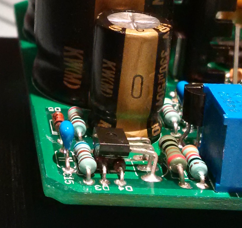

Thermal compensation
The Naim Vbe multiplier as shown in the clone schematics over-compensates the output stage thermal behaviour. By loosely coupling it, either having it dangling inside a closed box or touching part of the box, you can 'adjust' the thermal compensation sensitivity.
But the CCS is also sensitive to temperature. In a closed box the two diodes and the CCS transistor should sit inside the same ambient. But you get a more defined behaviour when you put them in physical contact with some thermal grease between them. It also provides ancillary coolling for the CCS transistor through the diodes, their leads and associated pcb trace area.
In the attached image you see how I've mounted the CCS transistor. It's bent over 90 degrees so that it can lie flat on top of the two CCS diodes.

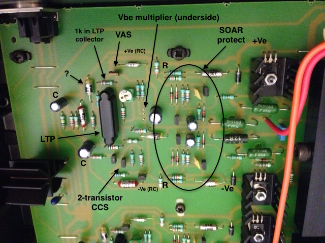

I tried to find a photo of the NAP150 that Klaus may have been referring to. And I found the attached which I've labelled up. You can see it's the familiar Naim schematic. Differences from my circuit is the inclusion of the output protection, the use of a 2-transistor CCS instead of BJT + 2 diodes.
Interestingly it looks like it has an RC decoupled + and - supply rails which is how I labelled it. But maybe not, the two capacitors labelled 'C' could be the input cap and feedback shunt cap. Not sure what's the exact detail.
The polystyrene cap that I think Klaus was curious about is labelled "?".
Those "rails" are ground lines. The LTP CCS is higher at some 3.3mA. The Cs are indeed input and fb shunt (note they are correctly polarized!). The ? cap is an extra input filter: it has 21k to gnd from the input cap, then 4.7k to a 470pF then a 1k to the ? cap. The collector resistor is 270 ohms (lower than the NAP140 1k because the LTP current is higher).I tried to find a photo of the NAP150 that Klaus may have been referring to. And I found the attached which I've labelled up. You can see it's the familiar Naim schematic. Differences from my circuit is the inclusion of the output protection, the use of a 2-transistor CCS instead of BJT + 2 diodes.
Be aware that the NAP150 it isn't meant to have the best performance: the NAP250s use better parts.
