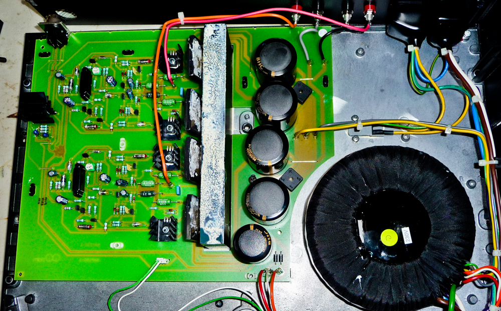

Is this nap200 cct can be found somewhere? I have a feeling that it uses fast output transistor. Then probably without driver's base compensation or much smaller than 470pf in the RC.
You can see from pics on the internet that the output transistors are MT200 package and they are the same 2SC2922 Sanken LAPTs that Naim had been fitting in many NAP models since 1989.Is this nap200 cct can be found somewhere? I have a feeling that it uses fast output transistor. Then probably without driver's base compensation or much smaller than 470pf in the RC.
You might also read this section in the Ebay clone thread for yourself, where Algar_emi has reverse-engineered the schematic from the Caowei clone kit. http://www.diyaudio.com/forums/solid-state/112453-nap-140-clone-amp-kit-ebay-218.html
Ah thx Ian. This is what Bigun should have cloned imho. With faster transistor the ULGF will normally be higher so the compensation would also work in higher frequency. The 470pf doesnt fit anymore and must be lower value. My clone uses 68pf while NAP200 uses 100pf.
NAP200 has 10pf across FB resistor, i can get away without any additional comp. there.
NAP200 has 270-5k6 on the LTP, I have 390-0 (1mA-1.2mA).
I will find the detail of the current distribution in Nap200 ltp so i can create another clone that is close to nap200 (i couldnt find all stated transistors). This way i can get the best possible sound by comparing the two.
But nah i dont think nap200 can beat mine. Some clues on the cct shows that mine is more optimal, such as lower gain, simpler compensation, etc. )

Hehe sorry i thought you are using the NAP250 compensation and operating points as shown on the first schematic and also the LTspice file which is in general for 8M output transistor.
I have found it just below the PCB picture. Around 1.9mA-1.7mA. But then i realized that cloning the clone doesnt make sense if different transistors are used (VAS & LTP). The operating points (or component values) are there to suit the chosen transistor. But i will put the ztx in my shopping list.
Also, one of the member has compared the NAP200 clone with a Nait and the clone win. So whoever said he has never found a clone that is better than original is just didnt go out far enough. It is true that popular clones are wrong but this NAP200 clone is about right.
NAP250
It seems that NAP250 is the reference in Naim lines. May be the original is so good that this is the model that is cloned the most. But when cloner keep the resistors and capitors the same while changing the transistors then they get worse amps. Dave said the Avondale is good enough. Ithink they are even using slower transistor than Naim.
I have a version intended for slow output transistors i have on hand. The compensation is almost similar to NAP250. There is something unique there that i believe is a representation of what people like about Naim sound. But other quality performance is not as good as using faster transistor. Thd is 0.02% in average, but 10kHz THD is scary. I think these represents the real old Naim sound.

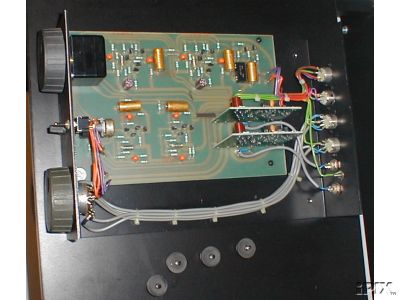

It's a good point about total Naim package. I have hunch the NAD3020 early series could do a resonable job of being a fake NAC42.
These look to be possible to use.
Assembeld NAIM NAC42 Single-ended Class A preamp / preamplifier board L1611-23 | eBay
That's a good find, Nigel. It seems the Chinese cloners have realised the ongoing demand for higher quality and closer to original design products.....url=http://www.ebay.co.uk/itm/Assembeld-NAIM-NAC42-Single-ended-Class-A-preamp-preamplifier-board-L1611-23-/112316724790?hash=item1a26993636:g:cwYAAOSwcLxYK1JV]Assembeld NAIM NAC42 Single-ended Class A preamp / preamplifier board L1611-23 | eBay[/url]
The layout is not related to the original stereo board though, which catered for phono as well as well as line level inputs. They look to have nice star point grounding but I wonder if there are issues with using a pair of these boards - apart from the obvious physical layout and the component types substituted? The attached pic is a "chrome bumper" NAC 42.5 for comparison.
Here is a silly tip for NAC 32 NAC 42 etc. If you by chance buy one make sure the rubber feet are only finger tight. For whatever reason it has a slightly better sound. This was discovered by a chap called Colin Welford who found it useful when doing demo's not to need a screwdriver to swap boards. To his surprise it sounded better. If you hit the box when playing it is slightly different also. It is heard via the speakers. This came about when I said a 32 I had sounded very flat. He said pull out the boards and put them back plus only finger tight feet. He then said it should be that the boards being cleaned up was the reason, he had doubts it was only that ( me too ). The 32 seemed more likely to do that. If I remember later preamps were hard bolted. They seemed fine! Can't remember if that was 32.5's also.
I think a MC33078 op amp would sound very like a Naim buffer. It loves a gain of one, sounds different at gain two and swings back at gain ten. It could be used with these boards. It also makes a first class MC phono stage in the Naim style. A friend has one in preference over the NAC32.5 MC cards, Hi Cap, NAP250, LP12, Troika. NE5532 sounds about the same for 5 minutes and then starts to give me fatigue. Most posh op amps sound less Naim like to me. He also has a Hi Cap with tone control from an Ex BBC guy. It really works well with a mid priced Naim CD player! That friend would prefer 0.6 mm single core ( like DNM but home made ), the NACA5 is not right for him. He won't change as he is too frightened it might blow up. The BBC Hi Cap was cheap so he took a gamble.
