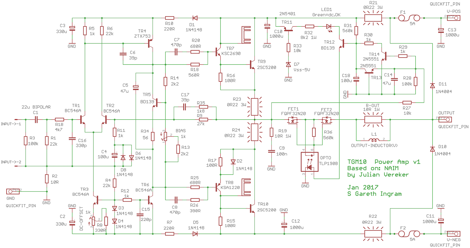

Why you need a electrical circuit C7/R20 (C10/R26)?
These different circuit C7/R20 (C8/R26) for Naim amp! Why?
I included them in my design so that the pcb had the footprint for these components. At the time I designed the pcb I thought they were important for the loop stability.
I have been thinking about these parts for awhile and I'm still not sure what their key function is for. These networks come in to play when the impedance of the capacitors becomes comparable with the series and parallel resistance - around 0.5MHz. Hence they have negligible impact on the audio frequencies.
Naim, or the designer Julian, have not published an explanation. People have theorized that these networks are designed to adjust the relative phase of the signal between the upper and lower outputs to achieve better alignment at cross-over. Two things cast doubt on this idea, firstly you wouldn't need phase shift on both upper and lower but just one of them, secondly is the negligible influence on signals at the frequency of interest. However, the unity gain bandwidth of the amplifier is quite high and good behaviour at high frequencies is still desired.
I have thought about perhaps it is to adjust for loading on the VAS, to smoothen out the impact of the output stage switching but simulations don't show much benefit.
I have thought about perhaps it is to help control minority charge carrier storage in the output drivers but cross-conduction is a concern for the output devices not the drivers.
I have thought about loop stability and I didn't find anything in simulations to suggest these networks are important. I have not explored parasitics such as inductive emitter resistors on the output devices or difficult speaker loads (Naim were into electrostatic speakers).

Thank you!I included them in my design so that the pcb had the footprint for these components. At the time I designed the pcb I thought they were important for the loop stability.
I thought this high-frequency correction. This circuit for stability of the amp, but the amp is stable without circuit C7/R20 (C8/R26).

The PNP driver transistor is a common emitter amplifier - at high frequencies NPN and PNP transistors are less of a good match and in the latter case there will be some variable Miller Effect adding to the delay.
The phase correction networks ( as Vereker described them) are not used in the low power Nait amplifiers which used the same general structure using 5 MHz fT output transistors.

I've read around quite a bit but nothing firm on the phase networks. Spice shows them to have negligible effect. But Spice does show a much stronger and clearer effect from the input filter, the output zobel and feedback phase lead.
I've yet to see a good reason for the phase networks from Spice. That leaves measurement as an option.

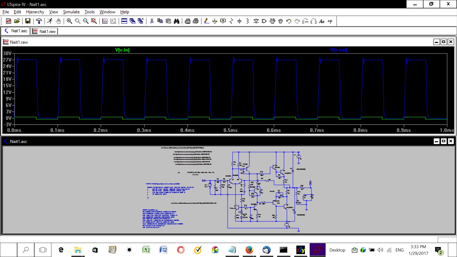

I deleted the phase networks in a reworked circuit - simulated with 10kHz square wave with output into 8 ohms with 2uF in parallel.
With MJL21194 output devices there is a continuous row of fuzz at the top and the bottom of the square wave.
With MJL3281's there is a spike at the top leading edge. Increasing the standing current by a factor of 10 effected no change. See attached.

Yes, those are ugly waveforms. Are you implying that the problem goes away when you put back the phase networks ?
Yes.
