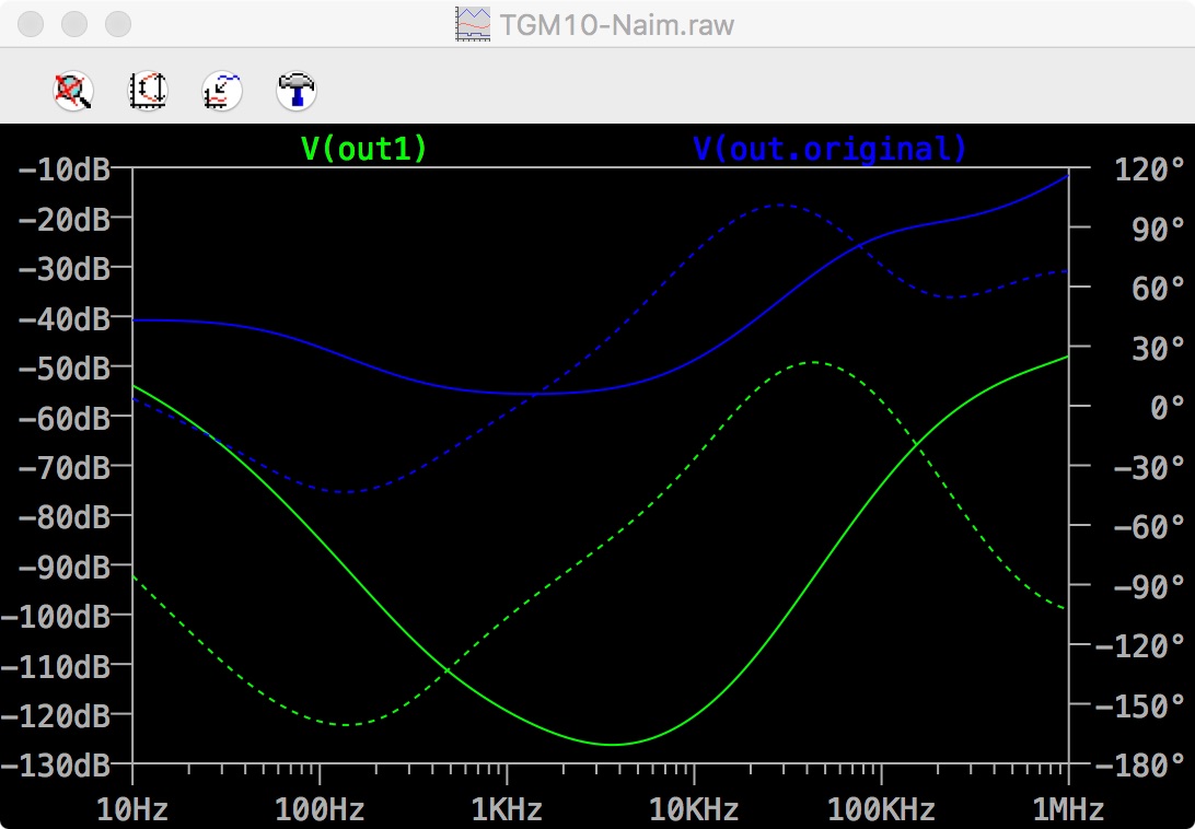

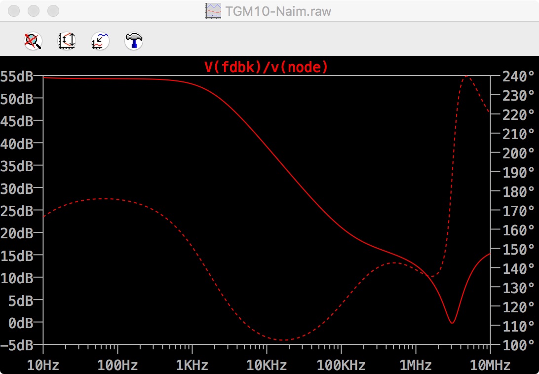

Bode Plot
This is what my simulation is saying, with voltage probe insterted into feedback loop at base of feedback transistor in LTP.
I hope you can see what it is that I'm not happy about.
Hello Gareth
Initial observations only. There is no output inductor or allowance for speaker cable inductance and R47 and R28 are missing a zero in value.
Yes, I've found that the output inductor reduces phase change at h.f. but the values of R47 and R28 (part numbers from simulation not from pcb) don't provide much benefit, more of fine tweaking. What I don't like is the bod plot does not show a nice monotonically decreasing OLG near the limit of unity gain bandwidth.

This is not the sort of plot I would expect to see. The gain values are all in the negative territory. These should start somewhere up near 120 dB positive and extend through 0 dB to -20 dB for a normal viewing window.
There's no way this type amplifier has OLG of 120dB, no way at all, I'm not sure where your expectations are coming from. You need a very different topology for those kind of gains. I think 50dB to 60dB is already pretty good (similar to AKSA amplifier by the way). You can push it up to 80dB with an EF buffer on the VAS. Of course, the Sziklai lower-output has local feedback, probably around 40dB but we don't 'see' that in the main loop.
