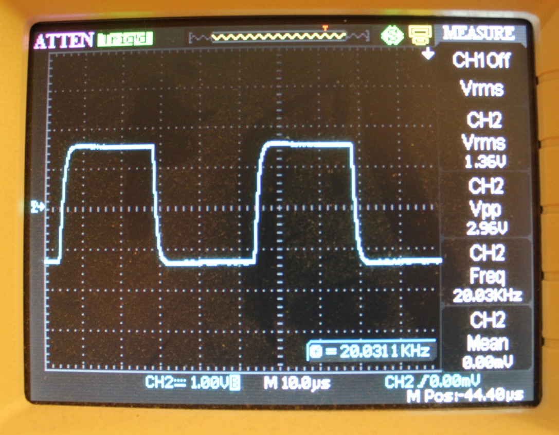

Very interesting thread, Bigun! Here is the measurements from my Naim versions at 20kHz squares:
First is the standard circuit with 200pF input cap and the R/C circuits in the drivers.
Second one is the same circuit, but without the R/C circuit and Lat. MOSFET output with about 300ohms in the gates.
I know - different signal levels - but still the LATFETs look definitely better. Soundwise I don't think so, unfortunately. I suspect bandwidth itself is important, but it's not just that that makes the good sound. My original circuit always sounded "dark" and I thought the MOSFET one being wider bandwidth will open up the sound, but after I got used to it I found it darker and somewhat dull. I ended up with tube amp few years ago and haven't built a single thing since then. I'm ashamed to upload the 20kHz behaviour of my tube project 🙂 , but I love the sound. There is music.
Wish you luck and hope to hear about great sound from your version!

Apart from changing the RC input capacitor value did you alter any compensation capacitor values or any phase correction capacitor values.
It is still possible with some changes to my simulation - square wave input 10kHz output into 8R//2uf, to get some small improvement in the shape of the square wave output, to make more out of MJL3281 devices if one dares.
BD139/140 drivers perform better than MJE243/253 in experimental trial adjustments to my simulation. Bigun has chosen a different transistor line-up which should have the potential to do a better job. For that we will have to wait and see.
In the meantime it would be interesting to know the line-up in your original Naim project and if anything changed when you adopted LATFET outputs and the identity of the latter parts.

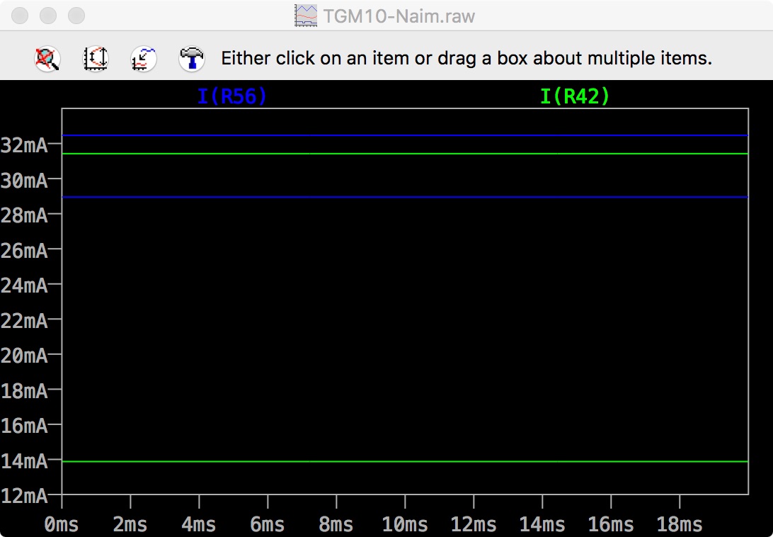

It has shown me the value of the phase correction networks. The issue is the stability with capacitive loads (of course) but not the 2uF load of an electrostatic speaker which doesn’t seem to be any issue, but rather the parasitic capacitance of ‘bad cables’. I used a 2nF load across the 8R speaker and it worked nicely to tip the amplifier into instability. The phase correction networks addressed this nicely, although with different resistor values than the original NAP 110 design.
Also interesting to discover was a clear benefit of reducing the emitter resistor on the low-side driver (the one in parallel with the diode). I don’t think this has been explored much before and it may be worth further investigation.

A couple of plots to share. First one shows the benefit of my alteration to the Vbe multiplier to better control the temp-comp. The idle current is shown for my improved approach (described earlier) in blue I(R56) and without my improvement in green I(R42). The temperature was set at 40C and it produced the two lines at the top of around 32mA. The temperature was increased to 60C and it produced the two lower lines. My improved circuit shows a 10% fall in the idle current compared with a drastic fall for the original. I could tune it for 0% change but I'd prefer to have a slightly -Ve temp. co for the build.

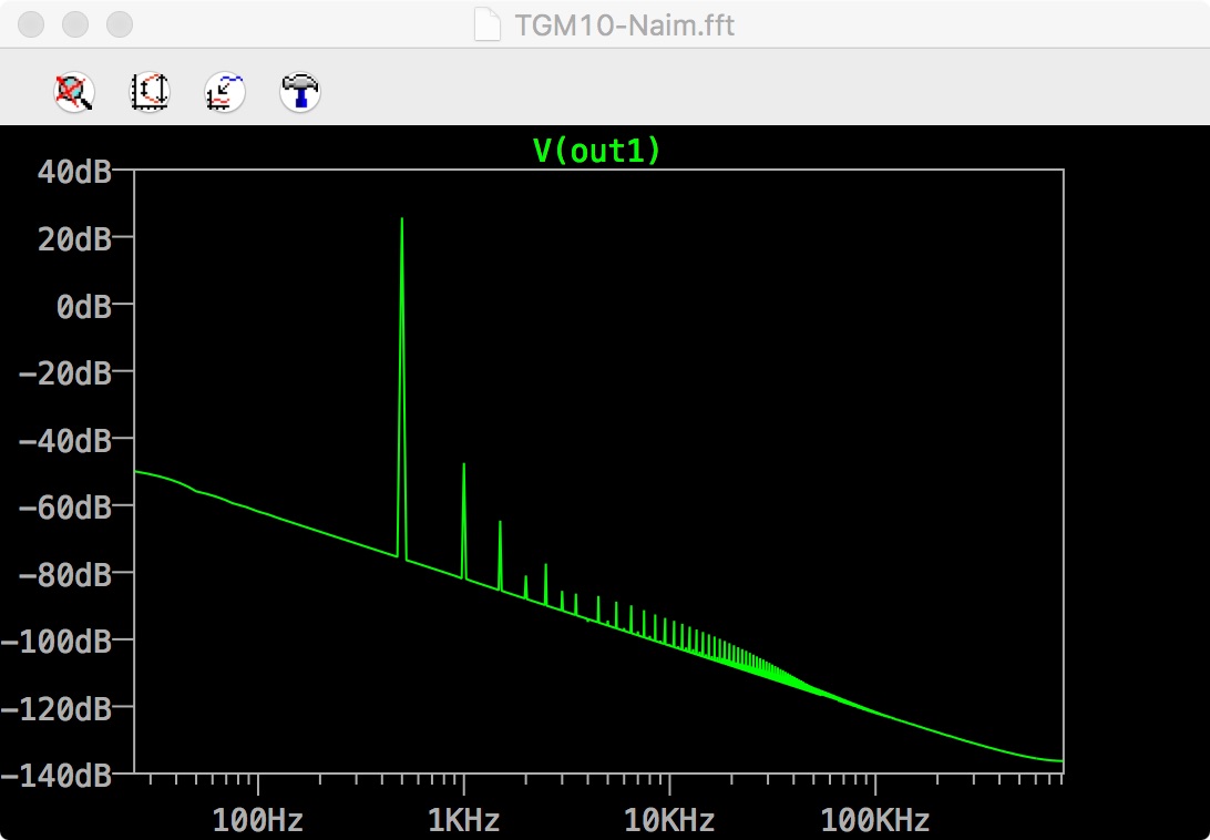

The second plot shows the distortion profile at 500Hz into an 8R load (dissipating 46W av.) with 2nF in parallel.
