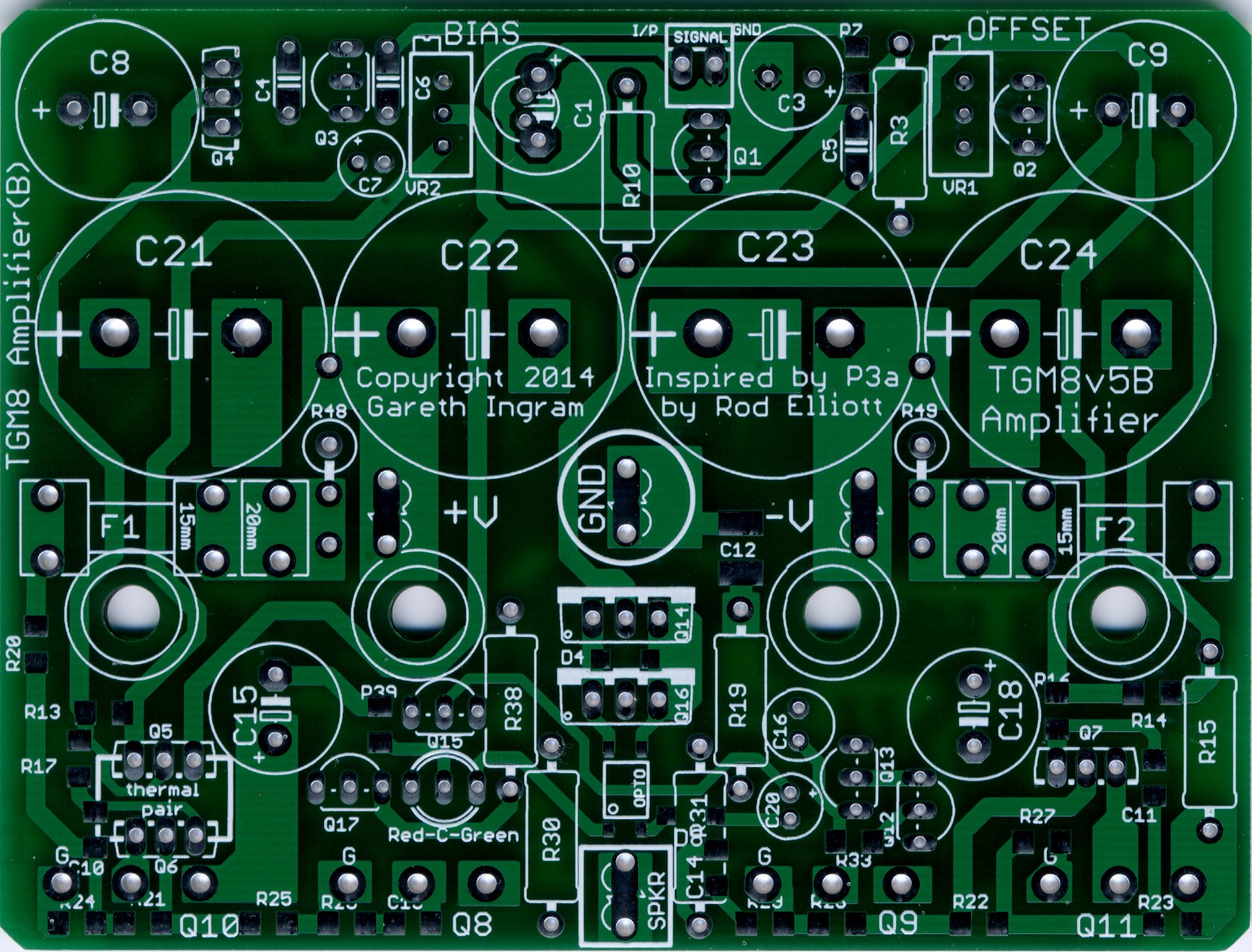

There's a potential benefit from keeping the capacitance on-board - it places reservoir capacity very close to the power devices via low inductance and low resistance connection.
Could this be important for the good bass performance ? - I don't know because I haven't compared with and without on-board capacitors but I suspect it's an important contributor. Are these caps also important for local decoupling as part of good amplifier power rail behaviour ? - I never saw a good amplifier without them.
There is nothing stopping you from installing the on-board caps and also using an existing PSU.
You can also install shorting links in place of the 'R' in the on-board CRC so that you have just a local capacitance. You could then choose to install just the last 'C' or install all capacitors but at half the value as they would be shorter and lighter wight. You could also just install the last 'C' and put shorting links in place of the first 'CR'.
Bottom line - I would keep a decent level of capacitance on-board. Final approach is up to you, it's 'DIY'

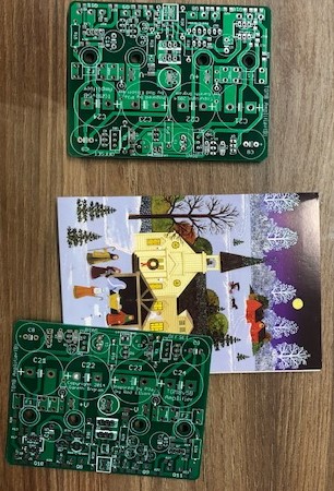

Thanks Bigun. Boards have arrived.

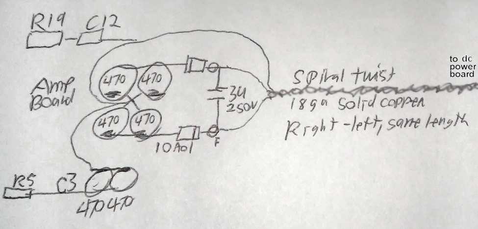

To relocate the big caps but keep similar features, it is possible fill the amp board power cap spots with 470u and short the R. You get 470u||470u per each rail at the amp board. Then series diodes which replaced the R have only one pin in the board (they're at v+ and v-, series to the cord). At the free end of the 10A01 diodes goes the one 250v rail to rail cap (range 2u to 4u7) and the DC power cable. I might add one knot or two ferrites.
Actually I've a plan to use 270u||270u per rail but otherwise exactly like this example. That and 8" (or a little more) of spiral twist thermostat wire (the rail to rail cap puts HF load on dc cable, so perhaps not romex). 18awg solid copper works, or for longer cable, 16awg solid copper works. It must be solid copper, not stranded, because your signal makes trips to the power board and you want just one copy. And, the left and right cables have to be the same length (especially the 0v). A bit of detail pays off when everything else is easier.
This should sound rather similar, as it will block crosstalk just as well. So for small signal crc, use a resistor (loss is a percentage); but, for whole power amp crc, use a diode (loss is a fixed amount) and notice the bass power difference.
Another mention, the doodads and detail are for: move the caps but keep the features.

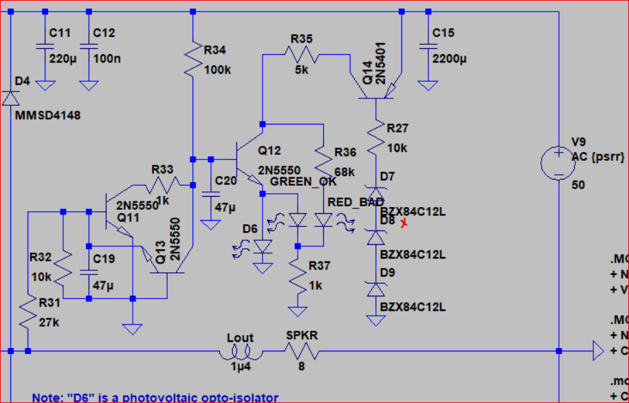

You've said here that "the speaker disconnect circuit is mostly to stop turn on and turn off noises". Is it same with TGM8 protection circuit?
thanks
My intention was to 3 things
a) protection for speaker in case of dc fault
b) delayed turn on to prevent turn on bump associated with singleton input etc.
c) fast turn off before rails collapse to avoid turn off noises
The circuit on the board does all 3 things. However, I have not tested the dc speaker protection to destruction, or under worse case conditions. What I did was to connect it to a cheap speaker and manually increase the dc at the output (provided input signal with input capacitor out of circuit) from zero with higher and higher voltage until the TGM8 SS relay circuit cut-off - this worked just fine but it's not a worse case scenario. I know the circuit could be made more robust by adding more sophistication but so far I didn't have a need. If I make a 500W version I will redesign the protection and likely add short-circuit output protection too. But I didn't find a reason to make a 500W version yet.

yes, certainly can if you want to, giving you 940uF per rail of on-board capacitance as you mentioned.To relocate the big caps but keep similar features, it is possible fill the amp board power cap spots with 470u and short the R. You get 470u||470u per each rail at the amp board.
I think I’m getting what you are saying now that I cross-reference to your diagram. You will have a 2u to 4u7 off-board cap going from rail to rail and you connect to the board via series diodes. Well, I can’t see at first why this arrangement, i.e. what it will improve, but it sounds like you’ve given this some thought and I don't see any harm in it - why not give it go indeed.Then series diodes which replaced the R have only one pin in the board (they're at v+ and v-, series to the cord). At the free end of the 10A01 diodes goes the one 250v rail to rail cap (range 2u to 4u7) and the DC power cable. I might add one knot or two ferrites.

D5 is Vs -5V. My supplies are 40V, but I bought a 30V zener (as per the BOM). Is this OK to use? (I assume this is an under-voltage lockout for the protection FETs, so 10V lower than the supply should be OK).

Hi Dave can you confirm which schematic and which BOM you were comparing because I thought I had gone through and cleaned it up not too long ago (post 1008). The Zener diode is perfect at 30 V.
