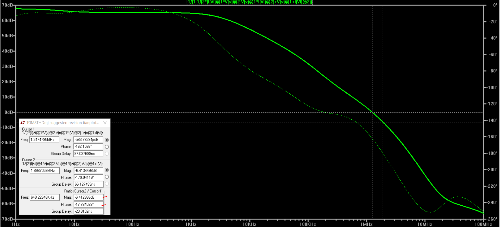

I have looked at this from the perspective of keeping the changes down to a minimum.
The main issue is the value of C5 is too low at 22pF and this is something that can be tweaked without difficulty to achieve a phase margin of at least -45 degrees.
Unfortunately this circuit is not a two pole compensation scheme as the attached image shows and so the maximum rate of decline for slope between -3dB and unity gain frequency is 6dB/Octave (20dB/Decade). Refer to footnote at end.
With 22pF the unity gain frequency is 1.24MHz at which point the phase has reached -162 degrees leaving a phase margin of 17-18 degrees.
The simplest remedy for existing builds is to increase C5 value from 22pF to 200pF -with a surface mount capacitor it may be possible to do a neat job of soldering an additional 180pF capacitor piggy-back on top of C5. Through hole types will be easy enough to substitute 220pF for 22pF.
For new builds R8 can be omitted while the values for R10 and R5 could be increased to 2.2k and 100R respectively. This would allow a value of 100pF to be used for C5.
In effect C5 impedance is in parallel with 2.2k of R10 - this would reduce the loading effect on Q4 collector slightly - a little more ideal.

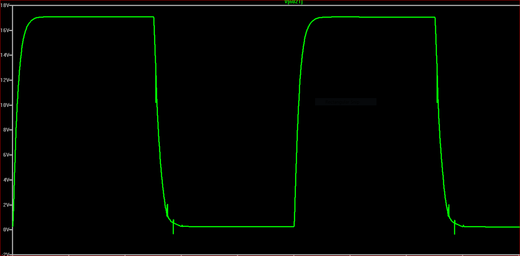

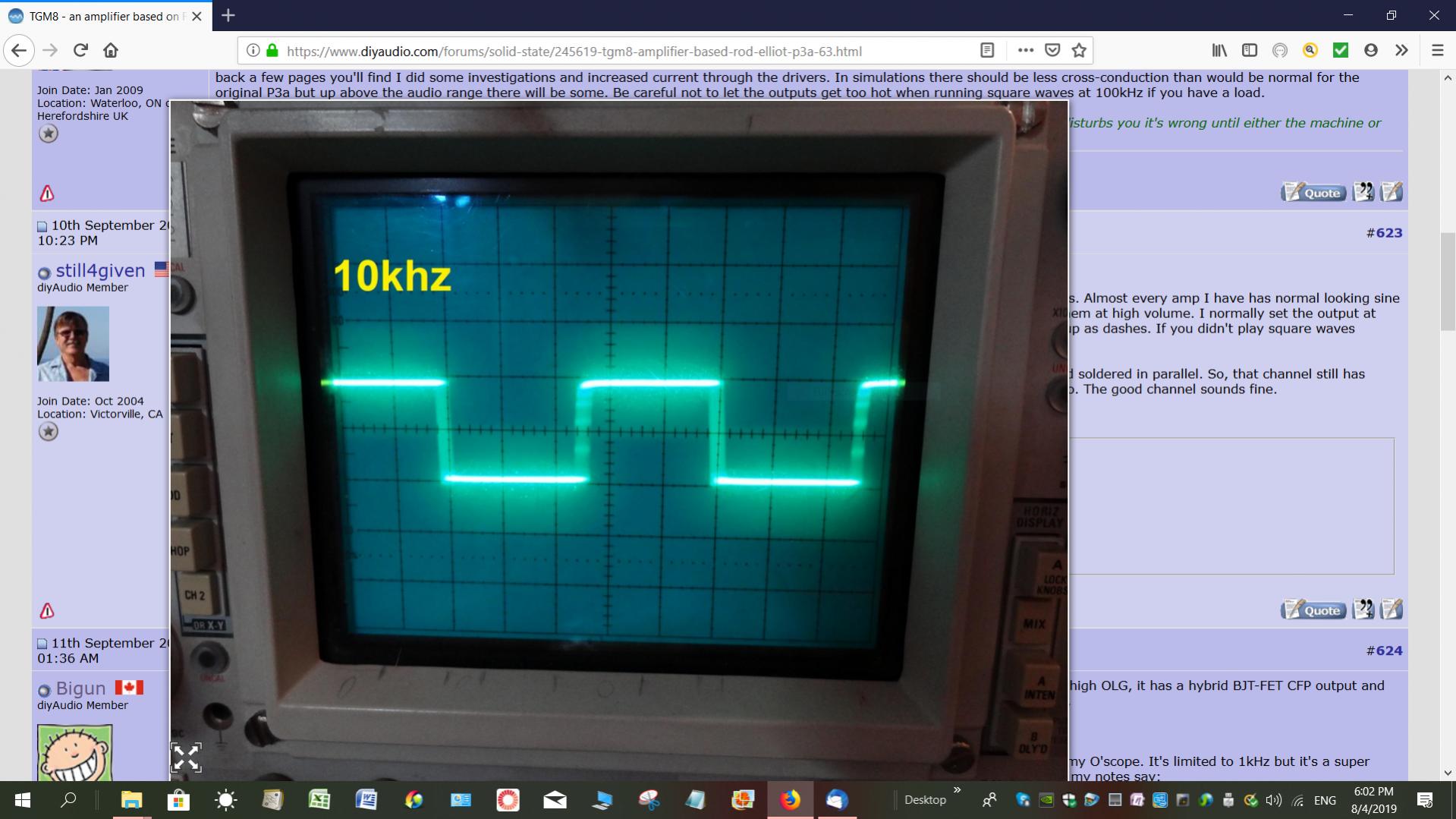

This circuit behaves well enough on a Tian probe plot and on 10kHz square wave with 8R as a load. Unfortunately with increasing capacitance in parallel this induces some spikes in the square waveform which no amount of standing current or frequency compensation is able to expunge. See attached re onset.

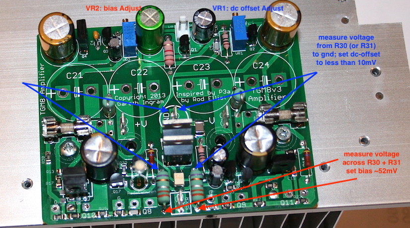

...Once assembled, I’m not overly sure on testing... where to put the probes and values I need to see and adjust to... any help would be massively appreciated... apart from that, I think I’m ready to solder on!
I am the first to admit that this board is not easy to probe because it’s densely populated and when mounted to a heatsink the underside of the board is not accessible at all. It’s not a beginners project in this regard.
Clearly, you want to assemble it carefully so that you are confident that there are no mistakes. Double check all the parts are the right values and installed properly. Clean the board carefully to remove excess flux from the soldering. I do this more than once during the build as it gets harder to reach all the parts once the board is finished. Look over the board for any solder bridges or small pieces of conductor that shouldn’t be there.
As an additional precaution you can test the board un-powered before it’s mounted on a heatsink. Use a DMM set to resistance mode and measure between each power rail and ground - looking to ensure there’s no dead-short (< 10 Ohms) that would draw excessive current if power was applied.
Before mounting on the heatsink you can also check that the bias potentiometer, VR2, is set to deliver minimal bias - essentially turning the output stage off so that there’s no danger of it drawing excess current on first power-up. Use a DMM on resistance range to probe the terminals of the bias potentiometer and adjust it so that the resistance across pins 1 and 3 is small.
I use a current-limited bench supply for first power up. This allows me to limit the current and voltage and ramp them up, with no load connected to the output of the amplifier. An initial current flow is required to charge the on-board capacitors. If you don’t have such a supply, a trick quoted on the forum is to install a light bulb in series with the power transformer. A mains light bulb in series with the mains supply to the primary of the transformer will glow brightly if the amp is trying to pull too much current (or if the power supply rectifiers are shorting the secondary of the transformer).
Another good precaution is not to install the power rail fuses on the board at first, but temporarily connect in place of each fuse a 100Ohm power resistor instead. This limits the current to avoid damage in case of a fault. By measuring the voltage drop across each resistor you will be able to determine the current draw on each rail using Ohms Law. Anything more than tens of mA is a cause for investigation.
If all is good you can apply full power, with fuses installed. The next step is to set the bias current for the output stage using VR2 and the dc-offset adjustment using VR1. It’s usually helpful to adjust them both in turn, going back and forth between them because the bias is best set when the dc-offset is close to zero. It’s not easy to set the dc-offset, small adjustments are needed and a result of less than 10mV at the output is good enough. The dc-offset is measured at the output with respect to ground. However, because excessive dc-offset will prevent the output relay from closing (the LED will remain red) you may need to monitor the dc-offset before the relay and adjust it until it’s low enough that the output relay closes (the LED will go green). One option for a place to probe the output before the solid state relay is R30 or R31 (blue arrows in attached image). If the dc-offset is within a reasonable range and the LED is green, then probe at the speaker connection which is much easier.
To measure the bias current it’s best to measure the voltage drop across the string R30 + R31; we are aiming for around 50mV to 60mV here (you might see a + or - value depending on which way around you connect the probes). You want to set the bias current by starting from zero and ramping it to somewhere around 30mV and then let the devices warm up slightly and check that the bias remains stable. If it’s not stable we might have a problem somewhere. A convenient place to monitor the voltage across R30 and R31 is show by the red arrows in the attached image.
If you are lucky enough to have two DMM’s you can set one on voltage to measure the dc-offset of the output and the other on voltage to measure the bias current.
