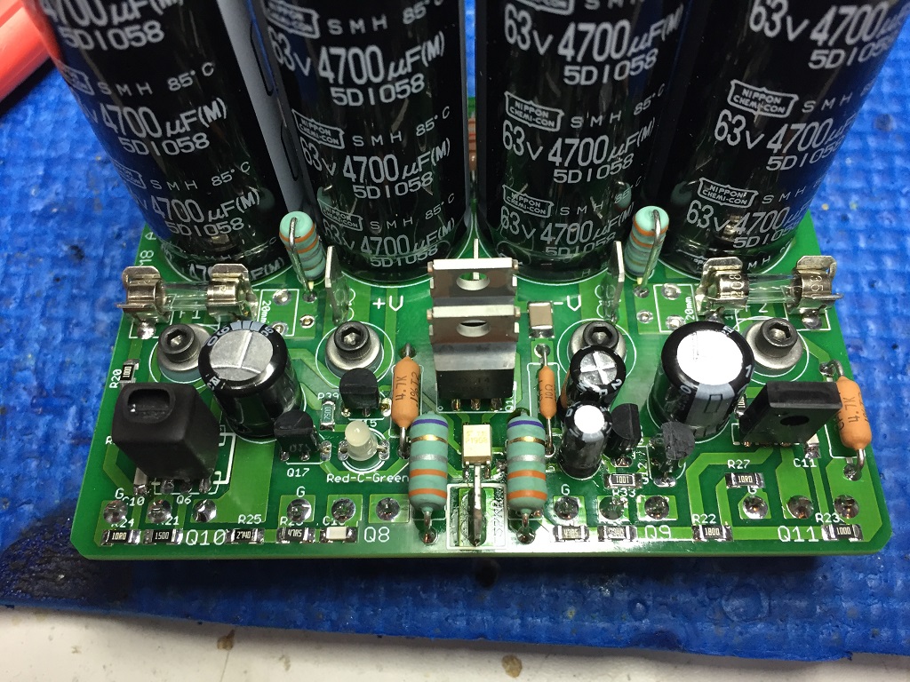

Finally got my TGM8 build restarted.
Not sure if anyone else had this issue... but just a warning for others:
It is IMPERATIVE that you use an insulating washer on the pcb top side for the power transistor screws. Otherwise you could have the problem I had. In my case the screw shorted to the VBE multipler and shorted the node R13/R17 to the heatsink (you can see a bit of exposed copper on the track where this happened).
I guess I was lucky that it didn't short the rail(s) to heatsink, although my current limited bench supply would have prevented any pyrotechnics!
Ayway, the boards are more or less done now. Iq stablity is very good, offset stability (with temp) is decent. I'll do some AC and disstortion testing soon.

good note Dave!
It helps to use a small solid washer and hex bolt. Attached is what Do did back in post #776.
It’s a cramped pcb, because the overall size was limited by the free version of the layout software. If I were to re-do it today I’d get out my wallet instead of being a tight-wad and buy a software license!
