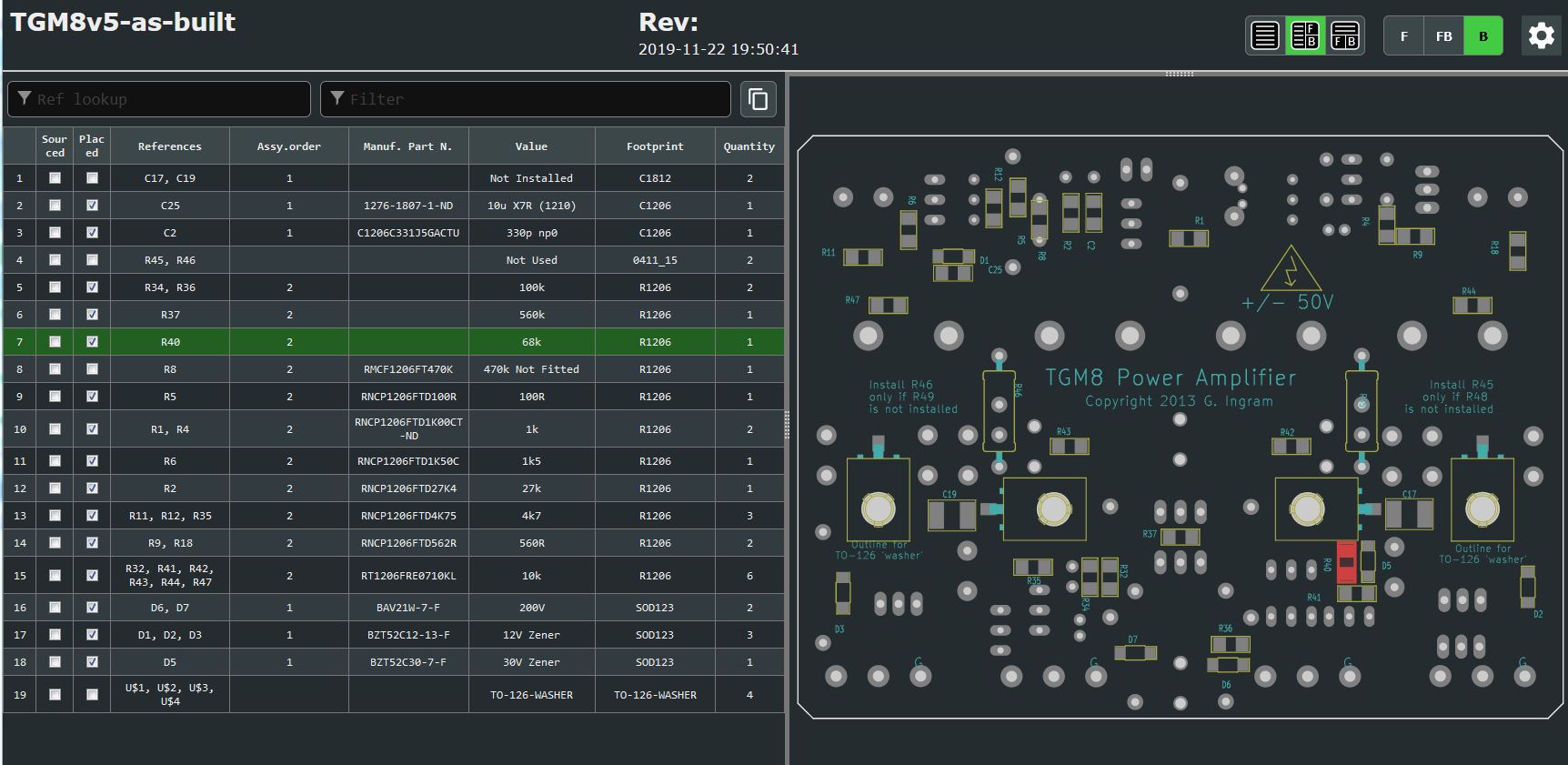

Assembling the boards using Kicad
I highly recommend Kicad, not just for layout but for kitting and assembly. You need to download and install the Interactive HTML BOM plugin. See here YouTube As you can see the BOM tool allows you to locate each component on the BOM. It will split your BOM into top and bottom sides so you can assemble one side at a time easily and mark off each component as you go. I downloaded Gareth’s design files from post 404 and imported the Eagle project into Kicad. I did however have to manually copy the published TGM8 BOM (word doc) into Kicad, but it was worth it.

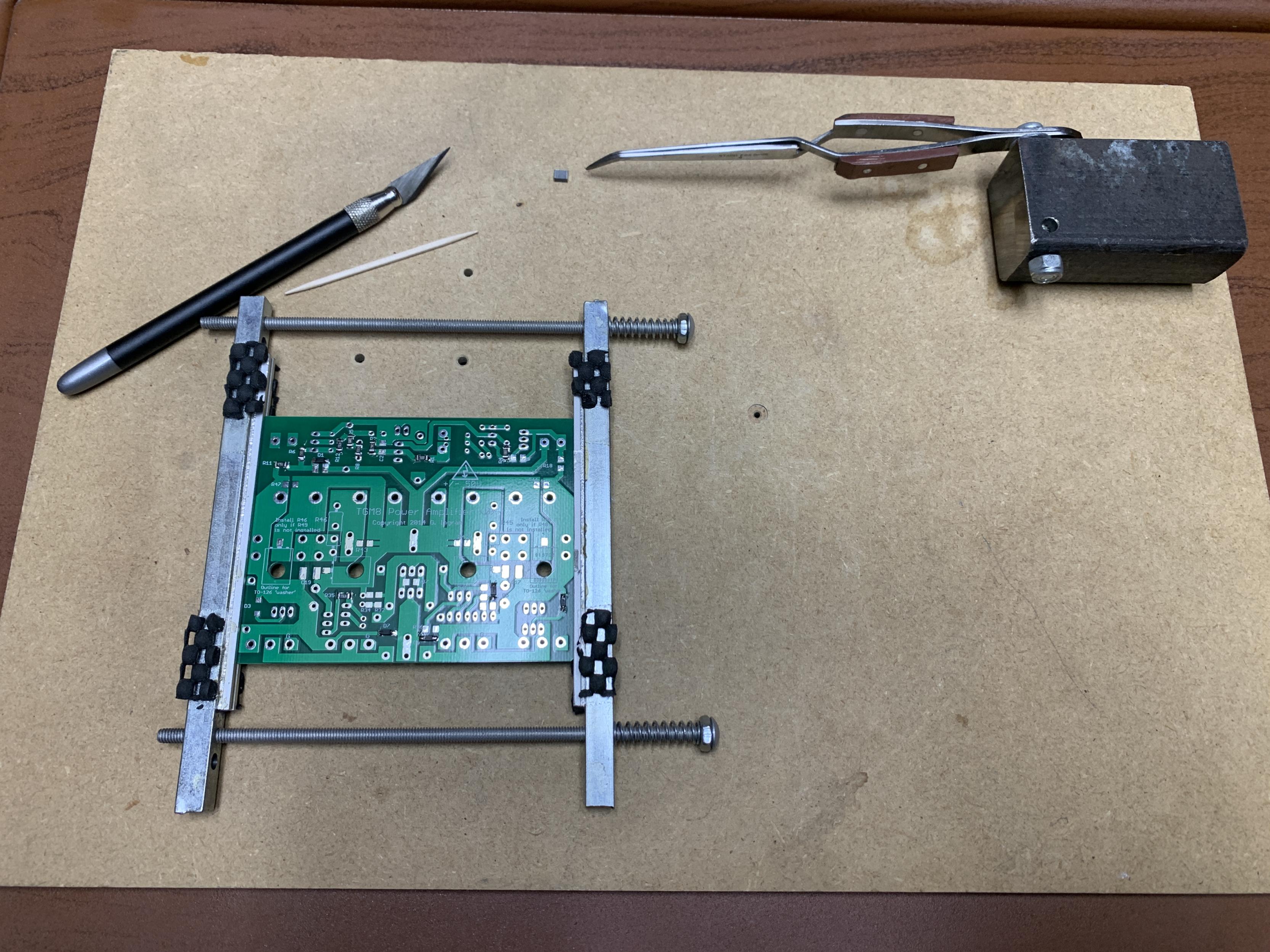

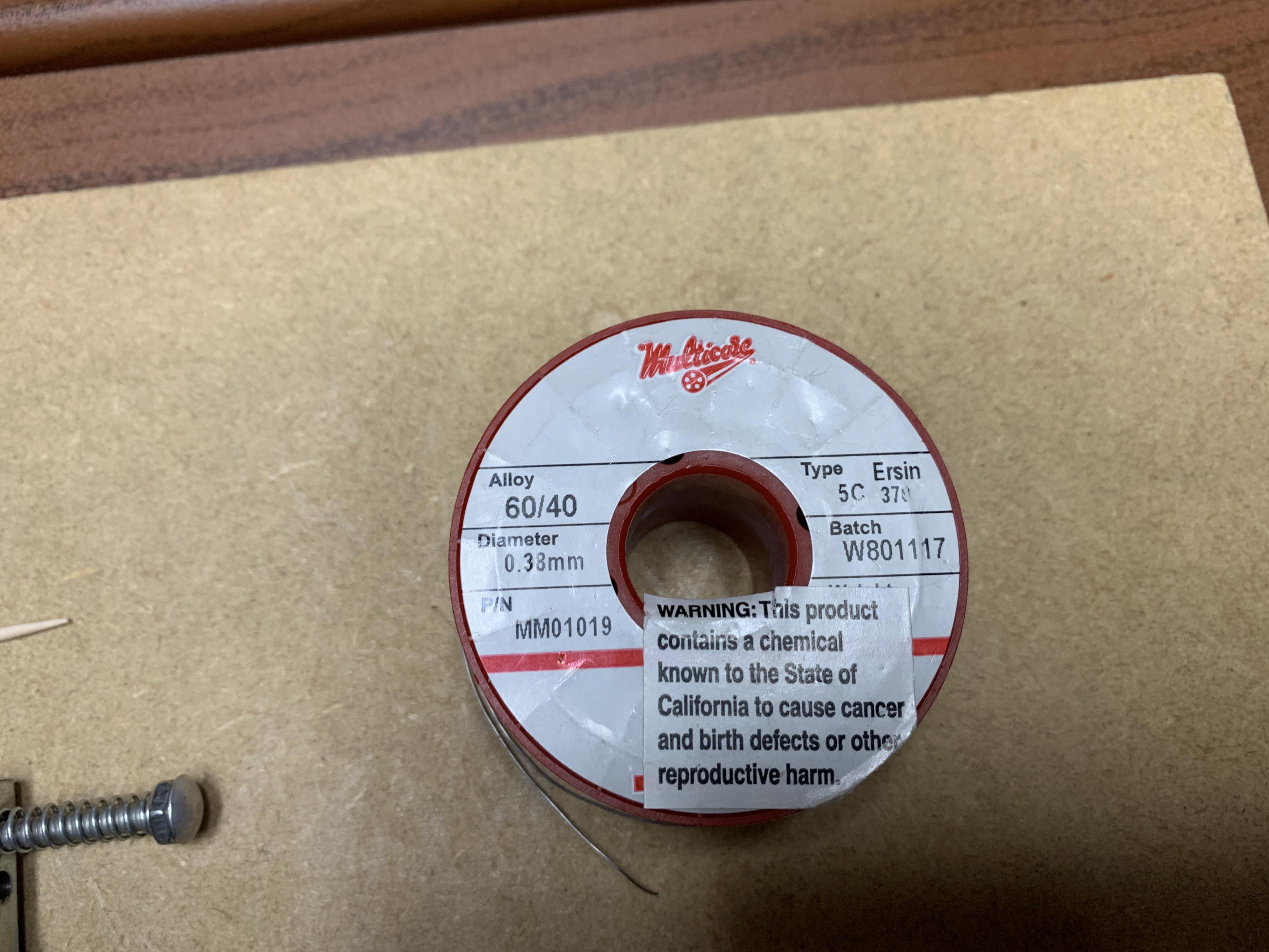

This is how I do surface mount using a few tools that I made. The tweezers are mounted on a steel block so they can pivot up and down. Tension can be adjusted with the screw and lock nut. Grab the part and position it on the pcb. I made a jig to hold the pcb so it can be moved around and flipped over to solder on the other side. I use the solder in the picture and use the largest solder tip that I can so it heats the part quickly and then apply solder. It takes very little solder to attach the part.
