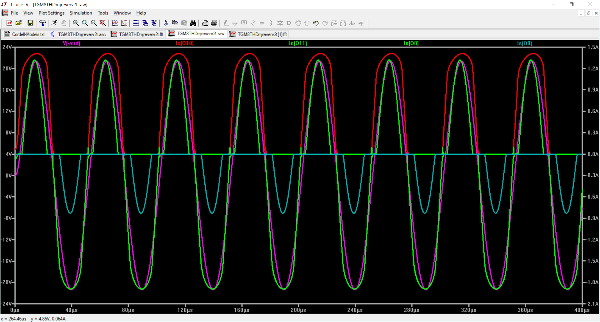

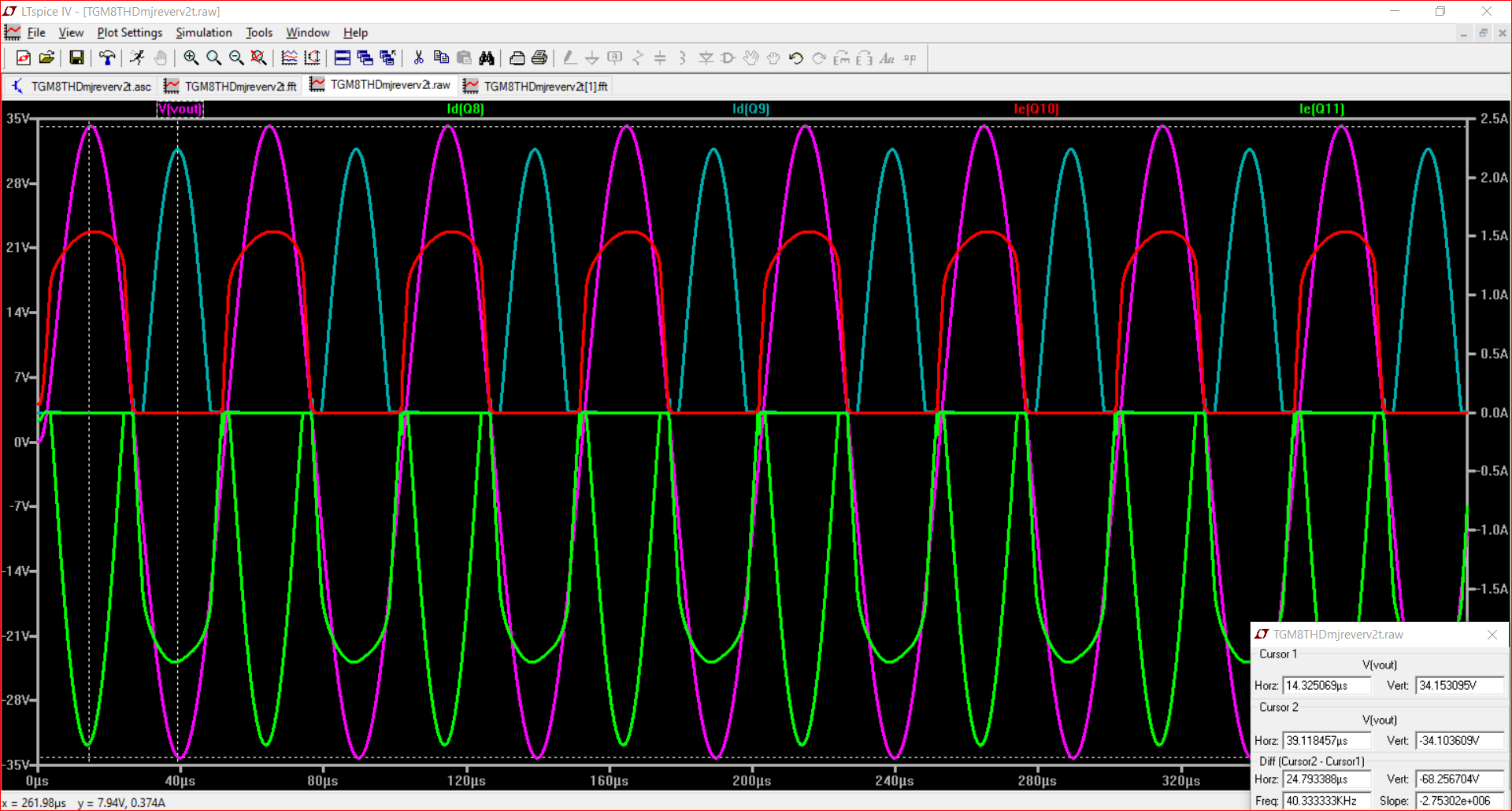

Just to be clear... the oscillation is only on the positive peaks of the sine wave at or near clipping. I don't consider this in any way dangerous to the speakers, especially in normal use. Apologies for my CrApple pictures, the oscillation looks blurred:
I have run simulations on this circuit. I am attaching a couple of results looking at the emitter currents or the output BJTs and the source and drain currents for the output FETs showing these for peak 20kHz sine outputs at 21V and 34V into 8R.
As the output voltage increases the FETs conduct more and the BJT's conduct less current. The situation reverses when the output voltage is reduced where the FET's conduct less and the BJTs conduct more.
I used Bob Cordell's IRFP9240C and IRFP240C in my simulation for the FETs and other BJTs with supplies of +/- 48.5V.
The zero current cross over voltage point is displaced from zero volts depending the vantage point. I looked at the BJT Output's Ie versus both FET Is and Id in the attached plot images.
I did not take this to the stage of looking at Ig versus Ib however the situation of each half is dynamic in it's own sphere before cross matching with the complementary other half.
It appears that some dynamic aspects can be matched on one side but not for all situations. I don't have any answers on that score however the THD at 20kHz on sine was around 0.1% at the higher voltage level output reducing to 0.03% at the lower simulation test level.

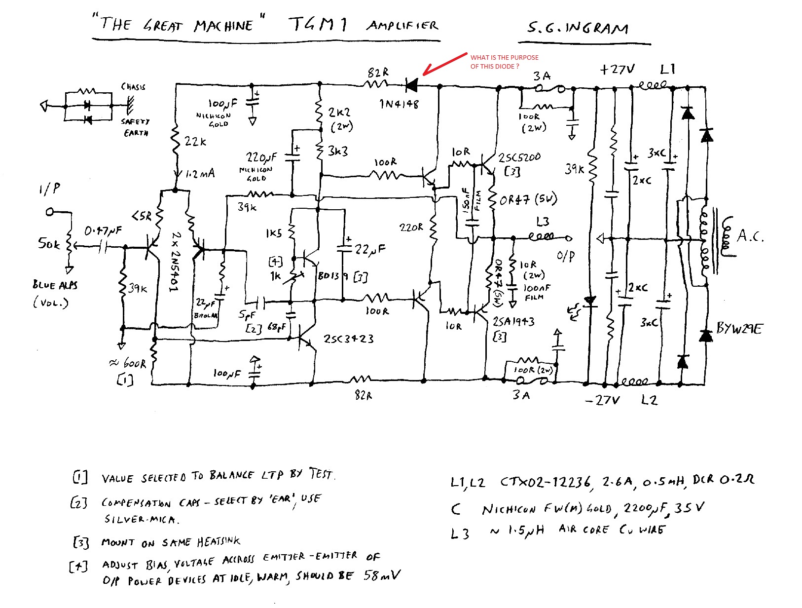

Hi bigun
I have been reading about this amp and compared it with your tgm1 where you placed a diode in series with r24 100ohms resistor (refering to the schema in post w3).
Here you do not have the diode... what should be the purpose of that component in the v++ rail ?

Hi RC,
The main reason that I used this diode was to be faithful to the original design which is the AKSA amplifier. I remember reading about this diode in other bootstrap designs and it’s purpose is linked to the bootstrap current source used for the VA; the diode gives the bootstrap something to ‘push against’ in the positive rail and protects the front end of the amplifier from those tomes when the output stage pulls the positive rail down during heavy current draw. More importantly, Hugh said it did allow the bootstrap to create a little second harmonic; there are other important mechanisms in that design for creating second harmonics but they all work together. In TGM8 I didn’t feel this diode was needed.
Hi RC,
Thank you....

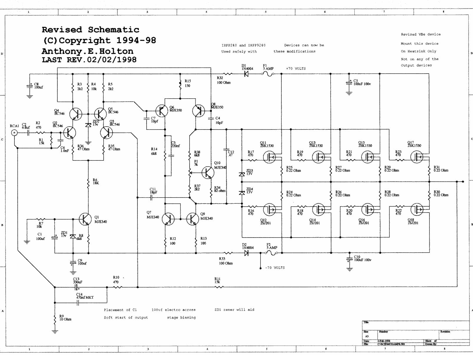

I am wondering why I keep seeing these diodes in high power amps even if there are no bootstraps evident like here:
Joined 2009
I note that they have diodes on both rails. I would guess it is more than avoiding the output stage causing power rail 'sag', it may also be to protect for other issues, whether power-up, power down sequencing and ensuring discharging caps don't hard things, and with clamp diodes on the output to protect the output stage from speaker back emf there maybe a need to protect the front end too. I've never looked at the details of really high power amps. There's something to learn from those designers.
Thank you so much for your input.... in fact I am now building another TGM8 based amp and wanted to know if those diodes could somehow filter the rails between the output stage and the input stage...
My memory is not clear on this but there was an article published in Wireless World which could have been after the name change to Electronics and Wireless World about switching effects in Class B output stages generating a spray of harmonics in general and these would be expressed on the supply rails. This might have been due to Anthony Holton referred to in post 1087.
The commonly held view is that current flows from collector to emitter and therefore a diode is necessary in the positive rail as per the example in the attachment to post 1087.
On the other hand BJT carrier charges flow in the opposite direction to current so the attention to stopping ripple entering the voltage gain stages is to do so where emitters are connected to a voltage supply rail.
In the AKSA based circuit the LTP transistor emitters are connected to the positive rail while the general philosophy of the design seems to be to avoid CCS structures and use a simple approach using a resistor there and to bootstrap the collector load on the VAS transistor.
In contrast a Blameless style of amplifier would use CCS structures and current mirrors and an RC filter in the rail feeding the emitters in the stages preceding the outputs. The R element would be kept low and that for C would be larger to compensate.

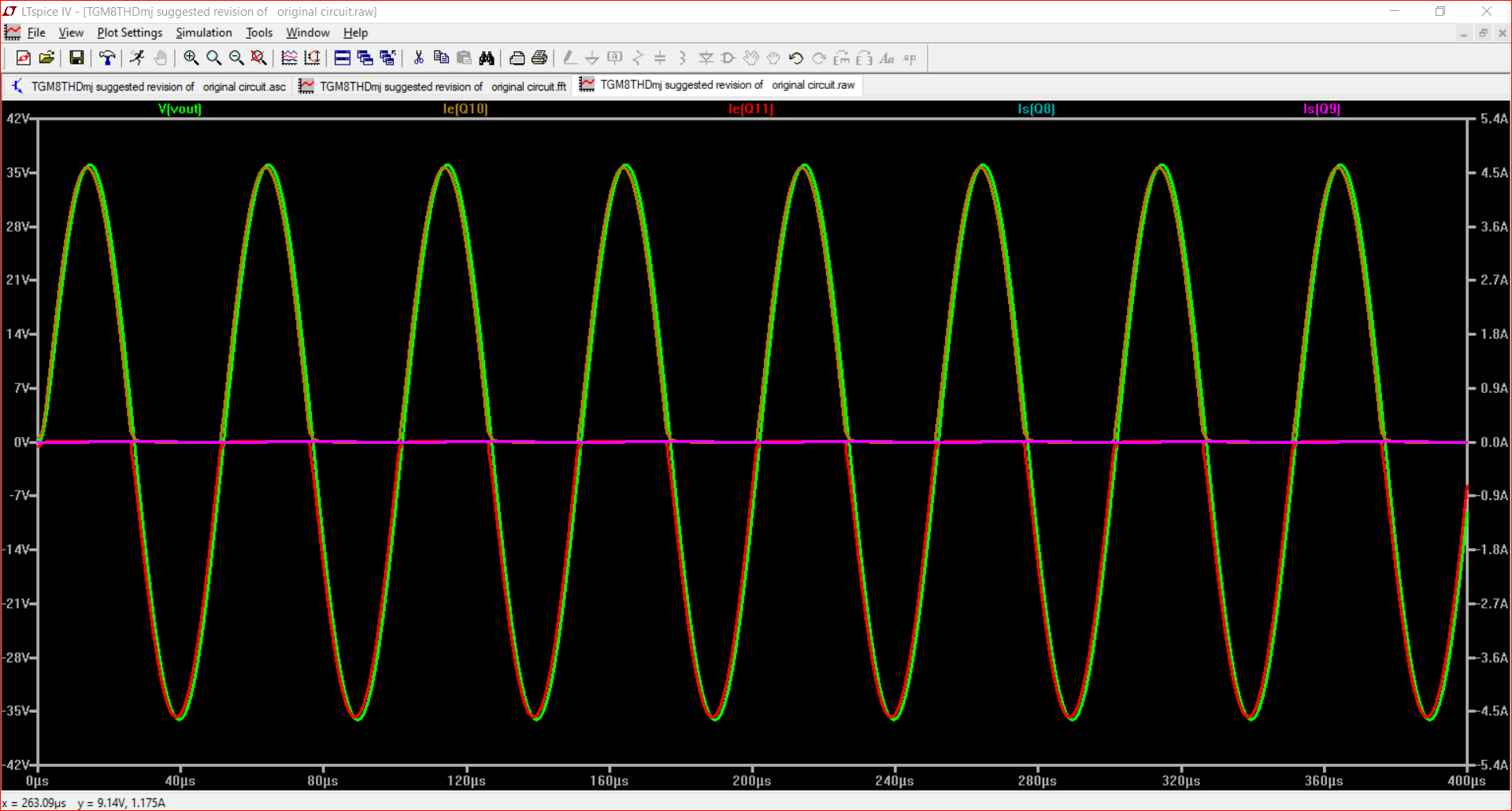

Another possible Approach?
My memory is not what it used to be having forgotten about some correspondence I had with Gareth about this circuit and I have found a simulation I did at the time.
Anyway I have run this and compared the detail with the images attached to my post 1081 which represent the circuit with the output BJT and FET having exchanged places in each output half.
I did not post the .asc file at the time as I was not proposing to built the amplifier in any form as there comes a time when there are just too many projects taking up space in the den. That situation remains unchanged.
The new images show equal current sharing between the BJTs and FETs and the alignment is time is virtually uniform. The simulated 20kHz THD is also better at <0.02% 36V peak into 8R.
