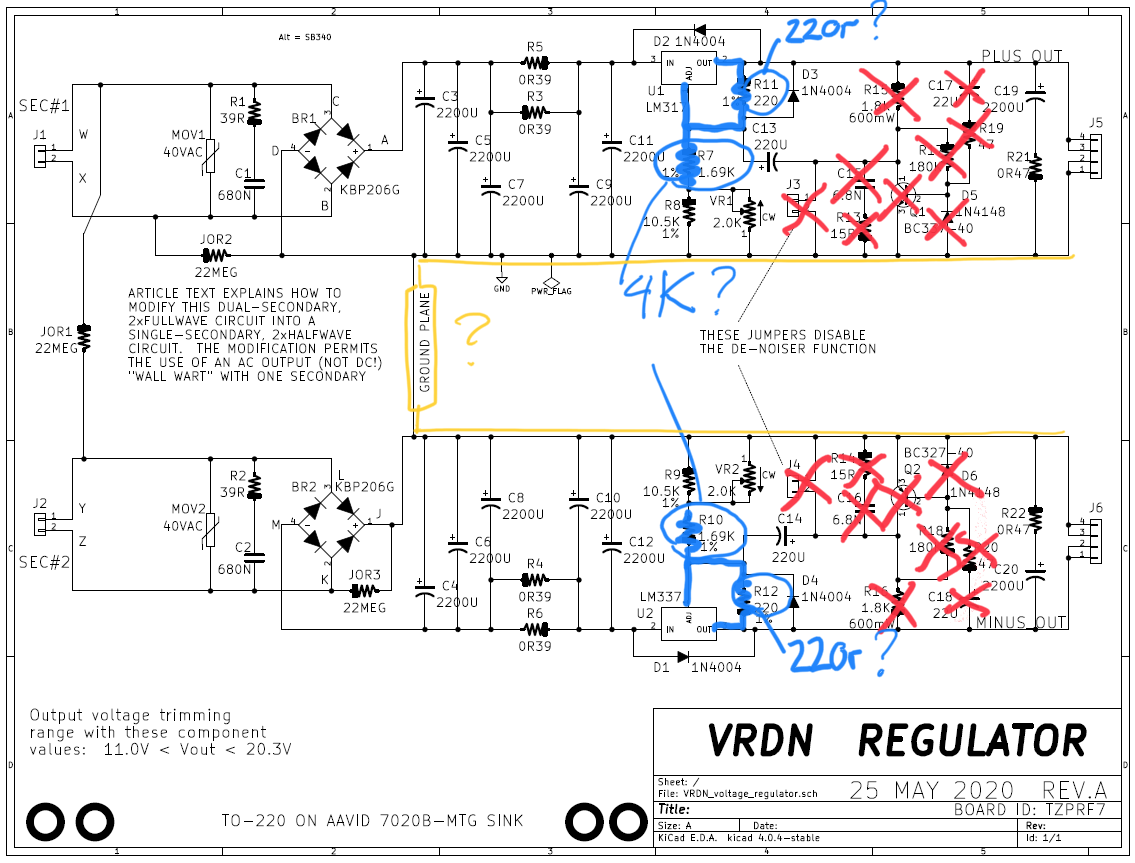

If you want to use the VRDN for +/-24V without the de-noiser you can leave
out all the parts after the J3 and J4 jumpers. Also you need to make small
adjustments to the LM317/337 programming resistors since the values in the
VRDN schematics limit things to about +/-20V. (For example, increasing
R7 and R10 in the VRDN schematics here
https://www.diyaudio.com/forums/att...level-ckts-11v-20v-1-5a-de-noiser-figure1-png )
Please see https://www.ti.com/lit/ds/symlink/lm317.pdf, section 9 for more details.
increasing R7 and R10 in the VRDN schematics.
220R from OUT to ADJ, 4K from ADJ to GND.
Hi guys
Did I get it right this time?
Thank you!
PS: Is the denoiser restricted to 20 V too, so that it wouldn’t work on 24V (or not without further tweaks)?
There‘s a already populated VRDN laying around, which I could use (even though it’s blue 🙂 ), and since the denoiser can be just disabled by that bridge...

You're interested in the resistance from the ADJ pin to ground. In this case,
this means the group R7/R8/VR1 (for the LM317) and
R10/R9/VR2 (for the LM337) As Jim wrote, when these groups are at 4K,
you have about +/-24V. How you achieve that is up to you, but changing
R7 and R10 to 4K will give you a min voltage of about +/-24V.
If you use 2.5K for R7 and R10 you should be able to adjust from
about +/-15.5V to +/-25V
You still need to set the J3 and J4 jumpers.

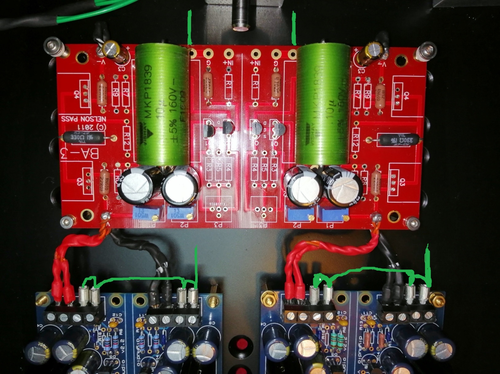

In my build the power supply consists off,
1 transformer,
x2 diode's/caps (one for each channel)
x2 diy store supper regs (one for each channel),
should the return to case be taken from the reg's board or the ba3 board.
also, will x2 bridge/thermistor be required at return to case.
