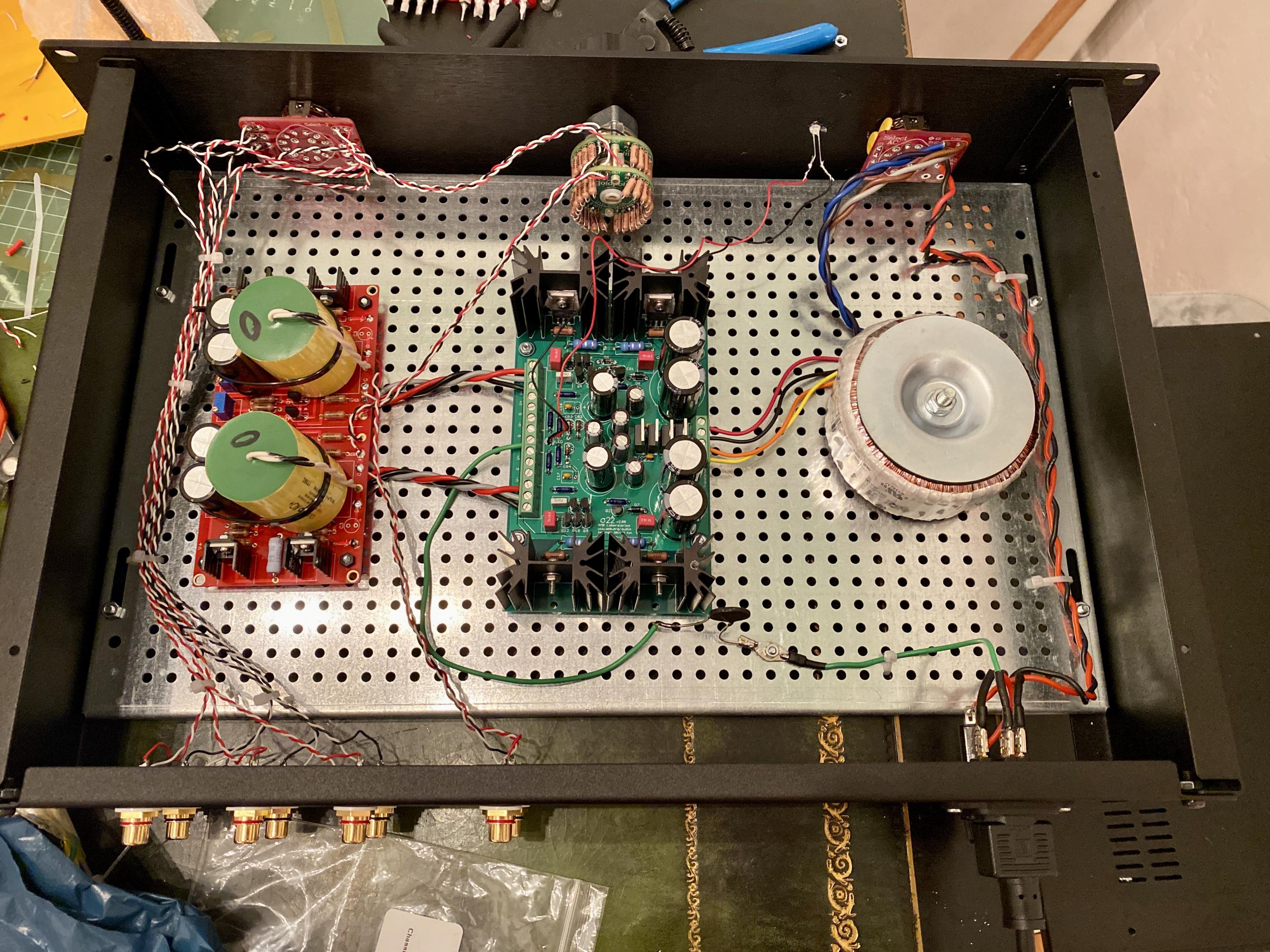

My build is finally completed! Can't thank all of you enough, especially those who have posted before me with very thoughtful questions and responses. I've hooked it up to my pair of active monitors and it sounds fantastic, soundstage is super wide, and resolution is very clear as well.
However, I do have some hum and hiss taking place when I turn the volume knob (50k) all the way up. It isn't noticeable from listening position but if put my ear right up next to the speaker within a few inches, it is definitely there - considering that it supposed to be dead quiet, I know i can do some tweaking. So here are my questions:
1. I've read that this may be due to a gain issue. I have yet to do a test to measure voltage in vs voltage out, but if that is the case, I understand that a resistor from MOSFET drain to ground would solve the problem. How does one calculate the required resistance to implement? I do plan on building an F4 next so I will need SOME gain, so don't want to go overboard with the resistor
2. If it turns out it isn't a gain issue, what other faults may be causing this issue? I've attached a pic below to see if any of you can find any issues with my build.
Sorry here's the pic
You could try different experiments like moving the transformer far outside the chassis to check if hum is from the magnetic field from transformer or disconnect one channel completely (remove power) to check if it is ground loop issue?
I assume the green wire from PSU to NTC is signal Gnd?
Yes Green wire from PSU to NTC is signal ground. I'll definitely give those experiments a shot.
Also I just did a little test and I noticed that the hiss is present even when the volume knob is turned all the way down, while the hum only comes on when the volume is turned up. Not sure if that helps diagnose in anyway...
Ok i was able to remove one of the channels from power to check for ground loop, hum and hiss remained.
I then checked my gain - i used my phone to play a 1k sine test tone using the 3.5mm output into RCA, then measured the output of the ba-3:
In: 0.847 Vac
Out: 6.22 Vac
I also had an output reading of -0.25 Vdc, would that have any effect?
Would appreciate all the help I can get! :)
