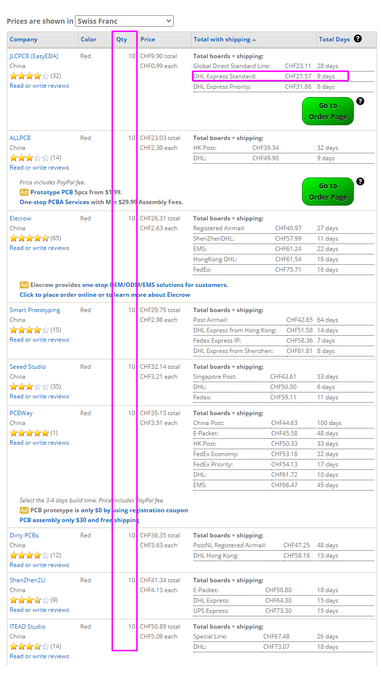

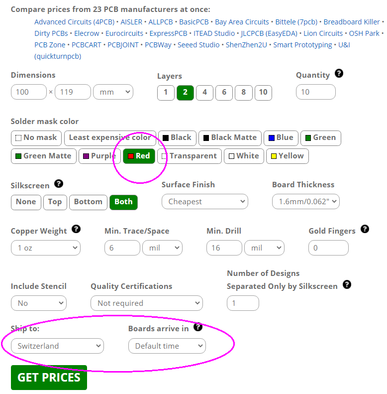

Any of the order-it-yourself-from-Gerber-CAD-files power supply units, can be purchased in RED. For example, here is a set of price quotes for the PSU designed by member "iamwhoiam" , Gerber files found attached to this message
I used the comparison shopping website
PCBShopper – A Price Comparison Site for Printed Circuit Boards
to obtain these quotes on Friday morning, 28 Aug 2020. Click on the white "X" in the lower left hand corner, to see the images full size and undistorted.
