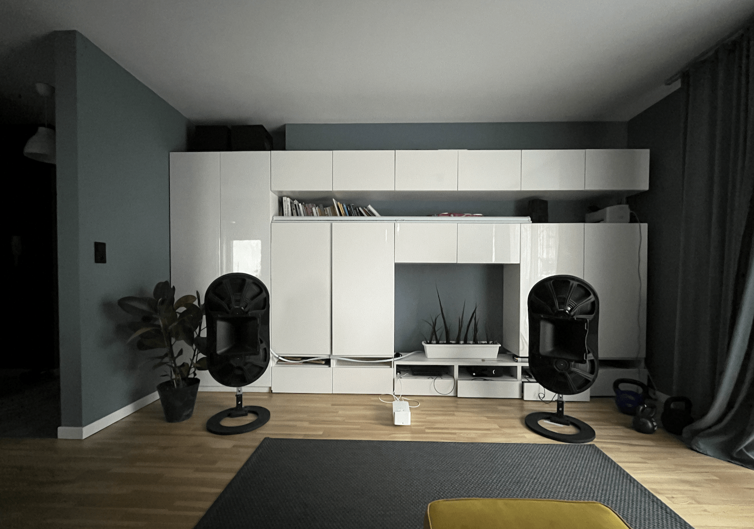

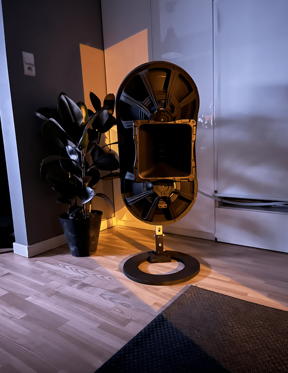

DIY, Faitals 18'' + RCF 940 in 950 horn, passive crossover + EQ, quite happy with them
so you have 4 18" drivers but still use a sub.... interesting.
the faitals are in open air space so they do not hit low do they ?
what are your xover numbers if you dont mind.
btw, your speakers mounts are DOPE!!
did you did some welding ?
They are usable without subwoofers with enough correction. In my room ~35 Hz, sounds fine. But I already had subs before building these speakers. And subs play in this room from 17hz (not a lot of headroom, but enough for me). And as I demonstrated above — speakers + subs made it possible to get pretty good bass. This combination sounds great to me.
Xower: ~650 dipoles/horns, and subs + speakers work together below 100 Hz, as I describe earlier.
Speakers mounts made from plywood, two metal "sticks" (some standard stuff from a hardware store) and bolted joints, no welding, all made in the kitchen and in my yard
Did you do any 180 phase swap? Cause the drivers are facing back (woofers)
Turning drivers (besides the visual design)) gives some additional low-pass filter. Besides, the polarity of all drivers must be adjusted with a microphone, as with any other speakers. E.g. if you want to get positive polarity with the driver reversed, you need to change the connection on the terminals to the opposite.
