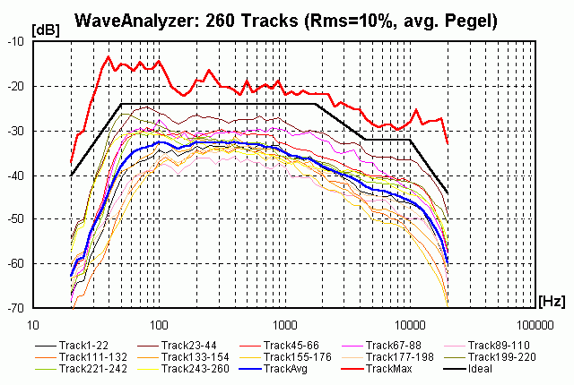

Here is a link where they did an analysis of a broad variety of music - just use a translator or have a look at the graphs: https://hifi-selbstbau.de/grundlage...6/81-musik-qvergleichenq-mit-dem-waveanalyzer
These are 260 tracks of test CDs - reverence listening material, also with good low frequency content.
In average there is VERY low content at 20Hz but also the PEAK VALUE shows way lower level at 20Hz. So there are songs with information at very low frequencies but it's 10-20dB lower as the main frequencies in songs.
And now you can search for songs and do FFTs to prove me wrong - there are for sure some songs out there which will not stay in this "borders" and I would love to hear them on my system

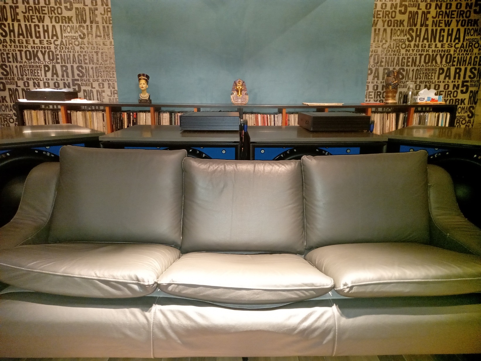

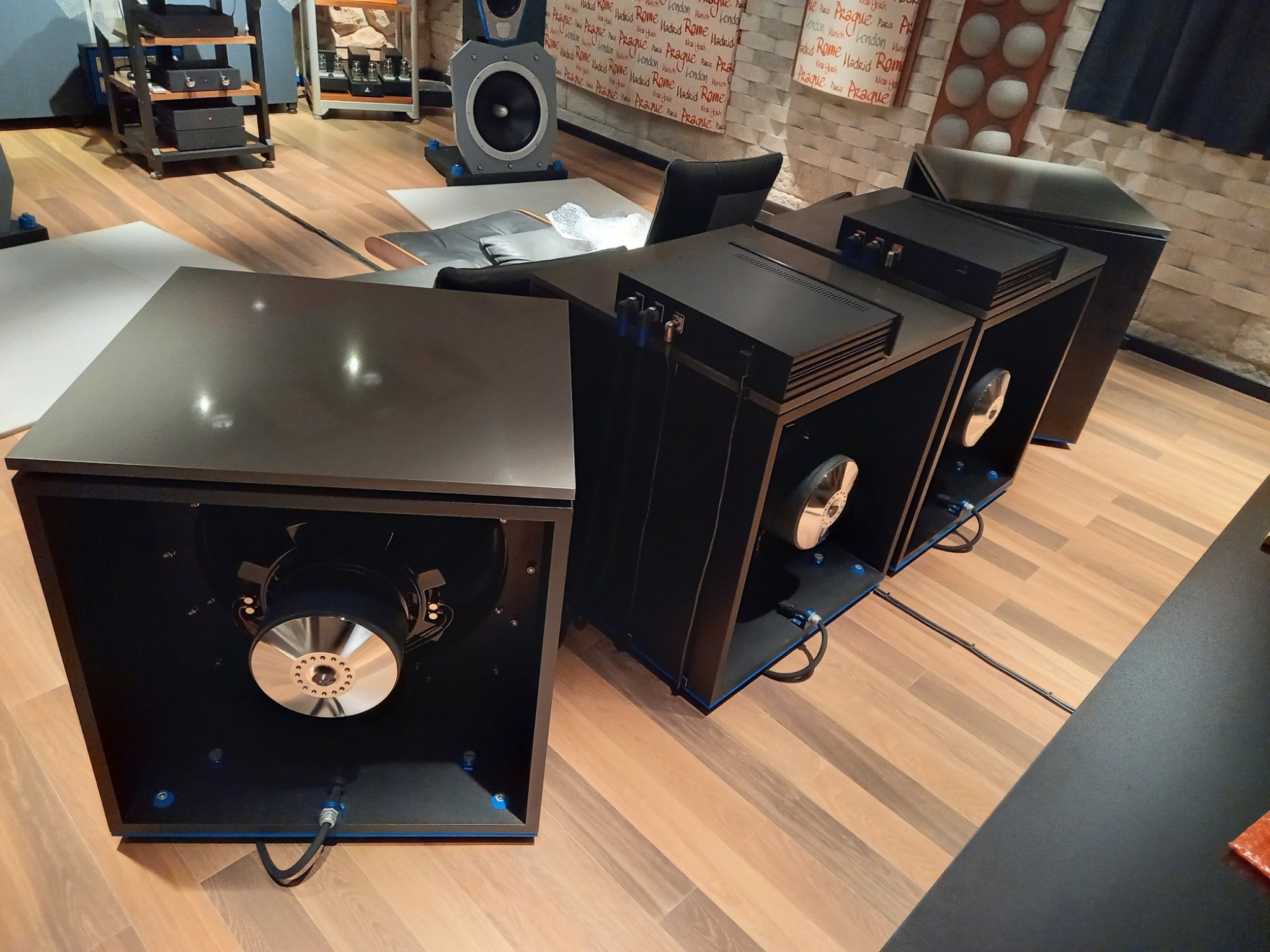

Rick,I saw a guy on the web talking about placing two subs very close to the listening seat, like one on each side, or two behind the seat. He said that this greatly reduces the effect of room reflections as you hear so much of the direct sound and the bass sound great. Has anyone tried this?
I tried my subs in several positions of the room and behind the chair gave, by far, the best bass quality. It is incorrect to block the back of your head with subs, furniture or even the back of your chair, in doing so, you compromise soundstage, even more when the room is treated and has diffusers installed in the back wall (as I did).
You do not needed for the near field bass to stay within a foot, one driver diameter will give good results. And IMO you still need to treat your room with bass traps. I have installed a total of 30m3 of those plus several Mondo Traps plus 7m2 of diaphragmatic bass traps.
Since you will listen to the monopole radiation of the subs you do not need to enclose the back wave of your drivers, leaving them dipole. I very much prefer the sound of open back subs and by a big margin, this is only a personal preference.
As I already shown in other thread, these are 4 x 24" SH24 subs, H-Frame, flat to 20Hz. Delayed 5.3mS to the mains w/DSP. This is a room for music only, zero interest in HT.
